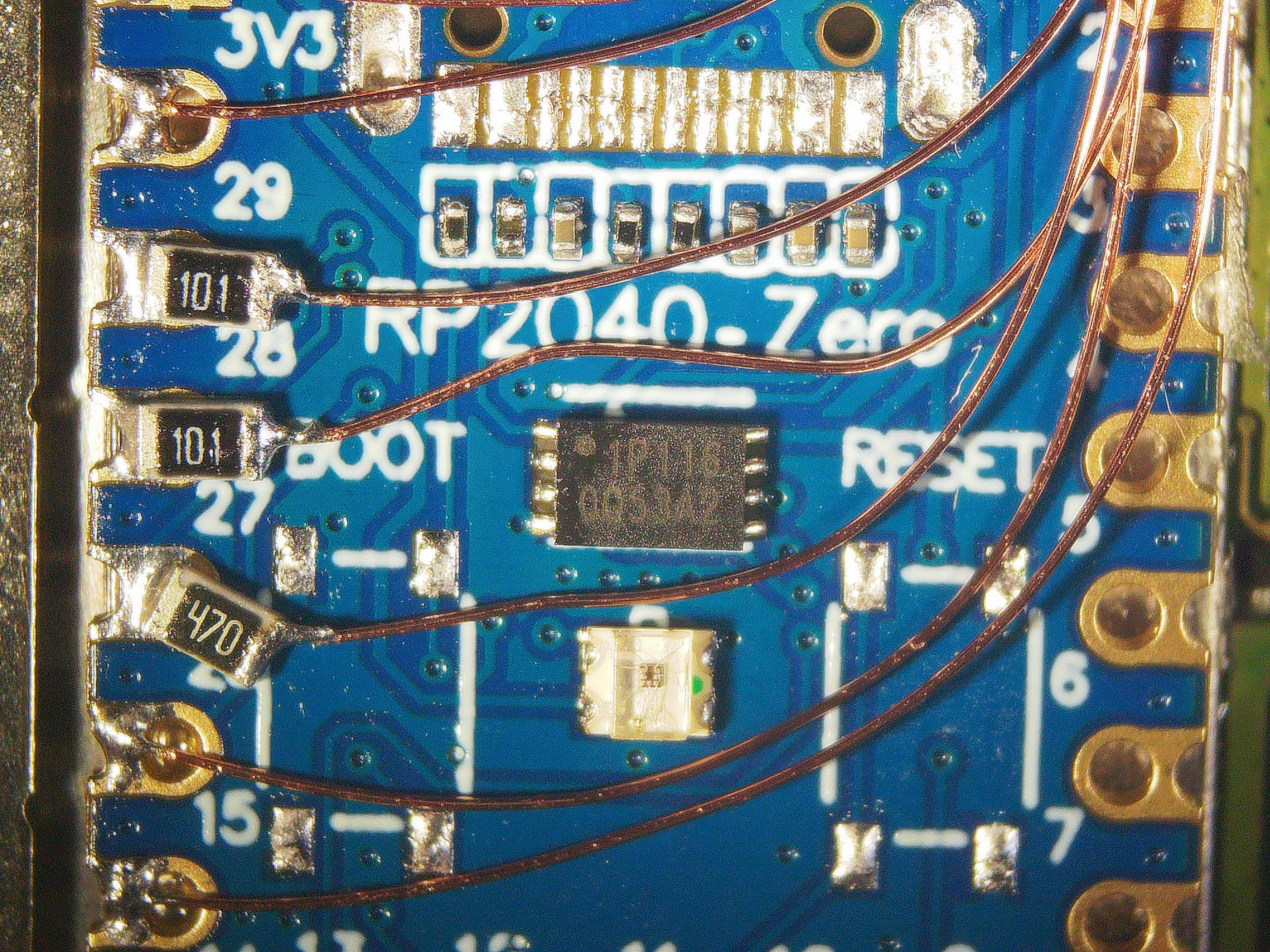

Okay so you’re right, I opened up my switch and it looks like there’s a lost connection to the RST and potentially D0. Should I ask my modded to re-do the whole thing? The way he attached the resistors look different from how everyone does it.
Installs like these are the reason people have trust issues with sending their systems to modders.
This person does not have "microsoldering experience". It looks like they don't even have any flux so maybe they have no soldering experience of any sort...
U paid money for that?.
I don't understand how people offer installing a mod chip and don't even try to make it look nice and take some pride of there work......
It doesn't really matter how much u paide.
If he had micro soldering experience then he has enough experience to know that this install is a peace of crap.
Bring it back and tell him to fix it while he is at it say u want him to get rid of that spaghetti ....
I suppose as long as it’s salvageable. Should I also ask him to put the resistors flat on the board instead of it hanging out like that?
So things wrong with this install I should ask to fix:
- Long wires
- Flux on the points
- Kapton tape underneath the resistors?

If he mounts the resistors so they point inwards to the board instead, it wouldn't be needed. These look a bit larger than the regular 0805 that most people use though, so I'm not sure if they fit like that.

Listen to me if you really want to fix your console, just listen to me!
Even though you gave money to that "technician" dont go back to him. Simply he cant do the job. He is just not capable to do the job for two main reaspons, technicaly capable perspective and attentively perspective. There is a big diffence between "i see a small problem at this installation" and "i see everything wrong at this installation". There is not even one "real" soldering technicial on earth that whould solder the resistors like that....

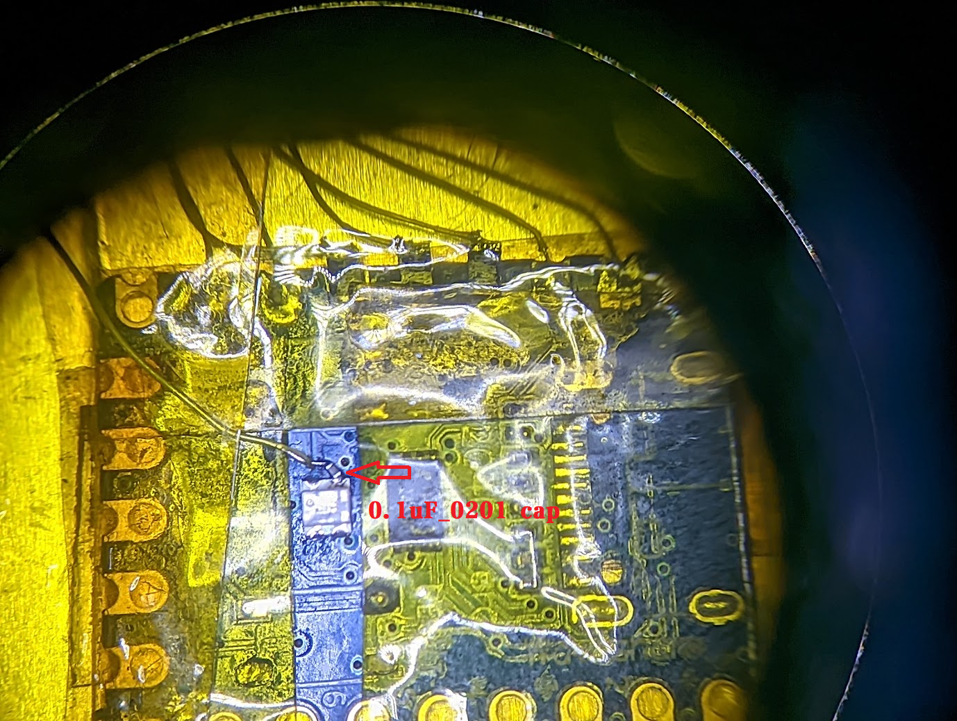

@vulp_vibes I think I come up with the idea to fix joycon issue with the JRST signal mod.
I initially added 47ohm resistor on DI to see if any change, it did make non-LED mod joycon intermittently recognize when in handheld. So I went with 1k ohm, still not much difference on NON-LED mod JC. On the other hand, LED-MOD JC wont recognize in handheld mode or even wireless mode(didn't try manual rest). It will only recognize when JRST wire remove.
At this point I'm pretty sure is the JRST wire having interference when connect to rp2040 LED DI point. I suddenly came up an idea using capacitor to carry the DI signal through JRST, since it's analog signal the capacitor would also stop DC interference, just like HDMI circuit does around other console. And BANG-ON, 0.1uf 0201 CAP I normally use on PS5 HDMI port PIN18 did the trick! :rofl:
Short story version: ADD 0.1uF cap between DI and JRST/pin6!!!
I've tested it, glitching LED light signal works and handheld connection no issue so far, Let me know if your side have same result.
--Small update: if you have experiencing right JC handheld works(with 0.1uF cap on DI) but dis-attached wireless mode couldn't find JC, try go into setting: Controllers & sensors--->disconnect controller, press X to disconnect all controller then re-attach LED-mod JC into the rail, this should fix the bug. I had this happened after I added 0.1uF cap in CFW, but OFW works.
