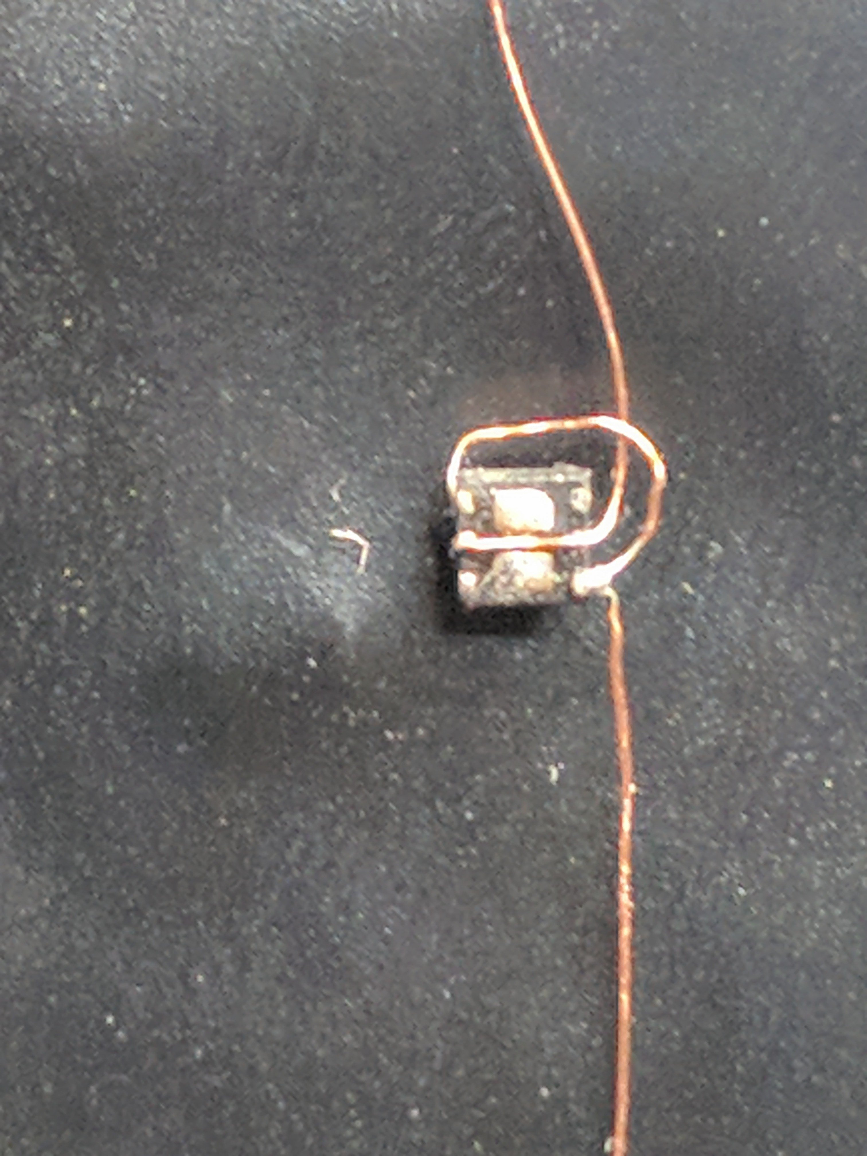

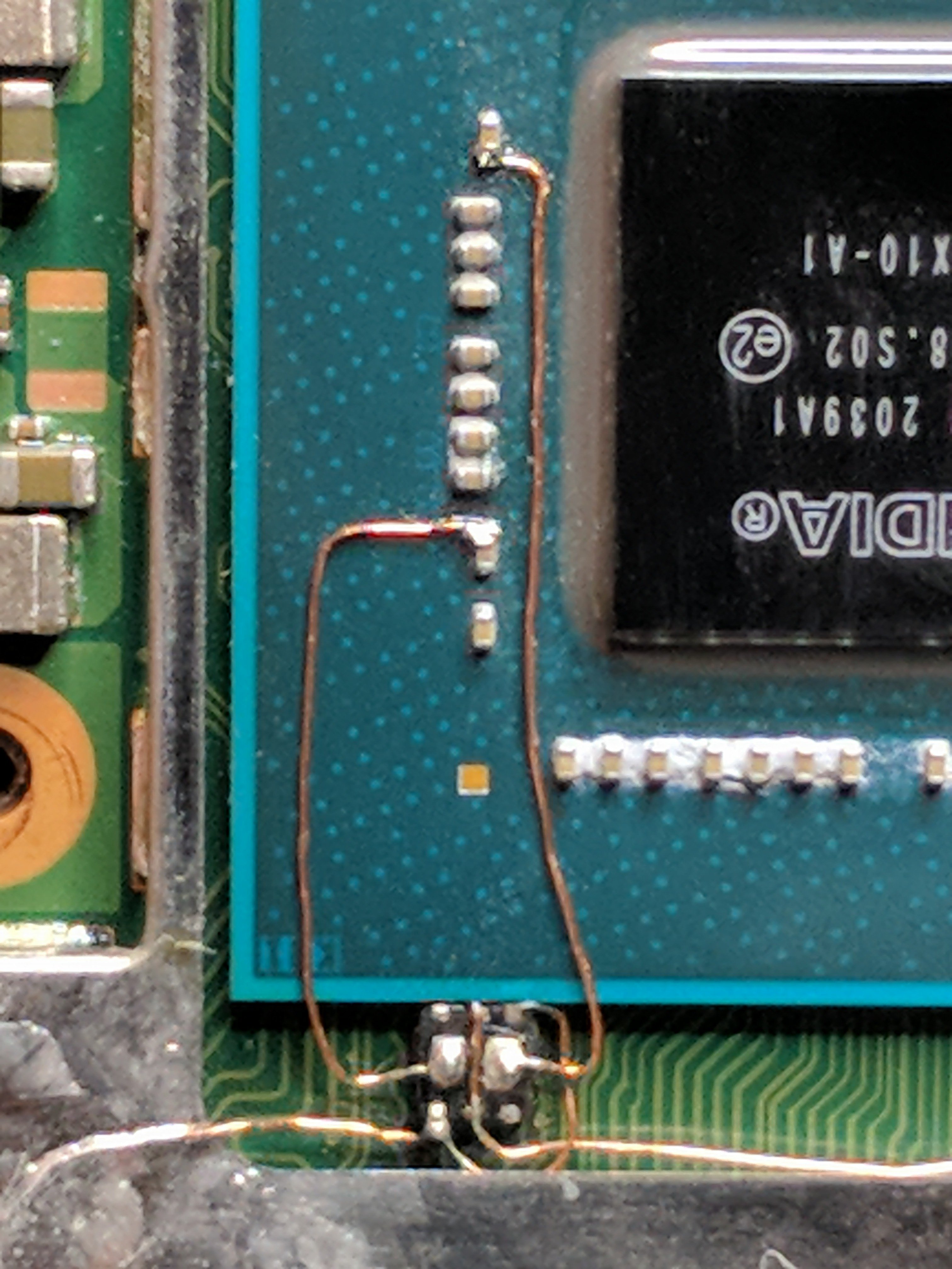

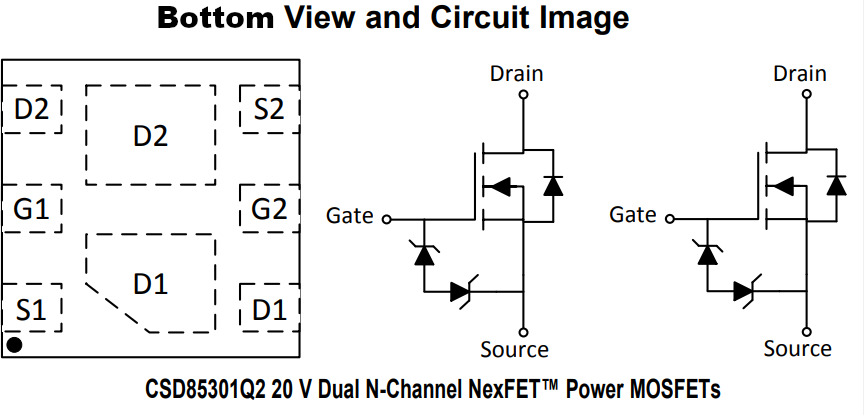

I will say, this dual mosfet install was after a failed install of a CSD85301Q2 package, which is supposed to be a dual-mosfet setup in one single package. I'm pretty sure it was just my own failure at soldering it, but it failed in pretty spectacular fashion (the 36awg wire I'm using burned itself in two in multiple places).
Thus I went back to the dual MOSFET setup that I am used to (as seen in the photo) and there have been no issues.

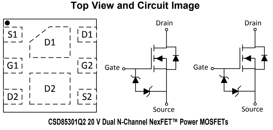

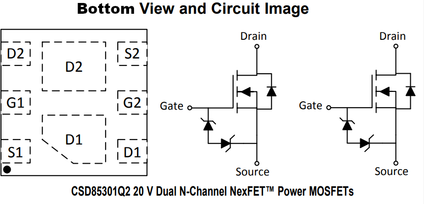

Just a further update on the CSD85301Q2 package. I am a bonehead and didn't do my diligence when looking at the diagram to take note of the fact that it states clearly "TOP VIEW AND CIRCUIT IMAGE". I wired it in 'deadbug' format, which mirrors that schematic vertically, which had me reversing the Drain and Source wires, which explains my burning wires. I feel more confident now that I could wire one properly, and likely will on my next Picofly install.
For posterity, here are the original diagram, and a modified "flipped" one by me. Top is the original, Bottom is the modified one for deadbug orientation.
In hindsight, this is now CLEARLY backwards, because you can see the shape of the D1 pad in the incorrect orientation relative to the top schematic.
This wiring caused several wires to burn clean in two, luckily it was only 36awg, so the wire sacrificed itself and nothing else seems to have been harmed. DO NOT WIRE THIS WAY, I will post correct photos once I wire one in successfully.

Here is a mocked up edit in GIMP of the correction needed to make the wiring correct. Just wire the big pads to each individual cap on the APU and it should work.

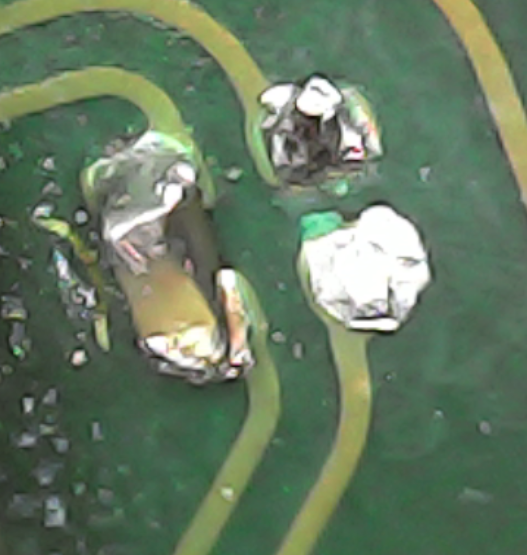

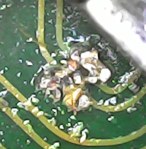

So the switch is mostly working again now! CFW (emummc) works, OFW (sysnand) works.
I'm having some radio troubles though
* WiFi does not work
* Bluetooth does work
I've done some searching and examination of the board and identified this issue, which I'm assuming is the culprit.
It appears the outer capacitor (?) was completely destroyed. I cleaned things up somewhat, but need to replace the component. Can someone please tell me what it is exactly?
What size as well, I'm thinking 0201, but maybe not?
Thanks in advance :)

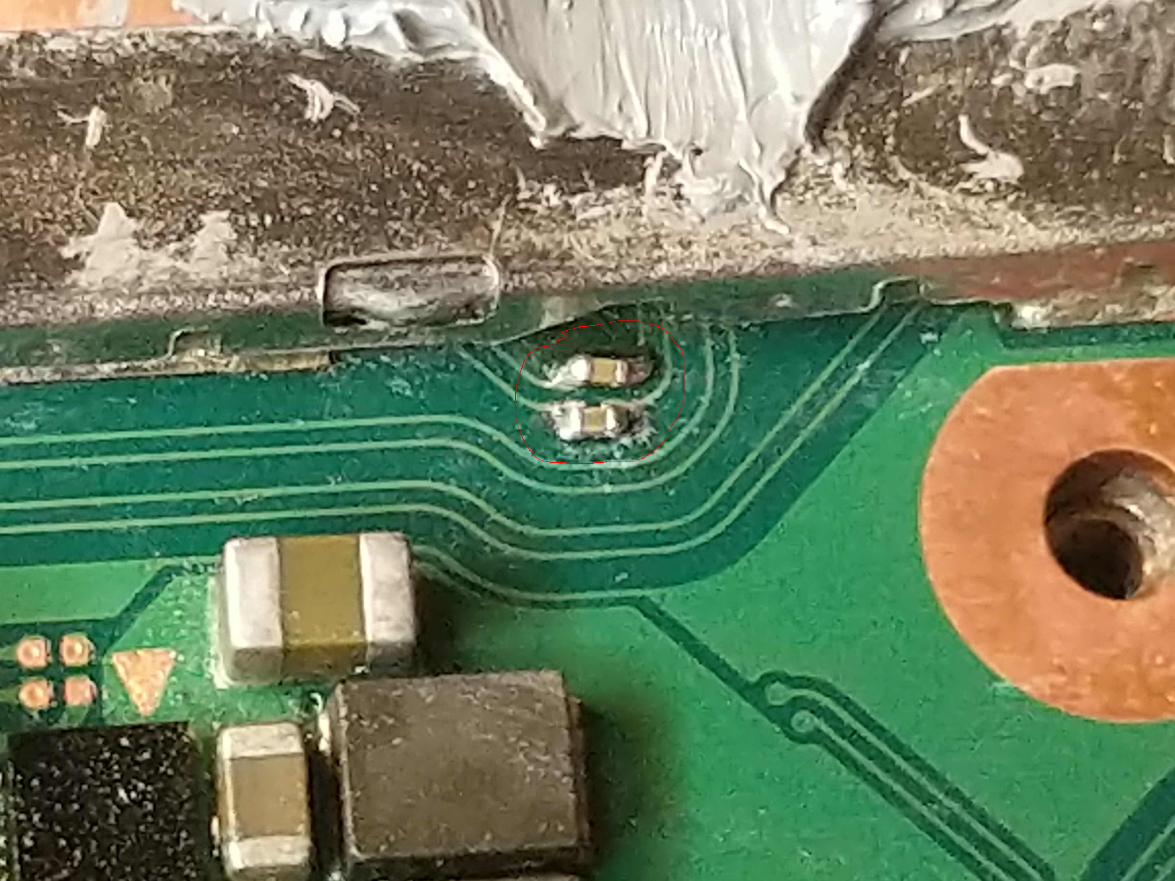

Can confirm, these are 0201 100nf capacitors. You may be able to get away with just bridging that pad, but I personally replaced both of mine after I swiped my own off my original switch install.

Did you have wifi issues as a result? or did you fix them before closing up and testing?
I'm wondering if there is anything else I need to look for.
These two lines cause wifi and bluetooth issues respectively. After replacing both capacitors, both wifi and bluetooth function were restored.

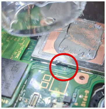

Is it true that rp2040 Tiny (not zero) has already resistors on board. There also seems to be experiments avoiding to open cpu covers and remove thermal paste?
Yes resistor are there, but you need to measure to make sure.
It should be 47ohms, in CMD, CLK, DAT0 pin.

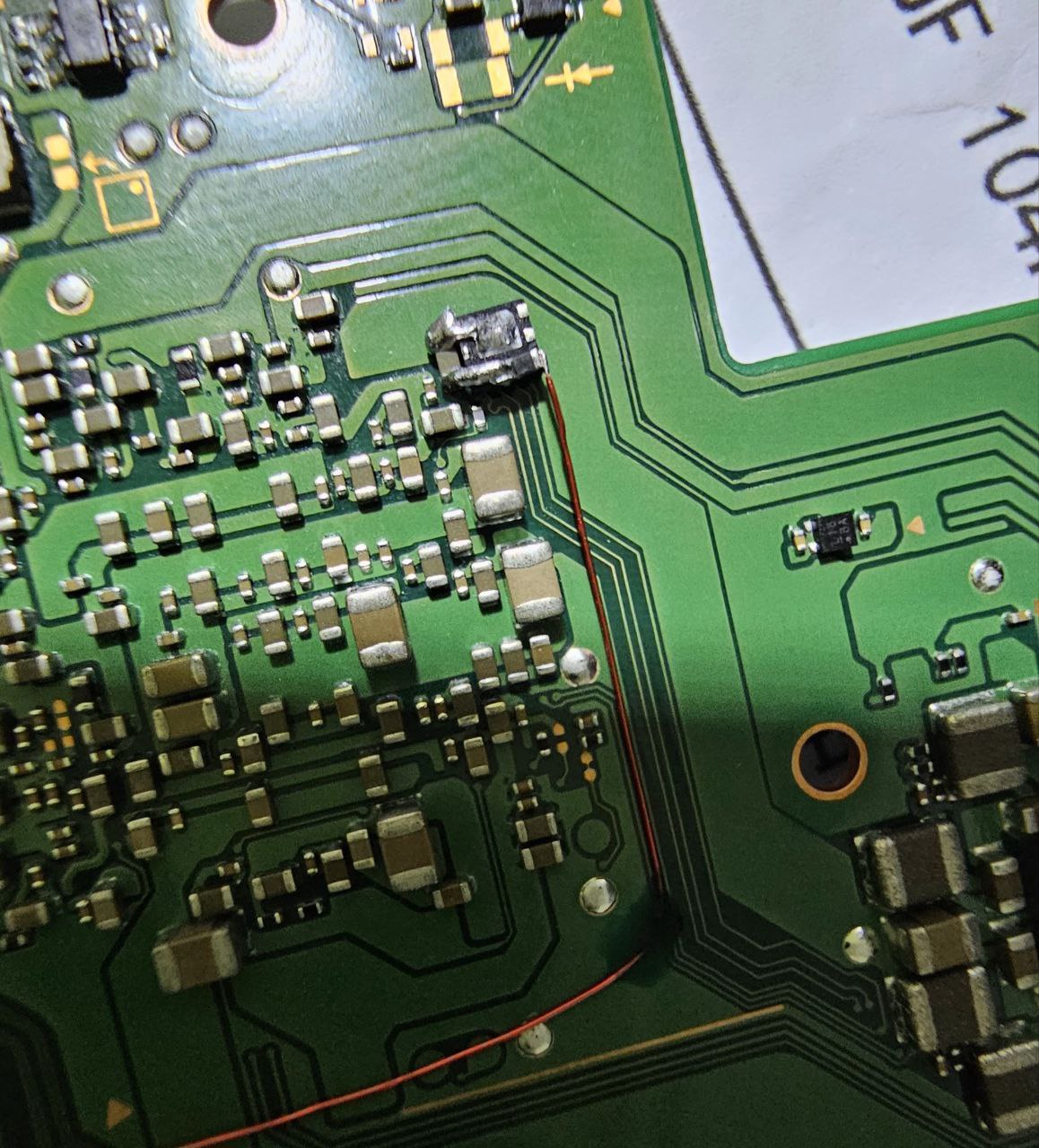

You could installing mosfet directly on the back of the pcb. Its easier since the cap you will soldered is bigger compared to the usual cpu's cap.

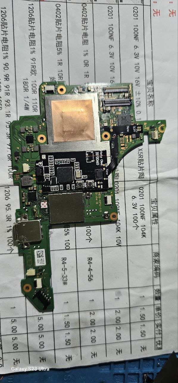

Single Mosfet IRFHS8342 & NP2016 work fine on OLED & V2 Switch without SDA/SCL points

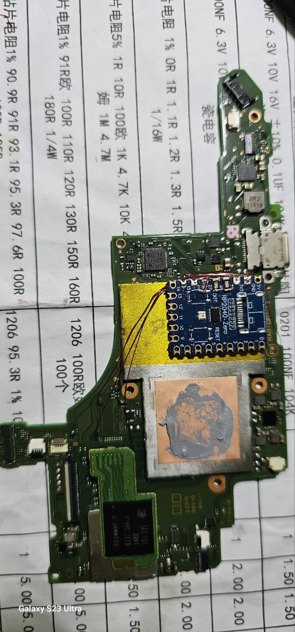

Yes it does,47 ohm, i just install it yesterday. Can you repost the schema for your version that dont need open cpu cover. Previous pic is quite hard to follow

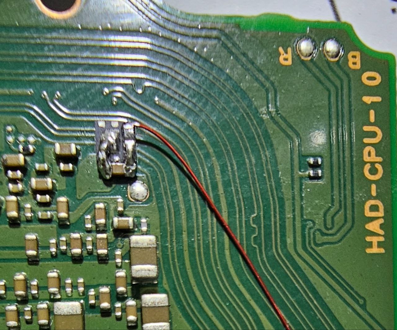

About the led, i think that using pin in the rail is easier than the main board. Another idea like add another pin for the joycon led is also practical. Of course some modification in fw is needed to output led signal to another pin. The idea about speaker also interesting
