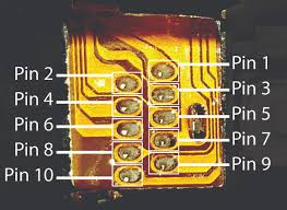

The pico was operating as expected. 3.3v power was still good. The last I saw it doing was injecting with the white LED and then nothing would happen because the APU wasn't able to boot (I'd get a 'unable to glitch' error code, I think *** or ---. A short across the OLED connector sounds viable, two of the pins were crossed across another bunch of the pins. Not sure if this can damage the power IC but maybe someone does know.
good to know this, could be useful someday, but for now I afraid of bridging pin more than open apu shield, in the pic of oled, the cap is quite close to other component. Pretty sure this kind of installation never appear elsewhere. So if you want to make a video about that. It is ok, but be aware of the risk it could bring.
