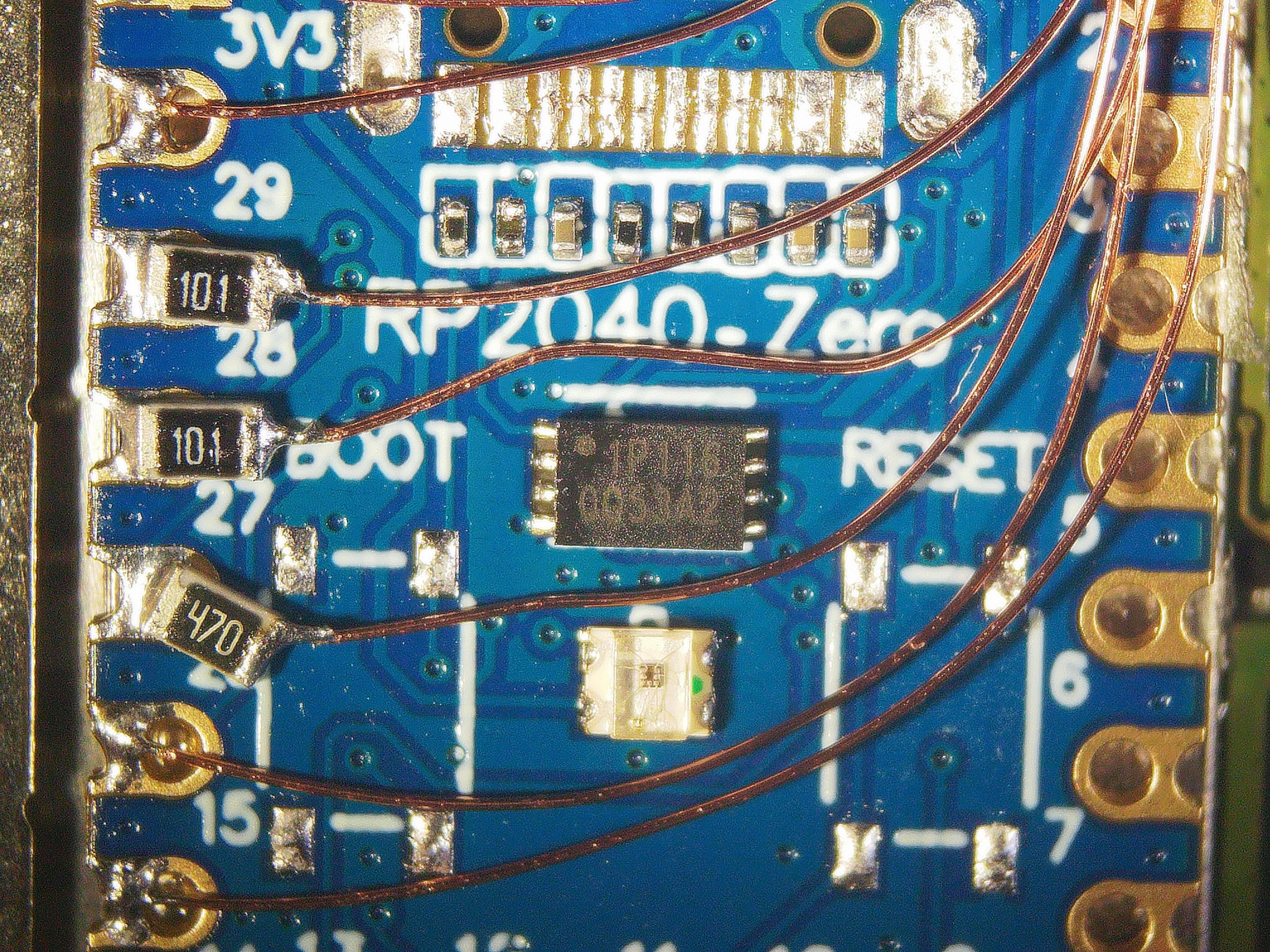

i'm doing all my installs with 100 ohm resistors for dat0/cmd and 47 ohm for clk. haven't had any ofw problems with any switch yet.
I recently got my 1st slow emmc and it's a SUPER bummer to basically finish the Switch and then go back and change\add resistors. Your posts about ONLY using 100\100\47 resistor sets are one of the few remaining reasons I continue to read the PFly threads.
I will now be doing all my installs the same way.
As the dat0 is only for OLED, do you use the 100 ohm resistor for the v1, v2 and lite as well?
Apologies, yes, I didn't add the word adapter for the dat0.
So, my even with out a dat0 adapter its advised to use 100 ohm resistor?
The adaptor it's just for soldering things, so yes, you need the resistor or design an adaptor that includes it.
Yes, resistors need to be added on all installations. And after a few months and alot of people doing this mod it seems that it is better to use 100ohm on dat0 and cmd and leave the same 47ohm on clk.
I used 47 on all 3 point in all my installations and I only needed to add second 47ohm (94ohm in total) to dat0 once in an upatched V1.
But I will use 100ohm in any future installs just to see what happens.
I used 47 on all 3 point in all my installations and I only needed to add second 47ohm (92ohm in total) to dat0 once in an upatched V1.
LOL... I know the resistors need to be used on the install. I was asking, as you chimed in to my quoted question to another member, regarding using the 100 ohm on the dat0 and CLK. My question was specifically for the OLED because its a little different and requires the dat0 adapter. But, it seems like you answered my question -- I'll be using 100 ohm resistors for the dat0 and CLK and the 47 ohm other connections requiring a resistor on any version I mod.
