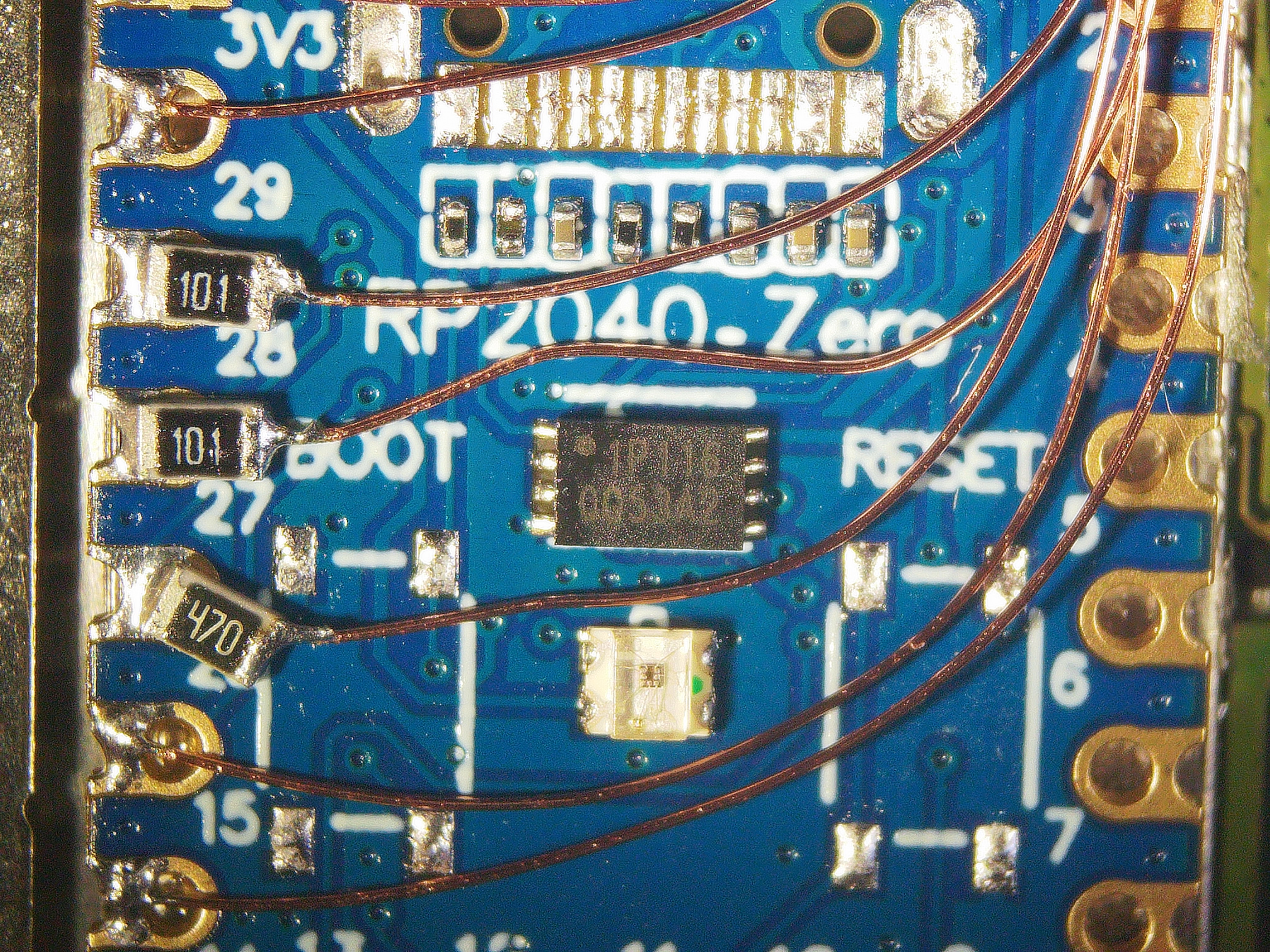

i'm doing all my installs with 100 ohm resistors for dat0/cmd and 47 ohm for clk. haven't had any ofw problems with any switch yet.

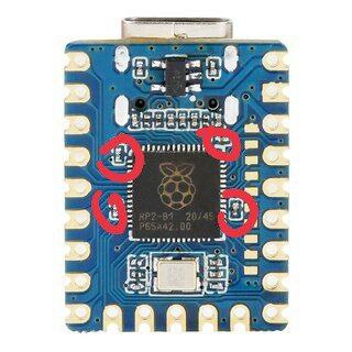

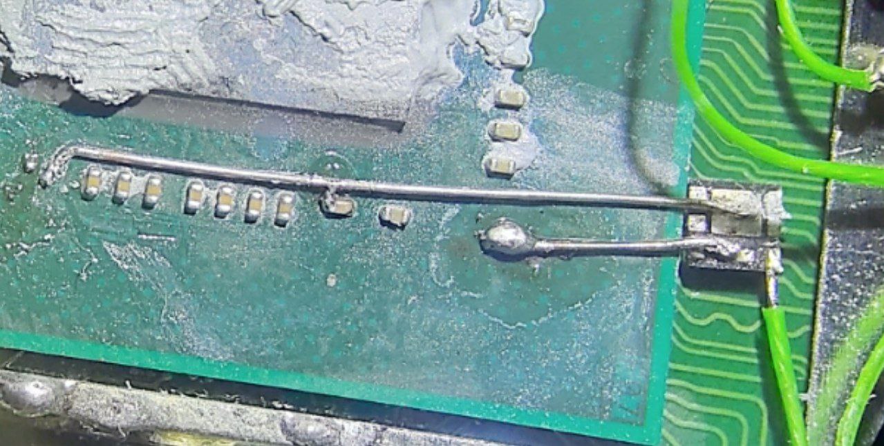

I would suggest to add a few moments:
- RST point is extremely sensitive. Even a tiny amount of flux may cause problems like instant reboot after startup, so it is highly recommended to clean the board after soldering
- "Slow eMMC mode" as Hekate says, may also be caused by flux, too thin, or too long eMMC wires (CLK, CMD, D0). In some cases double resistors (47+47 = 94 Ohm) on the CMD & D0 lines may help.
- A diagram with single mosfet which is properly connected to both VCC points should be pretty enough, the 0.2mm diameter enameled wire is recommended.
I know for sure this soldering sucks, the capacitor is lost, but you can do better!
- the APU soldering is complicated, and some people may break, or lose capacitors there, in this case, it is possible to replace them with the ones from the pico board!
actually there are more 100nF caps, but I'm too lazy to ensure which are the required ones

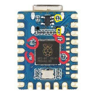

Hi!
I accidentally removed and lost these two caps right now on a zero. (i marked it with yellow.)
what cap is these two?
i need to replace them or i can just leave it be and gonna work like this?
