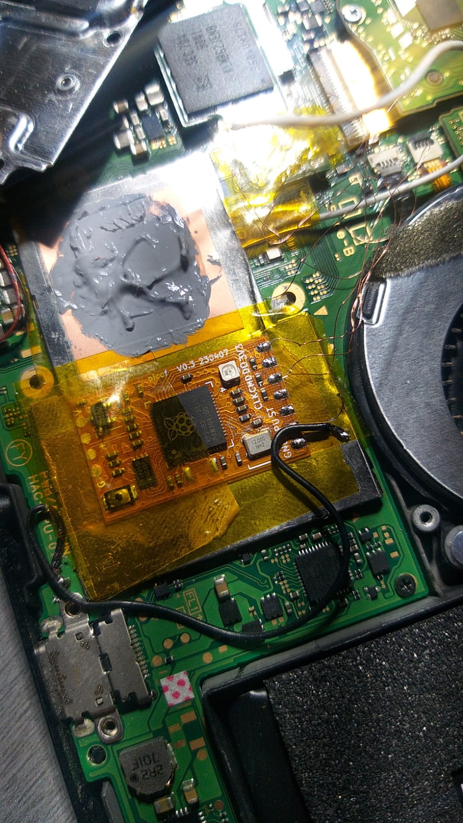

if no bridge, switch not working without the chip ?
Point 1 and 2 on this picture need to be connected together. Point 1 goes to emmc and point 2 goes through the pcb board to the APU I think. If these 2 points are not connected together the Switch will not works (with or without chip, it does not matter).
You need to fix this first, see of the switch is working, then decide if you want to install the pikofly or not.

No bridge NO work
You need to fix this first, see of the switch is workin, then decide if you want to install the pikofly or not.
no work on official, i must fix this f... trick ..... sorry :(

I breack my dat0 point, there is an alternative ? 😔
first of all u need to fix that bridge point otherwise u wont get ur switch runing at all.
then u can search for a alternative point
not gonna work at all since u need that dat0 point

Simply add another resistor on the cmd and/or dat0 into around 100ohms.
Usually people add another 47ohms to existing 47ohms.
I once meet that on v2, and simply add resistor on cmd fixed it.
Reactions: aleciobr and QuiTim
