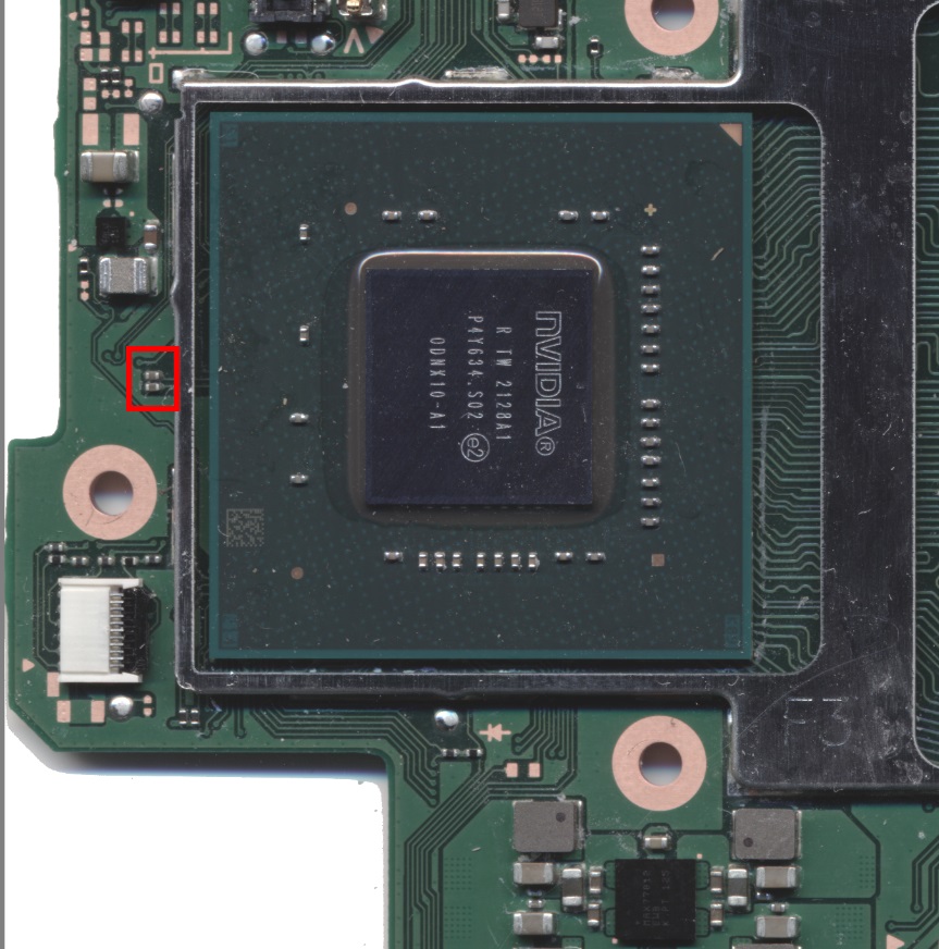

Proof Of Concept (POC)
This is DANGEROUS, still in a initial state. Don't replicate this experiment, without understanding the risk.
Glitching without soldering mosfet to the SoC nvidia but to the VDD_1V lines from the PMIC Max77620
I use a broken lcd V1 board, as experimentation.
Here is the IRFHS8342 soldered to the cap.
And here is the multiple time trial of glitching (power on and off).
The glitching is very fast, almost instantly.
very cool! eristas usually glitch really fast though, I would love to see this tested on a Mariko for comparison.
I can see this becoming the method of choice especially for oleds since you have to remove the motherboard anyway. On lite/v1/v2 removing the motherboard will be an additional inconvenience. Maybe better than removing apu shield and cleaning thermal paste, though?
Reactions: Takezo-San
Great, is there any space left between board and lcd? so we can reassemble this back safely?
You need to unscrew 3 point on heatsink just to be able to flip the mainboard... so one way or another its better to also replace the soc paste.
But to also consider is if somehow the mosfet get short and heat up its acctually better to have it installed on top side of soc rather than back of it, as it near lcd board which surely sensitive to heat damage.
Reactions: aleciobr
