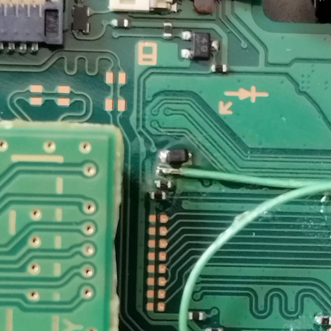

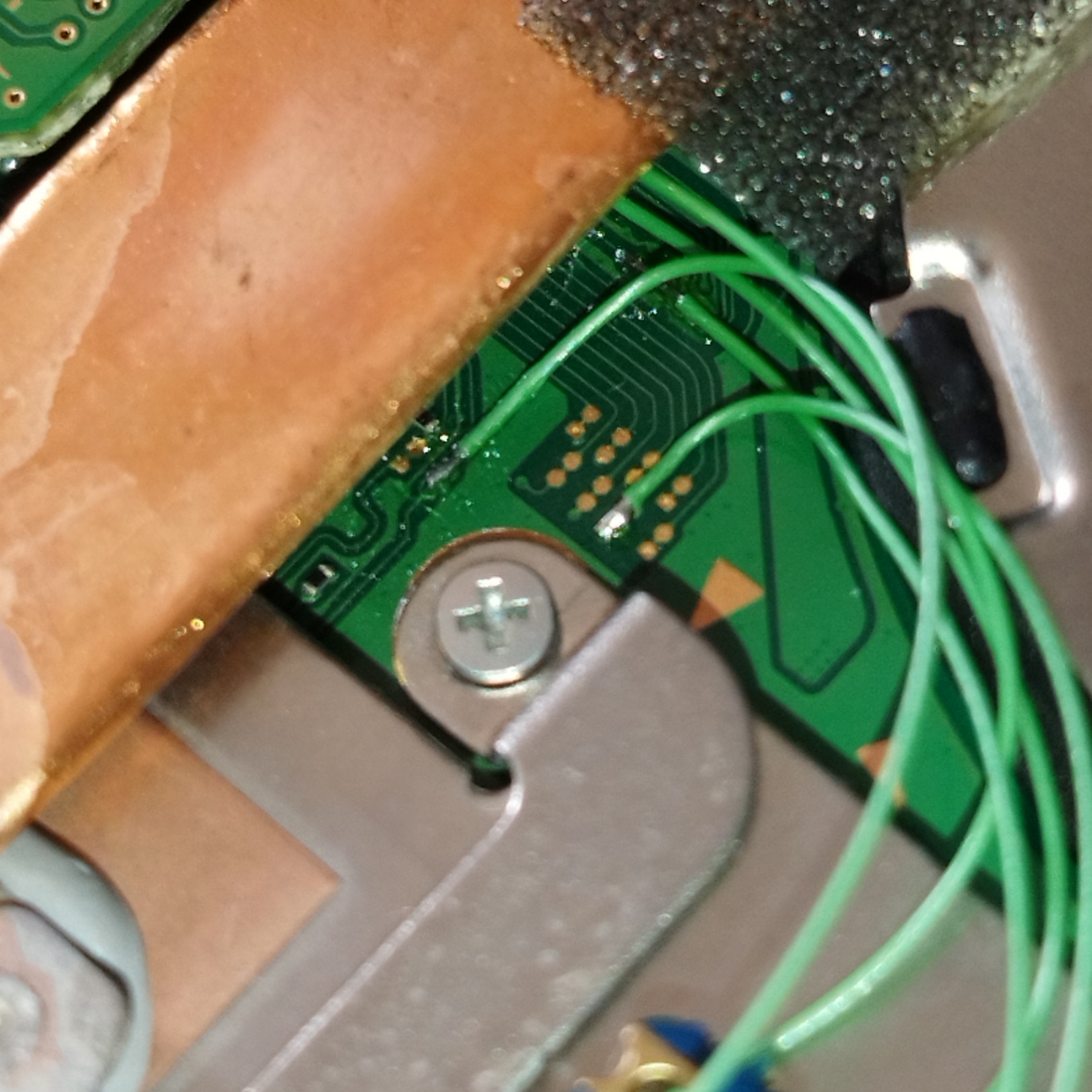

For those who have bought this rp2040 chip variant and have slow emmc errors or black screen to ofw, cut these two traces that lead to cmd A point and dat0 C point and add two more 0201 47 ohm resistors. This was the only chip i had left with to mod a v2 console which is an oled model chip so i had to do some cuts.

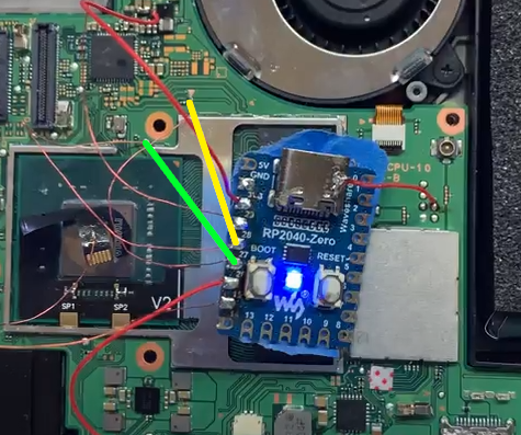

Your CMD and CLK wires are reversed when wired to the rp2040 in your first vid.View attachment 380496
In other words, it's a wiring problem.
thank you friend for opening my eyes But what a fool that I do? when you have shit in your eyes, it's a crazy thing. 1000 times thank you a real novice😅
And when we are fixed on an idea, 🤨 we stick our noses in our shit, we see nothing 🤪
and as usual, it is. Since you've mixed up cmd/clk
Merci 🙏👍
There's really 💩 in the eyes

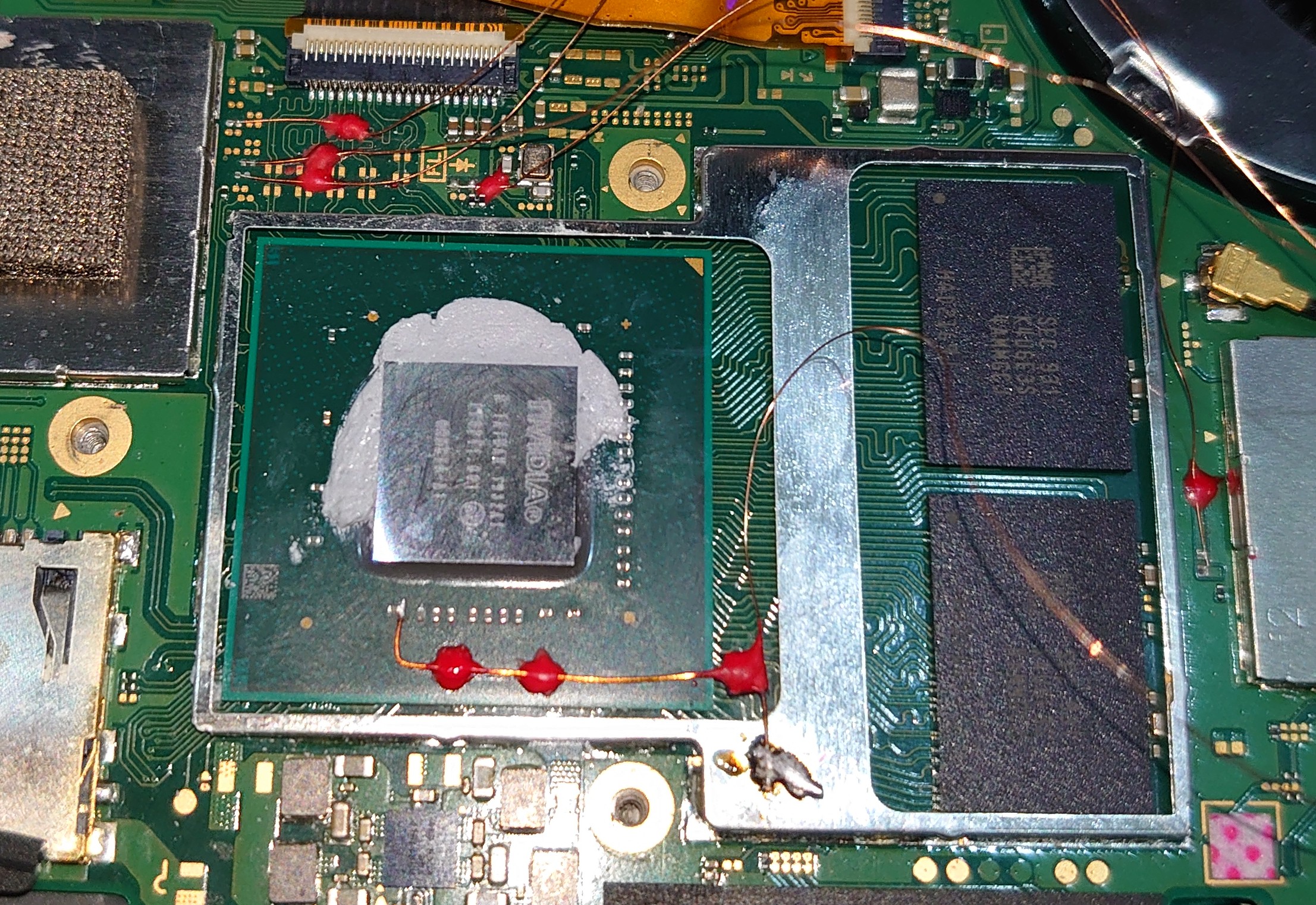

Hi, I have the same error code ( " *=* No eMMC block 0 read (eMMC init failure?)" ) with several OLEDs! I thought it was my wiring, the picofly (2.74) and the mosft cable that was messed up. I soldered a HWFly v5 core the console starts without problem?
I have to tell you, I only boot on the original fw with the pico installed
You can try to add I2C PIN

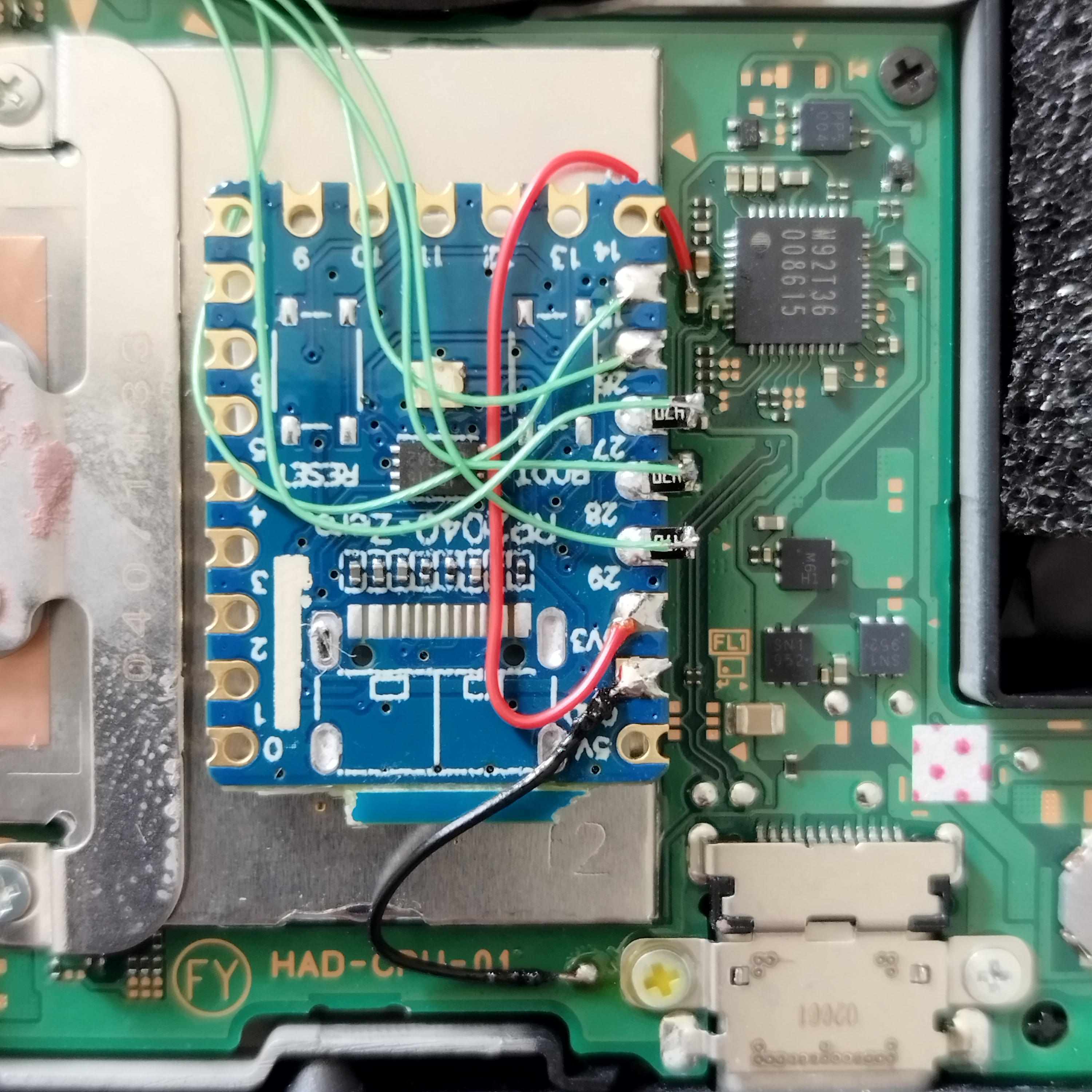

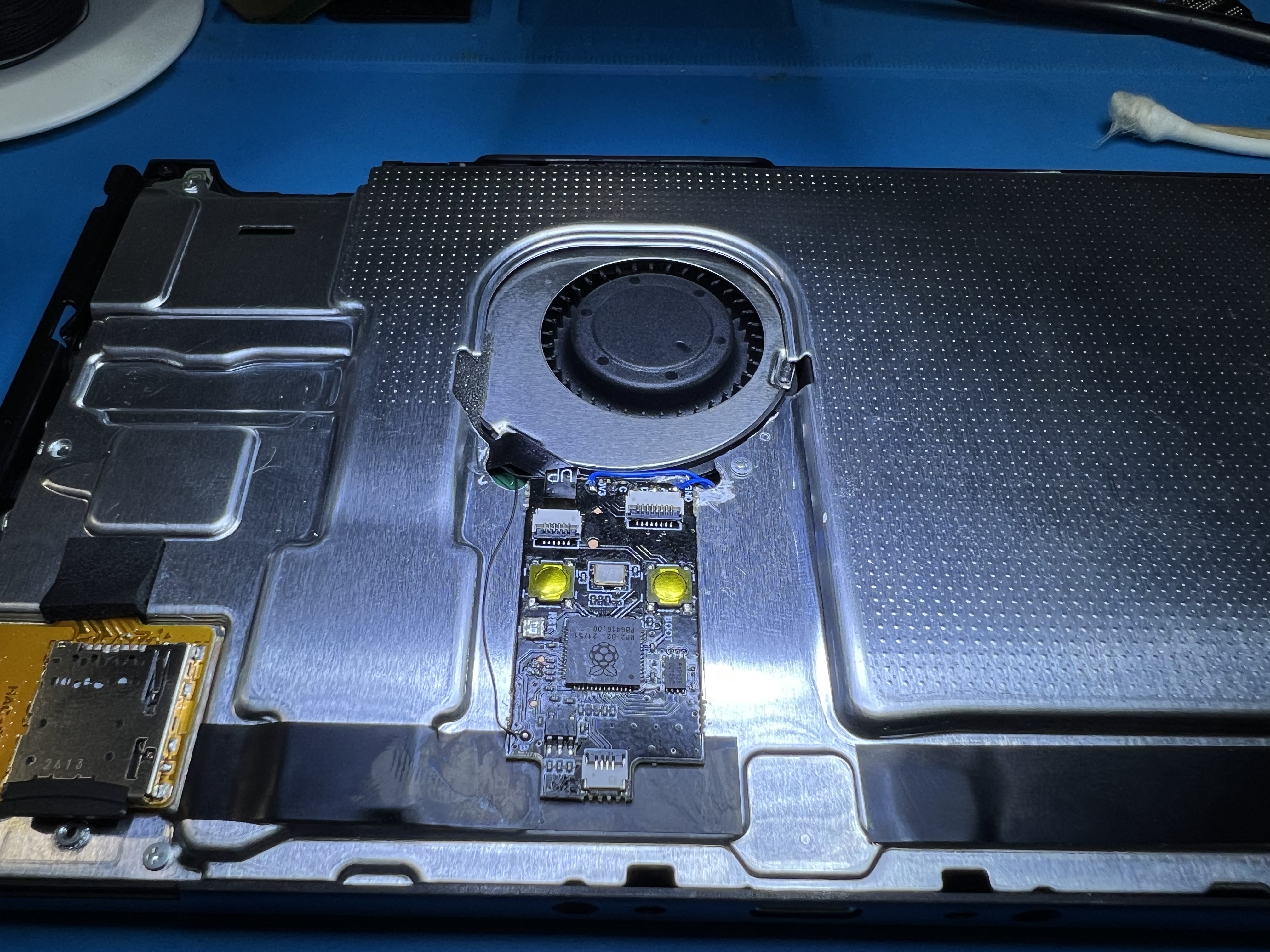

Hey guys !
I put an RP2040-zero on a switch V2 and it boots on OFW with a led code: Long green, short green, short green
I checked my welds, they are all good. Does anyone have any idea what I can check or change?
Thank you so much !
