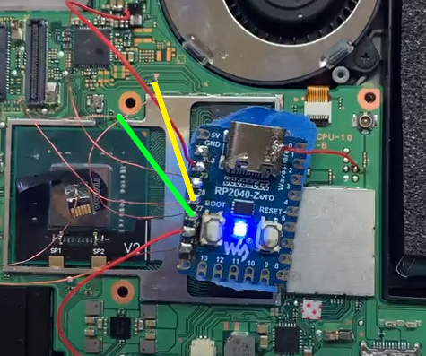

Hi, I have the same error code ( " *=* No eMMC block 0 read (eMMC init failure?)" ) with several OLEDs! I thought it was my wiring, the picofly (2.74) and the mosft cable that was messed up. I soldered a HWFly v5 core the console starts without problem?
I have to tell you, I only boot on the original fw with the pico installed
Try 2.73
Edit:Well forget just saw u tried it Xd
I flashed in 2.73 I did the wiring 3 times and still the same problem.
Are there any resistors on the Dat0/clk/cmd?. On video I can't tell if there is any.
The two points below the Rst circled. Is these points are also RST points?
Edit: They are connected
Confirmed by using http://balika011.hu/switch/lite/.

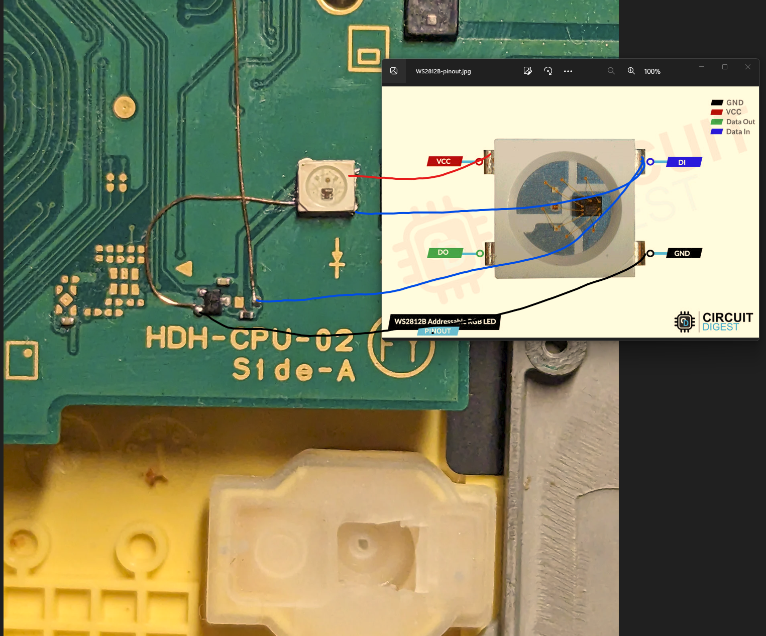

hey how would you go about doing this with that rgb led on the RP2040 zero/tiny

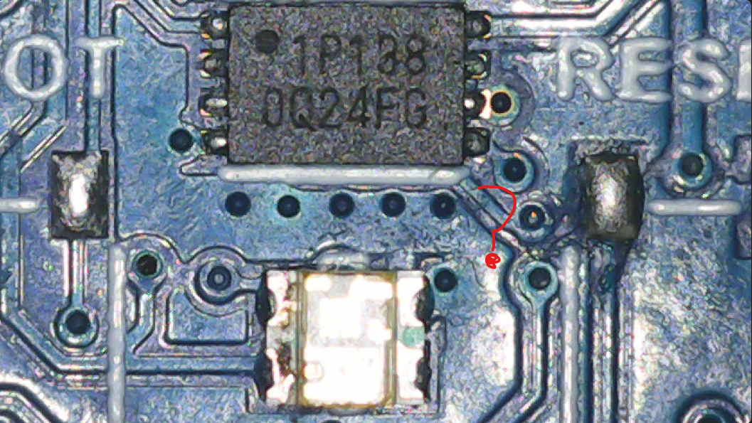

that pinout should be correct; they appear to be using the same LED. also, I will likely be doing another install soon as I repaired a second lite board yesterday, so I will see if I can figure out a method that leaves the original home button LED intact.
thanks friend, just wanted to fix the switc version, it's an OLED not a lite.
to answer your question I have the resistors, 47ohm on the D0, clk and on the cmd.
on the rp2040 zero they are behind the rp2040 zero solder on the pcb.
on rp2040 timy I replaced the resistors.
after I did a test with the same wiring with HWFly does it work? For me it's not a wiring problem!
this is the RGB led that is on the zero/tiny I'm unable to find the pinout for it
