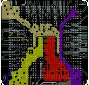

The TDP of the cpu is around 10Watt. So for 1.8V it will be use something like 5Amps maxed.
So the design of the pcb must make sure the power line could handle 10 watt of electricity goes to the cpu. The area and the thickness play a role part in the design.
The trace of power line usually different. Its bigger than the data line. If you know the trace, please direct me the position.
To add to this, power is often distributed on planes rather than individual traces and the TDP is spread across different voltages. This is the picture I found doing a quick search on the Tegra X1 and it is probably the reference platform layout. One more thing... the average TDP of the 210 used in the Switch is 10W but it can peak at 15W. Link.

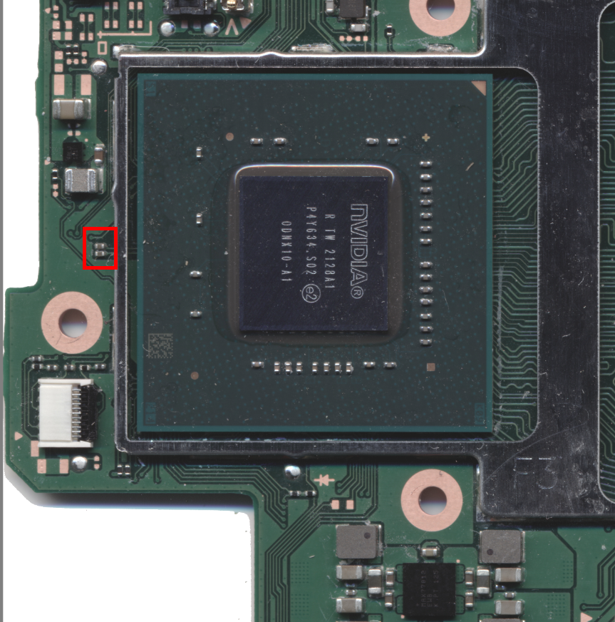

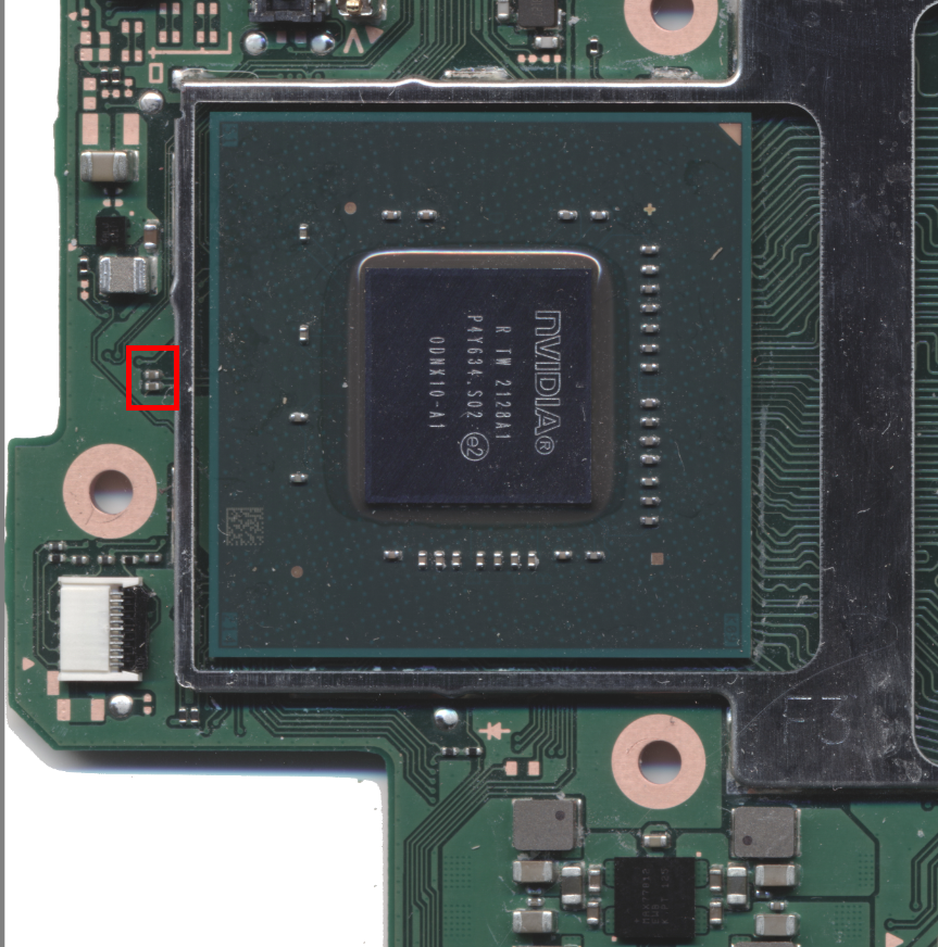

Greetings, after many installations I have a problem with bluetooth and wifi, the joycons and the internet don't connect, the same thing happens with or without picofly, I changed the wifi module and it's still the same, any idea what's wrong? It's a nintendo Oled

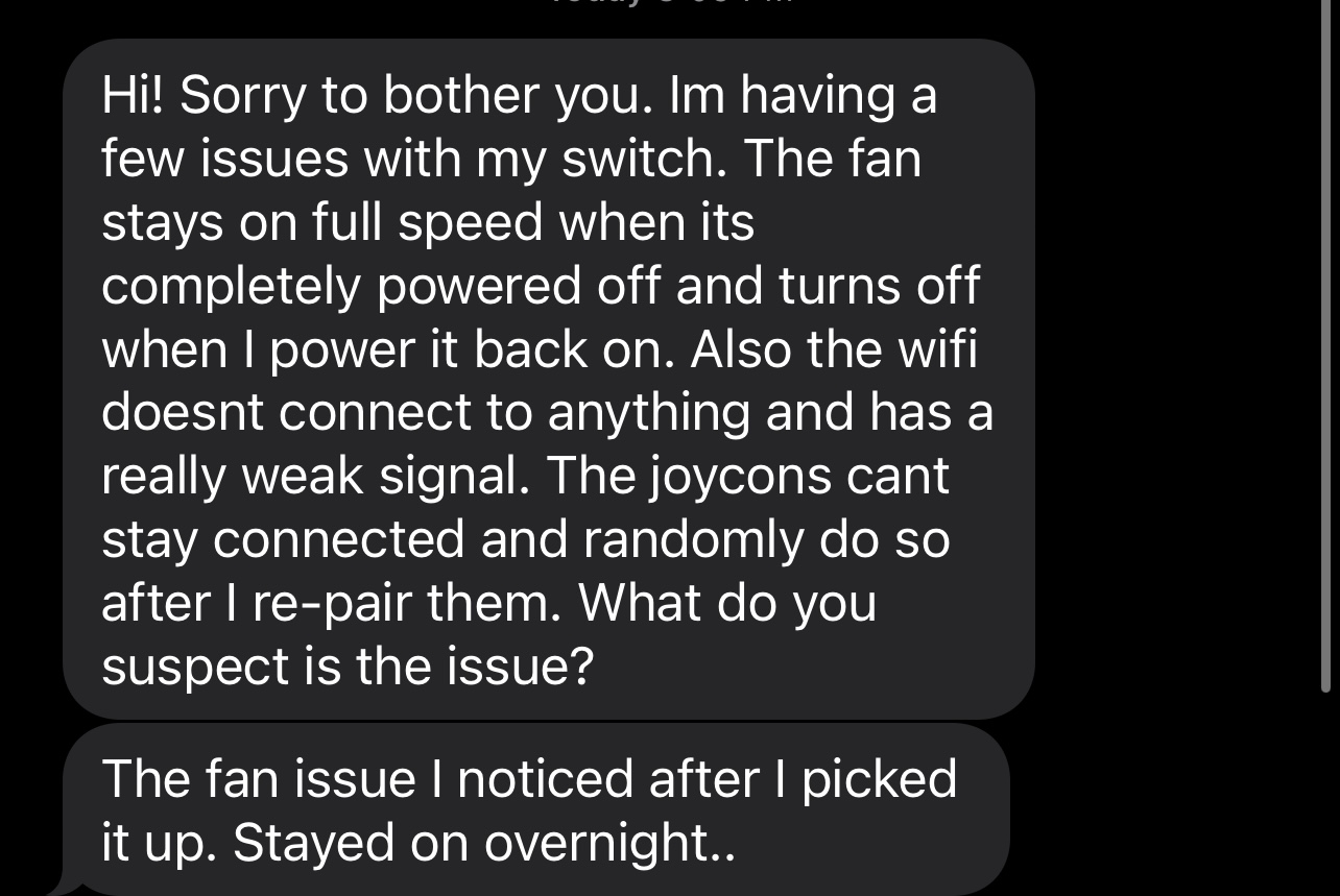

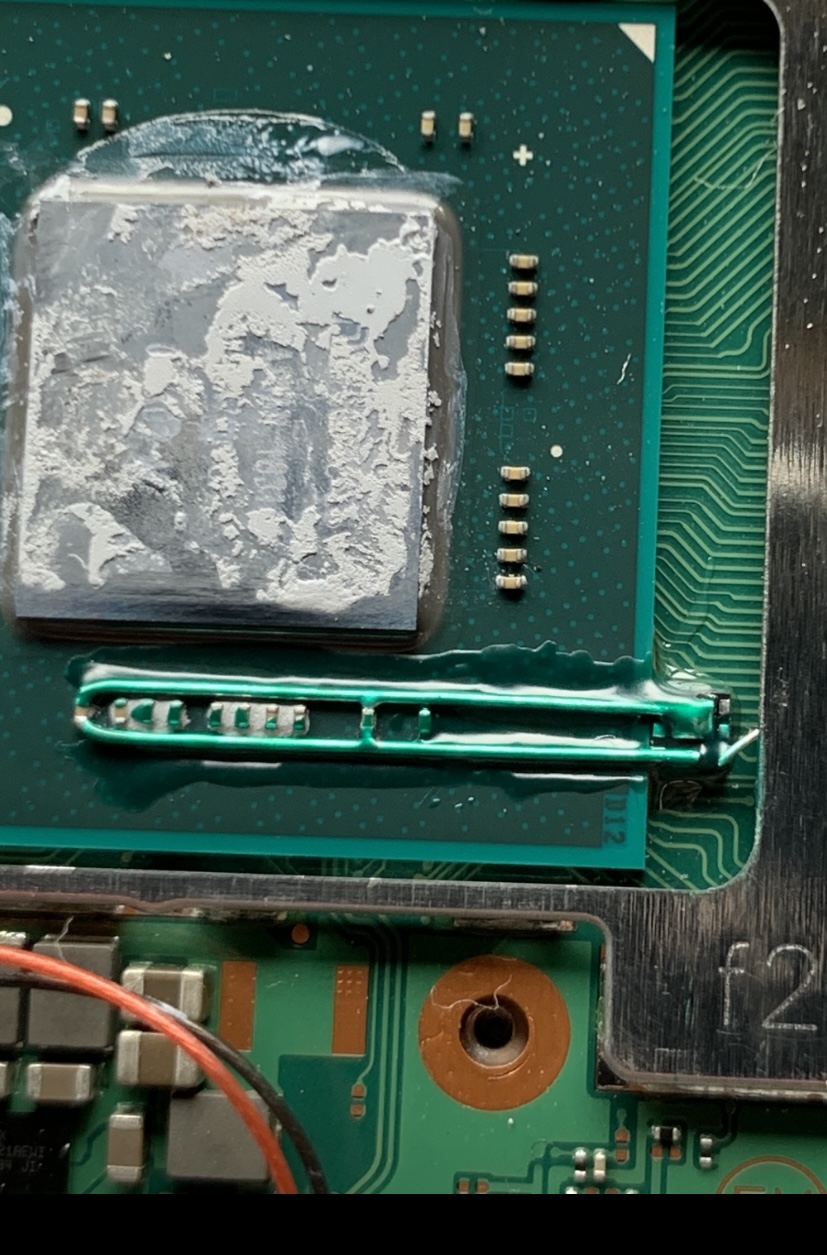

Need some help guys. Just got this message from someone who picked up from me yesterday.
I'd be willing to bet you accidentally broke two components loose near the APU shield. They are small 0201 SMD components and are connected to the WiFi/Bluetooth chip. With these traces broken, you have no wifi or bluetooth, which also keeps joycons from working wirelessly.
It should be these two, and you likely broke them off when removing the shield to solder the flex cable/Mosfets. They are 100nf capacitors and can be replaced using the same ones that can be robbed off the RP2040, as noted in the definitive guide.
Thanks for repply, I'll try to fix that tomorrow (it's almost midnight here)
