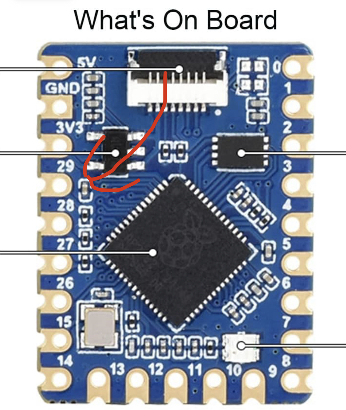

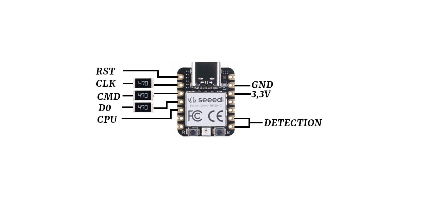

Where can this be found on the RP2040 Micro

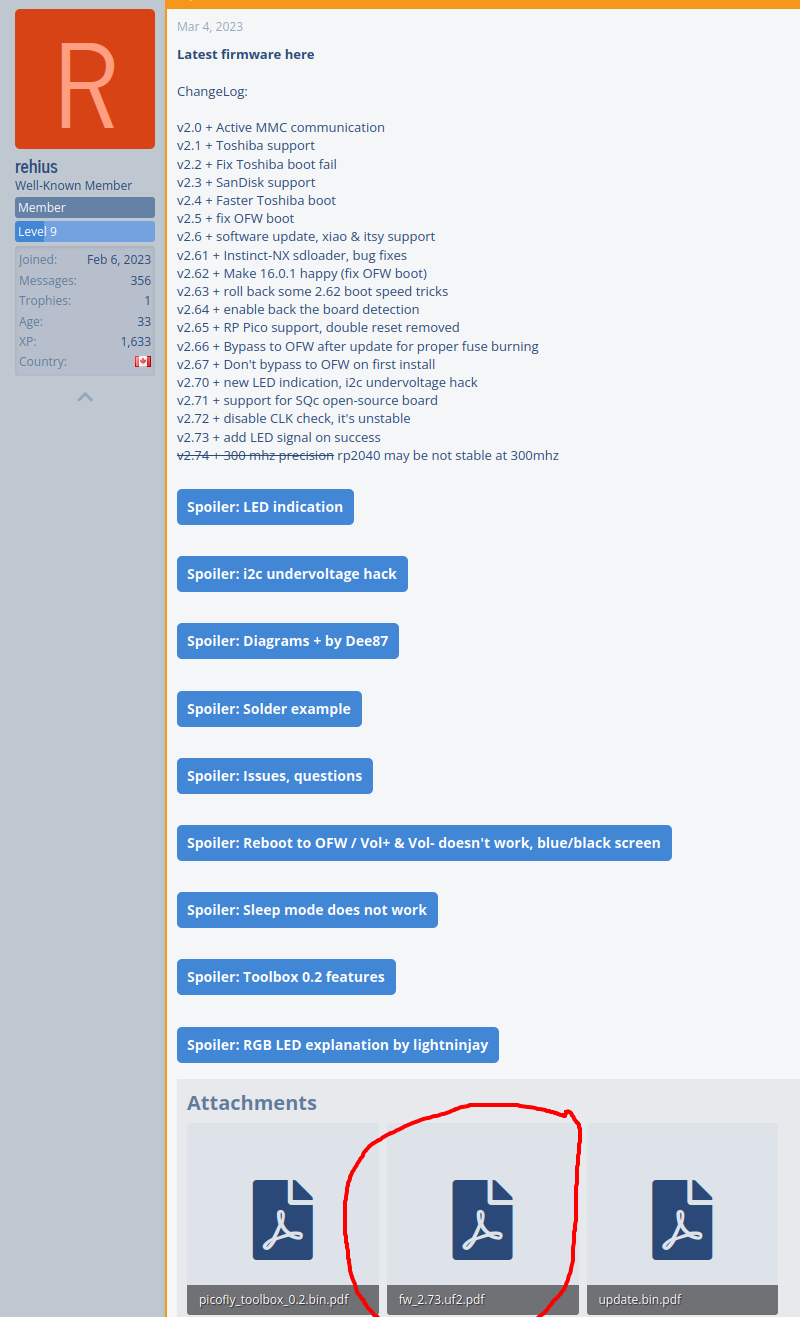

Latest firmware here
ChangeLog:
v2.0 + Active MMC communication
v2.1 + Toshiba support
v2.2 + Fix Toshiba boot fail
v2.3 + SanDisk support
v2.4 + Faster Toshiba boot
v2.5 + fix OFW boot
v2.6 + software update, xiao & itsy support
v2.61 + Instinct-NX sdloader, bug fixes
v2.62 + Make 16.0.1 happy (fix OFW boot)
v2.63 + roll back some 2.62 boot speed tricks
v2.64 + enable back the board detection
v2.65 + RP Pico support, double reset removed
v2.66 + Bypass to OFW after update for proper fuse burning
v2.67 + Don't bypass to OFW on first install
v2.70 + new LED indication, i2c undervoltage hack
v2.71 + support for SQc open-source board
v2.72 + disable CLK check, it's unstable
v2.73 + add LED signal on success
v2.74 + 300 mhz precision rp2040 may be not stable at 300mhz

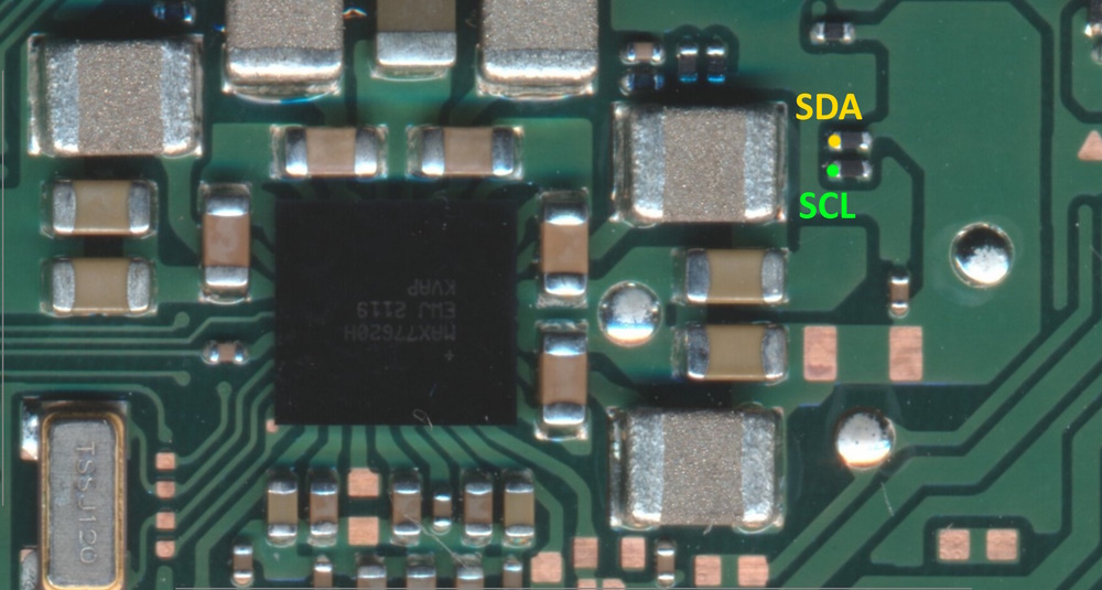

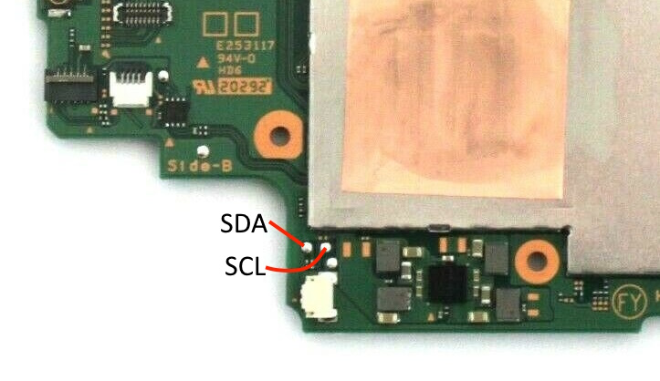

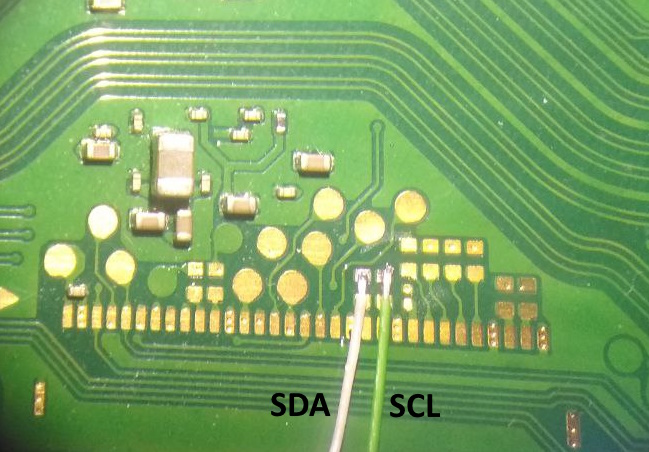

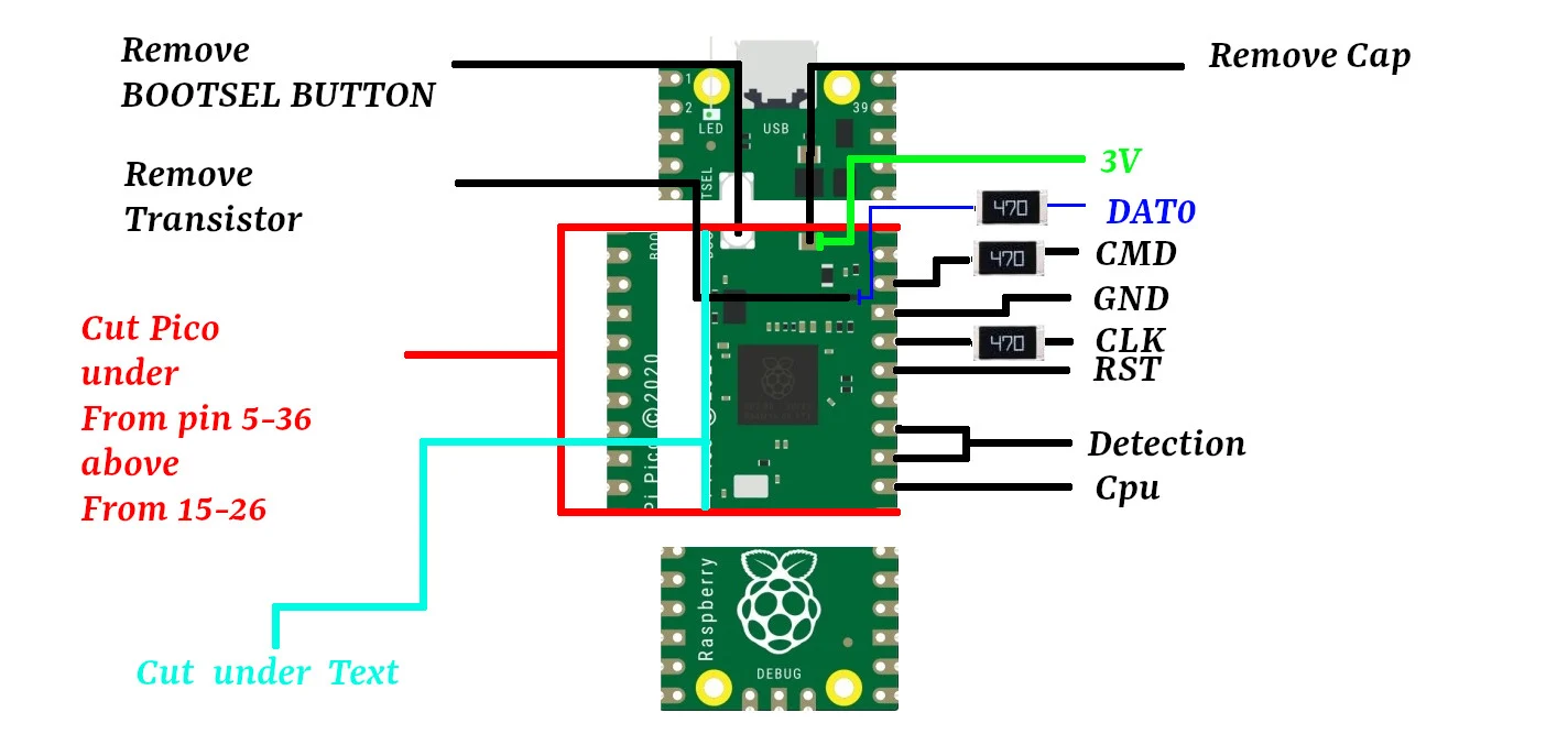

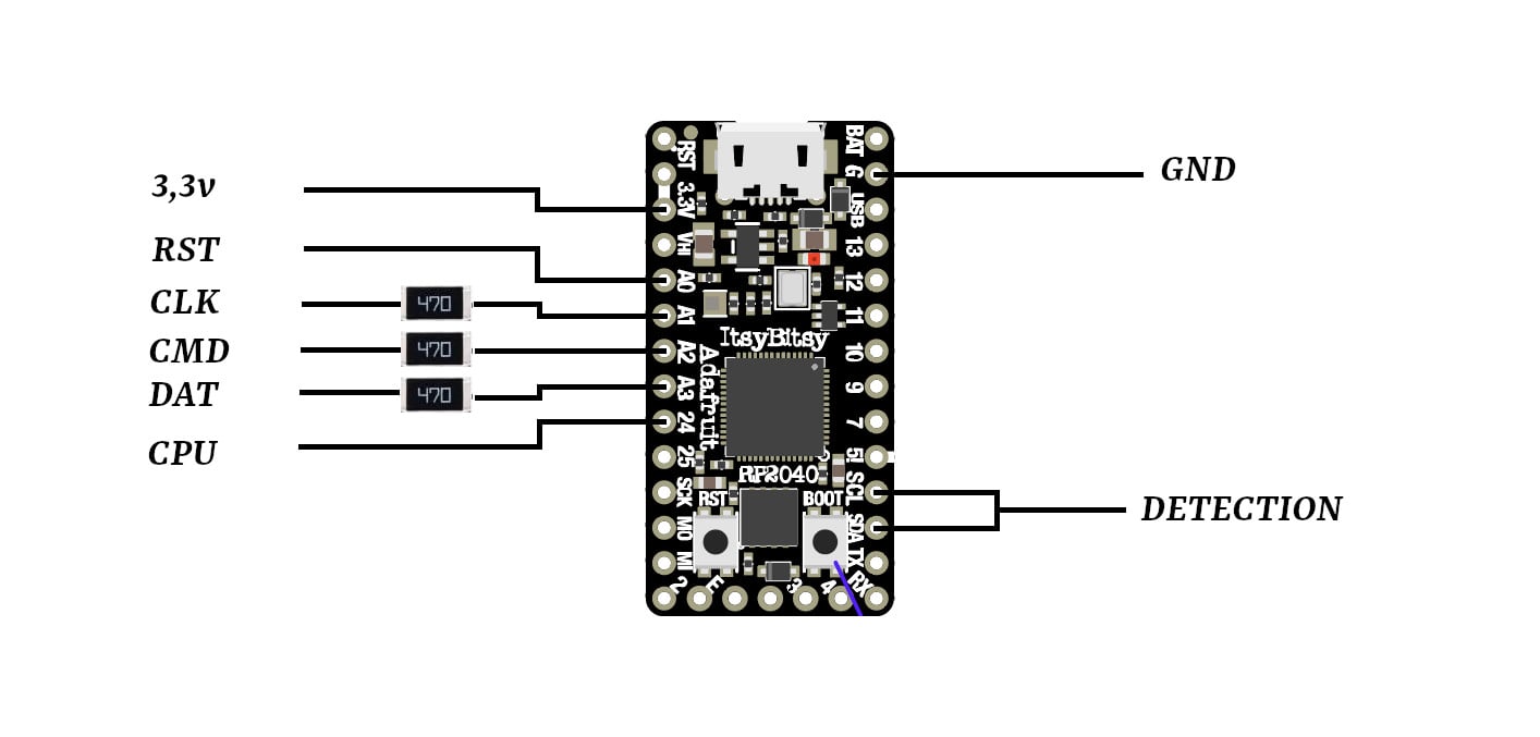

If your glitch is unstable (==* error), and the proper boot happens only when you press Reset after joycon logo, you can add two more wires to make glitch much better.
board pins:
Waveshare rp2040: SDA=12, SCL=13
Pi Pico: SDA = 19, SCL = 20
XIAO 2040: SDA=3, SCL=4
ItsyBitsy 2040: SDA = 18, SCL = 19

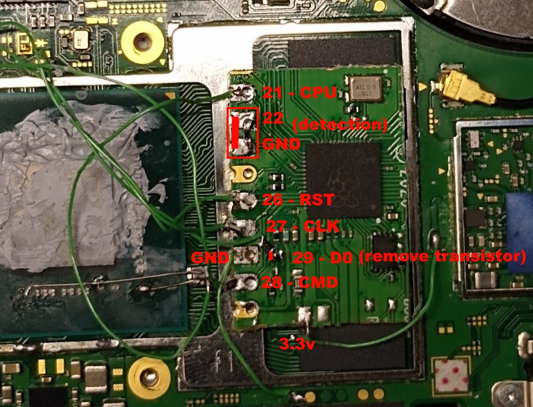

hello everyone, I would like to know if you have another cmd point?
