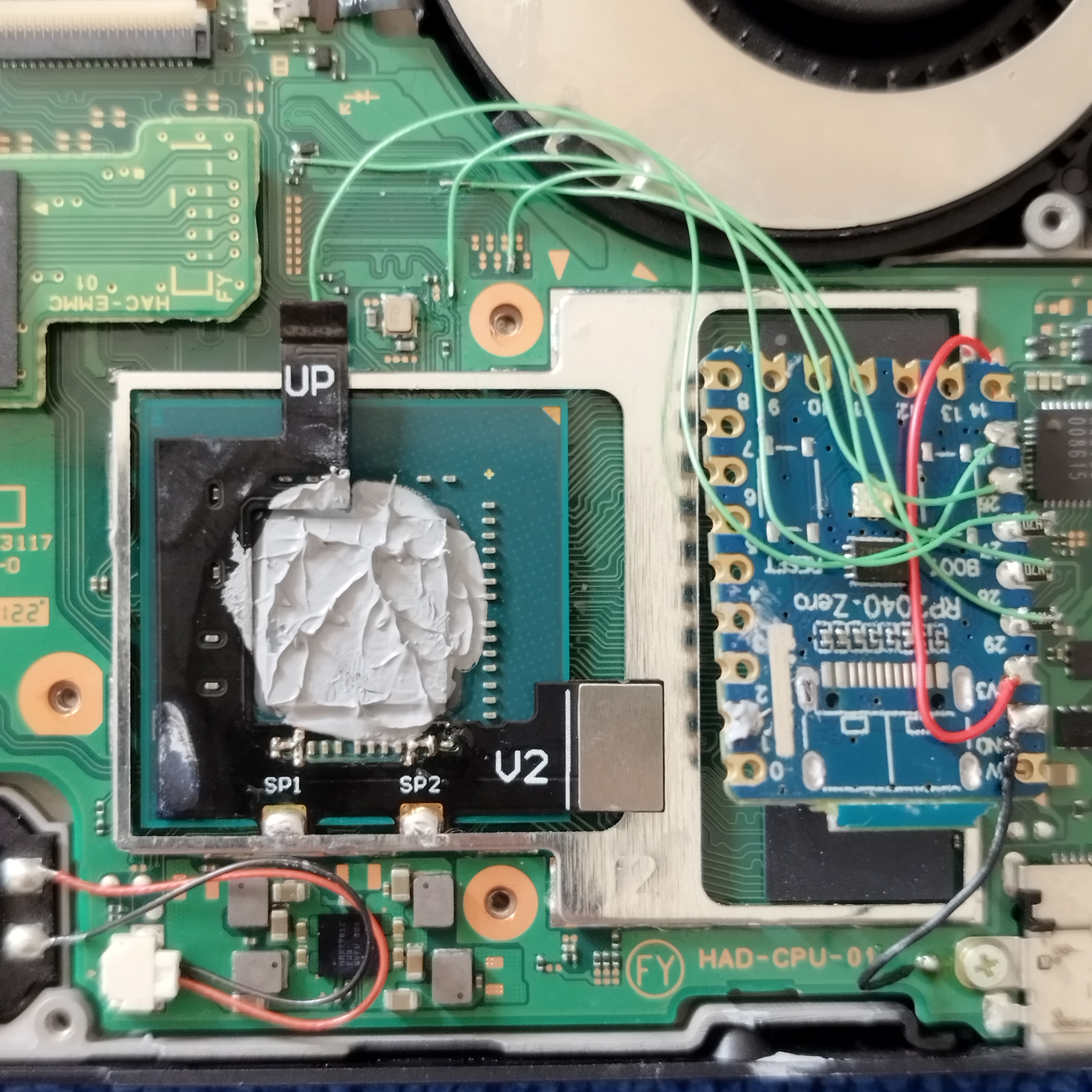

Hey guys !
I put an RP2040-zero on a switch V2 and it boots on OFW with a led code: Long green, short green, short green
I checked my welds, they are all good. Does anyone have any idea what I can check or change?
Thank you so much !
View attachment 380572View attachment 380573View attachment 380574
Try to put SDA and SCL wires before tearing it down to mosfet. Because sometimes mosfet is weak to do stable glitch. SDA and SCL wires help on weak mosfets. If SDA and SCL don't work then you have a bad mosfet, btw Good Luck tearing it down to mosfet level🤣

The led code indicates that there is something wrong with the mosfet.
Do you have pictures of that part?
long-short-short means emmc init failure during glitch process. afaik this isn't mosfet related. I would try adding extra resistors om dat0/cmd
I actually boot fine on the chip without the plate. When I put it back, I got the previous error.
Then you have a bad/cold joint or the solder point is to hight and is shorting with shield when you cover it. Try to put some kapton tape over the solder points and try again
Edit: And yes, 99% the problem is what @deeps said in the post below, that part of the flex goes under the shield. You are lucky something didn't get fried
the rightmost part of the flex cable (the metal square) is supposed to go underneath the shield frame, else you'll press it against the shield and cause a short
THANKS ! That was it! I've always put it like that though.. This is the first time I've had this problem!
No matter, problem solved, thank you, always so effective with the people here! <3
