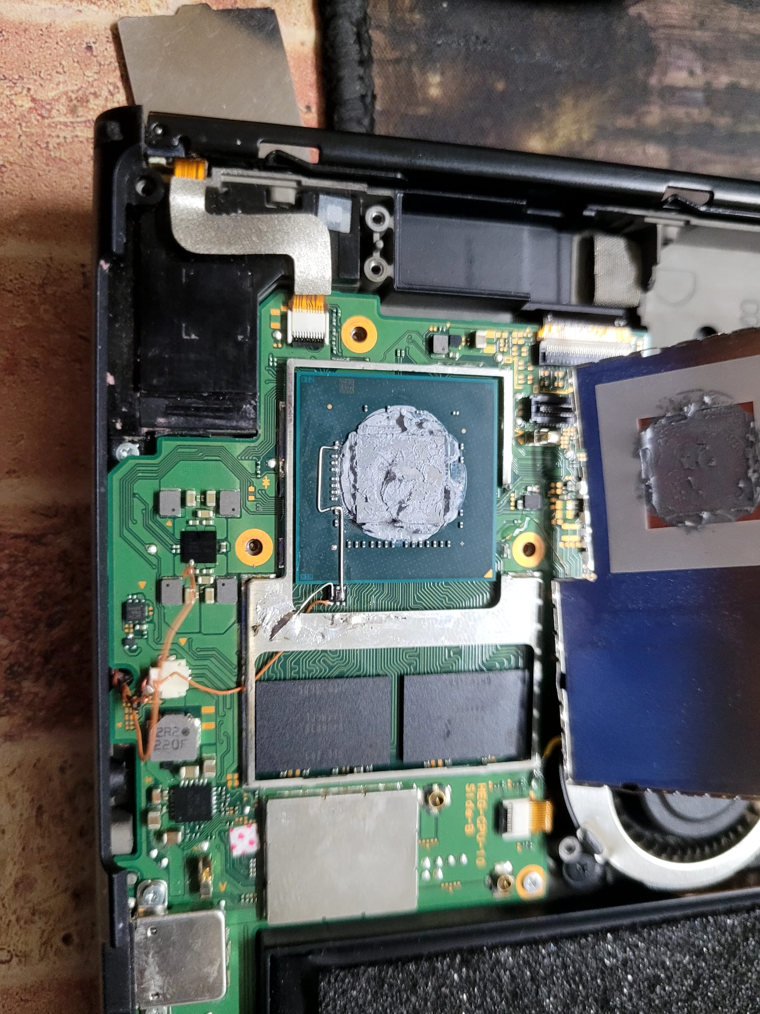

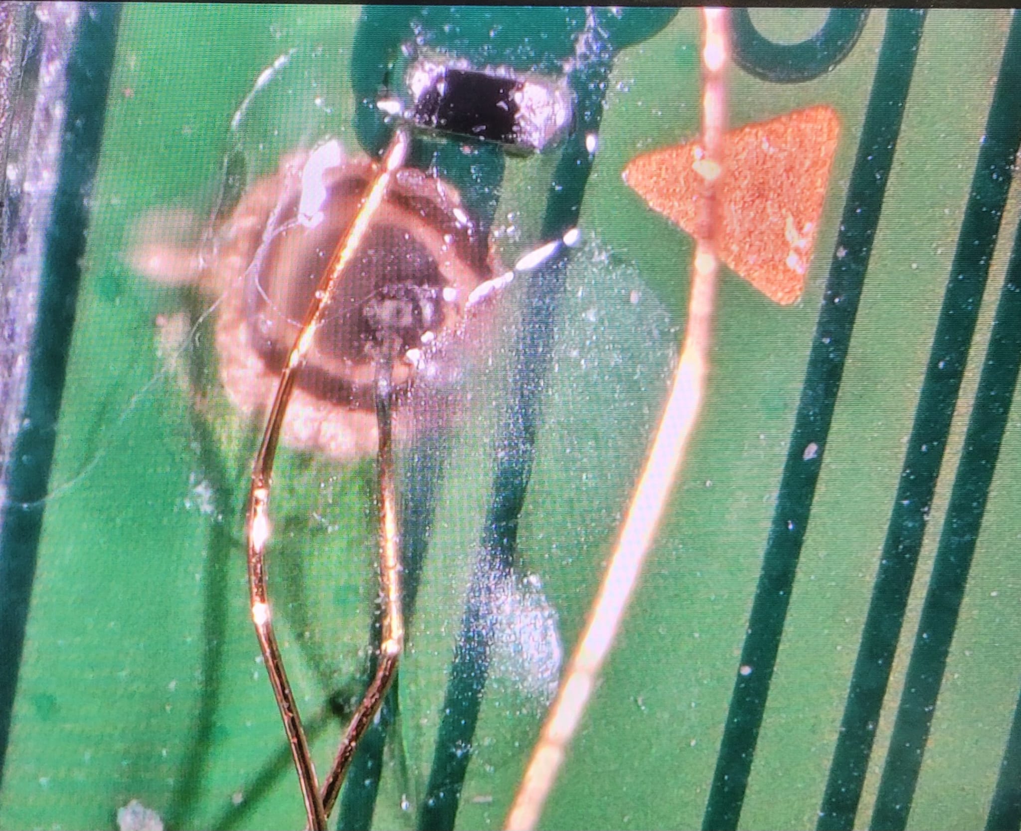

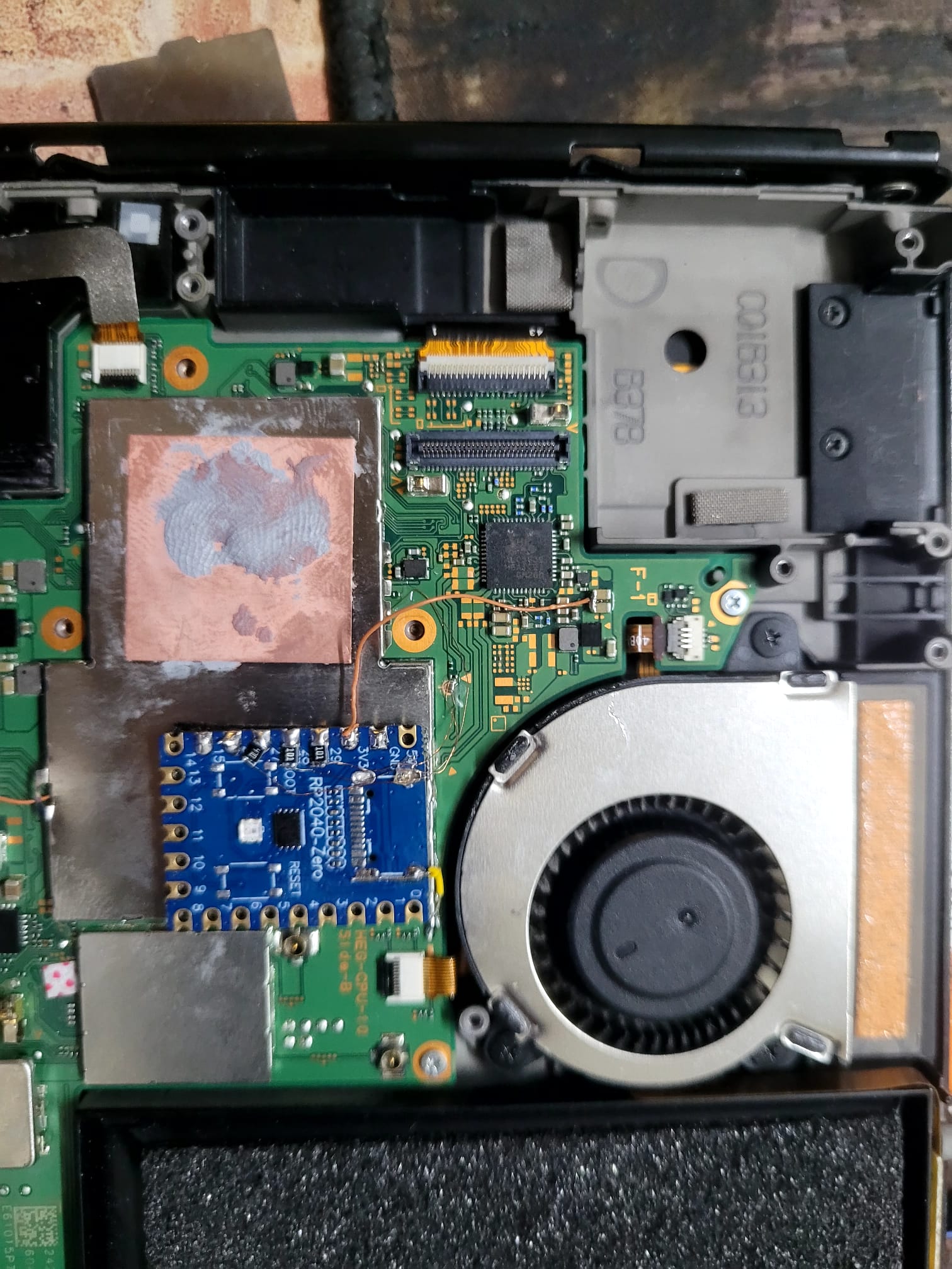

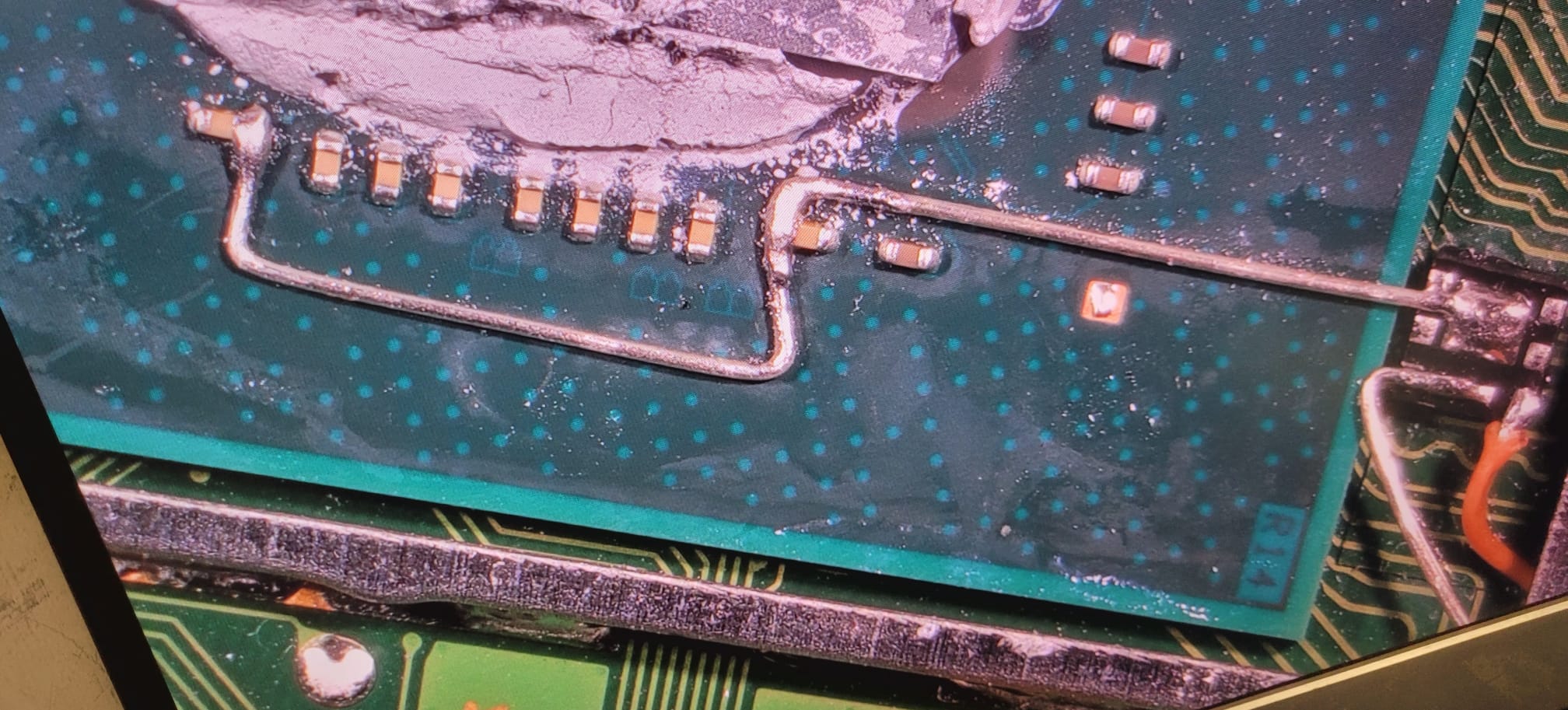

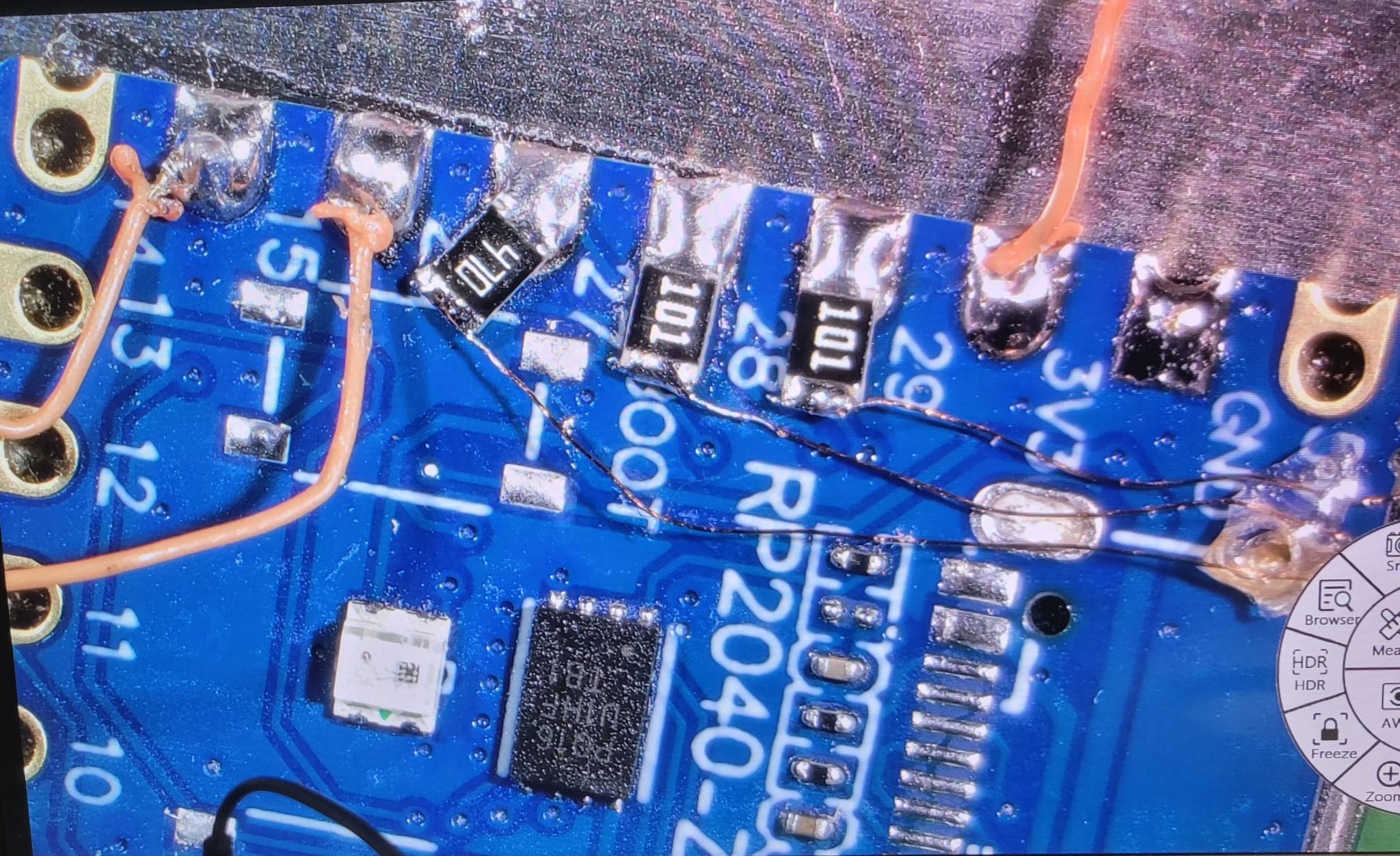

Good evening, everyone.
I'll start by saying I have little experience with errors.
Personally, I've done a lot of installations (I think about 100).
Today I installed a PicoFly OLED and I get = = *.
The codes tell me to check the MOSFET.
I replaced the MOSFET, the chip, and the resistors.
Always OFW.
What's going on?
On the kamikaze hole it is UV mask, not flux.

Have you tried changing the picofly? Also, try 47ohm on DAT and CMD.

Have you tried using a flex instead of the homemade MOSFETs? All the modifications I make are homemade, all wired with RP2040-Zero, and the only commercial thing I use is the MOSFET flex properly modified, because it saves me a lot of time.
Never tried 1.
Always done everything with wires, always.
This is the first console (I've made about 100) that's given me this problem.

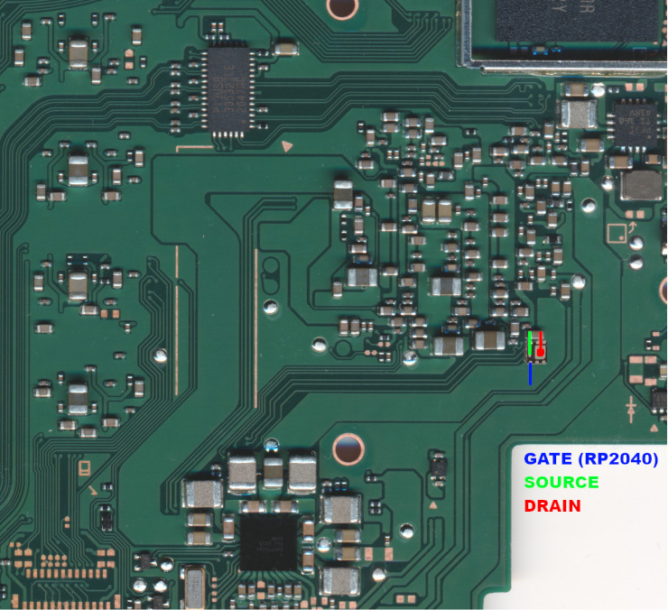

Sorry guys.
I know I'm clogging up the discussion.
I installed three MOSFETs, and they all burned out.
What am I doing wrong?
What could be causing the above?
I should point out that I have four layers of Kapton, so there's no way they're touching the shield.
Sorry guys.
You can install it underneath the board as shown in the installation guide.
