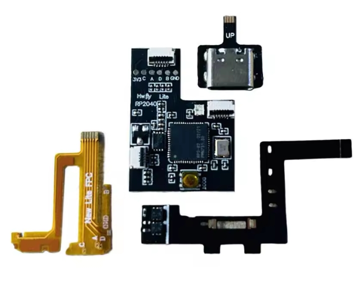

Can I use a switch lite modchip for a V1/V2 console?​
I bought this modchip for the switch lite and was wondering if I could use it to on V1/V2 console. Would I have to use wires to solder the parts together? I do not want to waste this modchip. If you can, please use a diagram to help me understand.
https://www.reddit.com/submit/?source_id=t3_1qdxrez

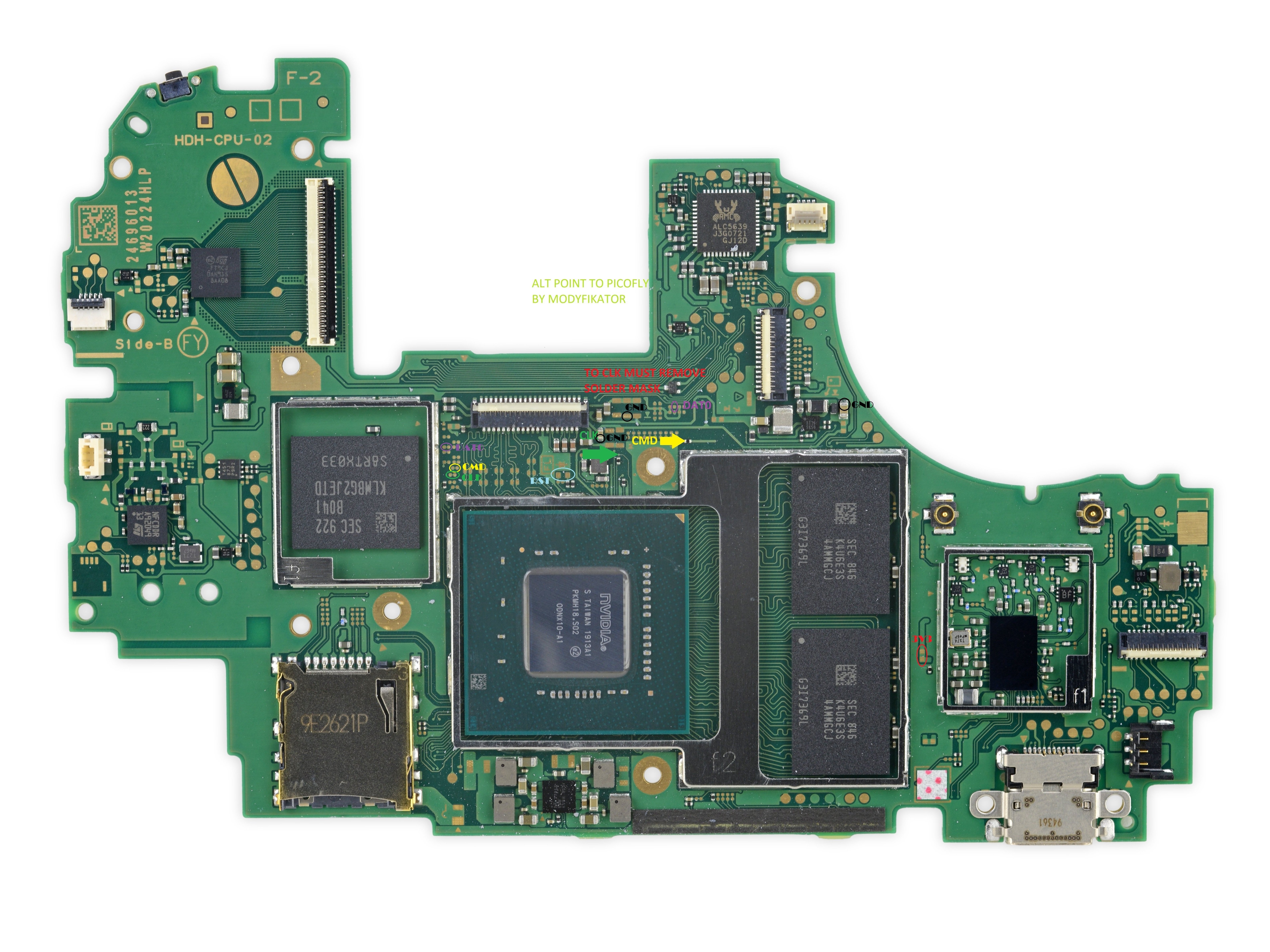

Yes, of course, manually install the points, one by one with the wire, obviously discard the flex.
Could you be a little more specific?
How should I be more precise? Look at the points that the flex touches by analyzing the motherboard of a Lite, I'll post you a photo, and you can see on the chip pads where they correspond and translate the diagram for a standard Switch. If you’re not able to do these basic operations, how can you think you can succeed?
There is another method that doesnt use DAT0 connector that avoids altering the board???
There used to be emmc adapters that you could place in between the emmc and the board.
You would need the skills to remove the emmc and reball the emmc though but it is less invasive as digging into the board in search for the DAT0 line.
