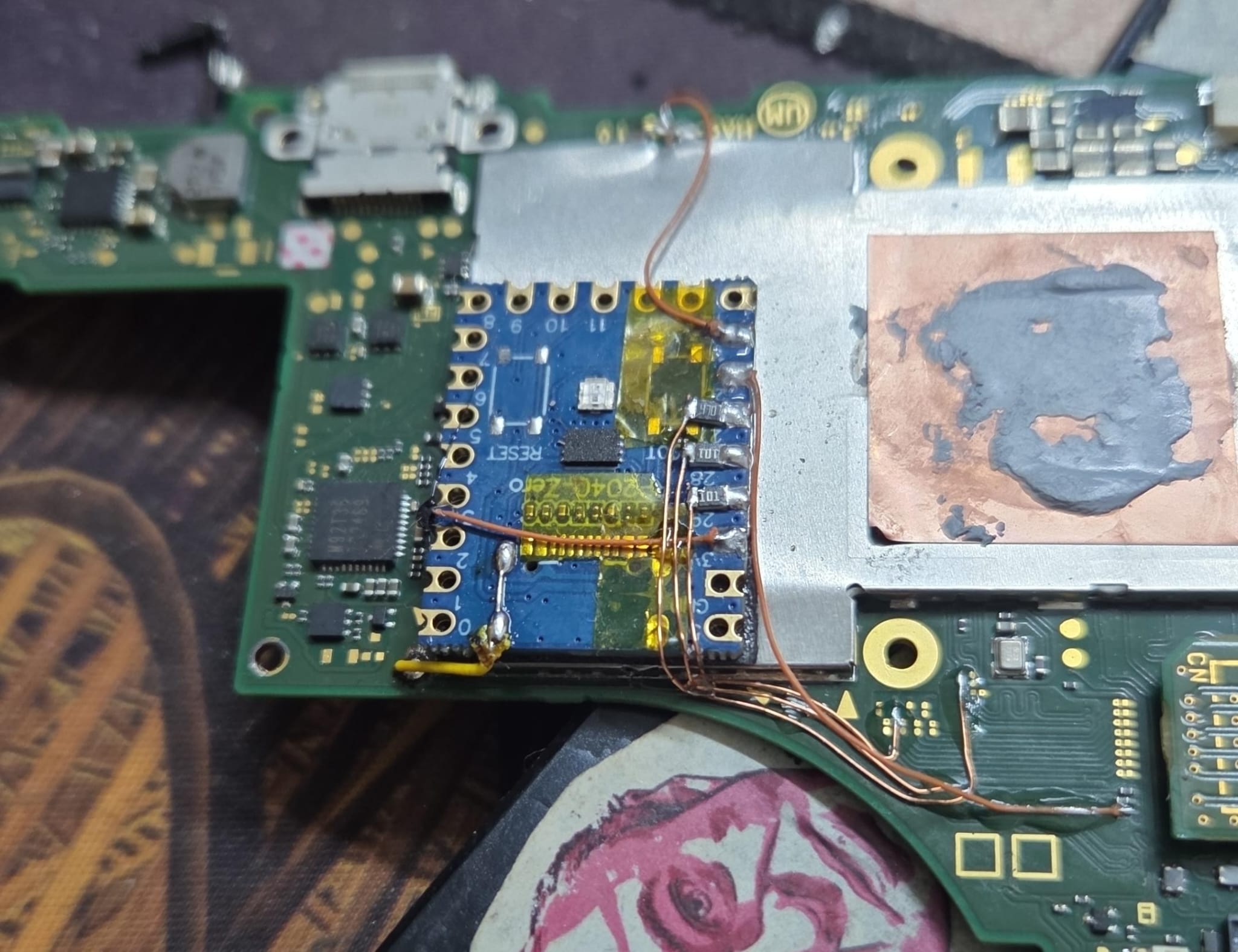

Evening, I'm switching to firmware 21.
I get a short yellow flash, a long one, another short one, and then it boots in OFW. As it boots, it repeats the same flash sequence.
With this sequence, the guide error reports:
No eMMC block 0 read (eMMC init failure?)
Of course, I've checked everything; the only thing I haven't tested is another RP2040.
Can you help me?

Error codes here:
https://github.com/Ansem-SoD/Picofly
