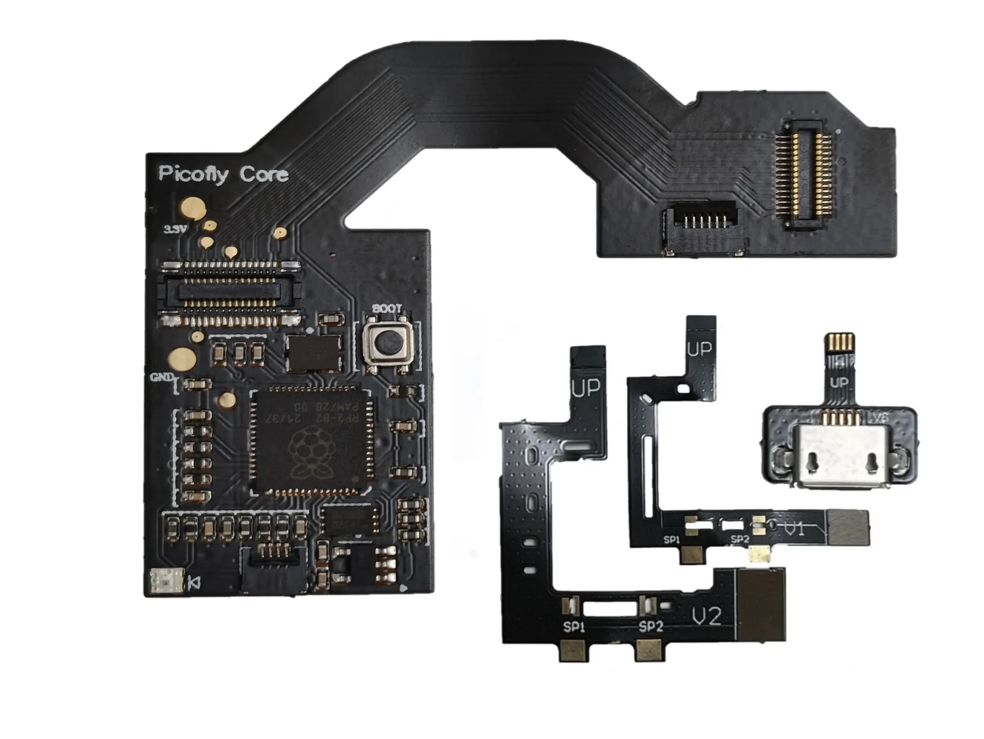

The pad is ok now, it no longer gives a black screen, now the blue screen lol, can I replace the 0201 100ohm with a higher value, will the lite work perfectly without it?
that is unlikely to solve your problem, I'm afraid. Recovery from blue screen is rare.

you need additional resistors on dat0+cmd.
I have the resistors of the tiny + 47ohms for dat0.
I will try to add 47ohms pour le cmd.

this should be a practical one
Hi,
until now I thought with the RP2040-Tiny (original one/ Waveshare), theres no need for additional resistors. But as i read now, sometimes, if it doesn't work properly, there are additional resistors needed (47 Ohm?).
Is this summarised correctly? Thanks a lot!
That's pretty clear! Looks like two ground layers and then you get to dat0.
But people in this thread have been using a different drilling spot or am I wrong?
back side also has a spot under 2layer ground. People use front side one because they don't need to take the board out and do everything at front-side.

Hi,
yes, you are correct. extra 47 ohm each for dat0+cmd. or replace the on-board dat0+cmd resistors with 100 ohms.
