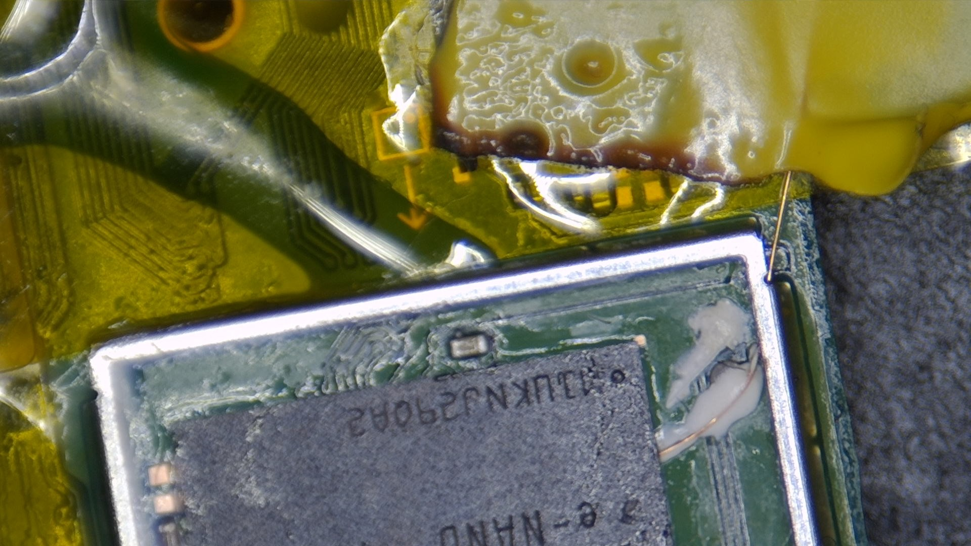

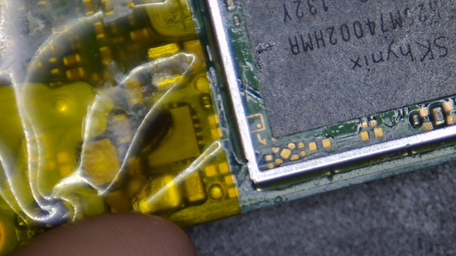

Hello guys, I'm going to install Picofly modchip on my OLED, but I'm confused about it's version and the proper soldering schema. Does anybody know what is it a version? And what is the correct connection schema for this version?
This looks allright to you guys?
I am getting ,in continuity, 500(board is cold) value from emmc shield ground to the wire connecting dat0 (its like a 10 cm enameled long wire, 0.1 cm/40 awg )
EDIT : guess this was ok idk. On the first oled i did the value was 450.

use the tiny but a original one not the clones then the resistors will be correct if u have slow emmc ur gonna have to swap the 47 with 100ohm thats it.
did u also add uv mask or whatever that white stuff is under the emmc?
did u flatten the 0.1mm wire? u might be having hight issues what ever ur issue is.
and one tip befor u even start the board clean the flux properly.........

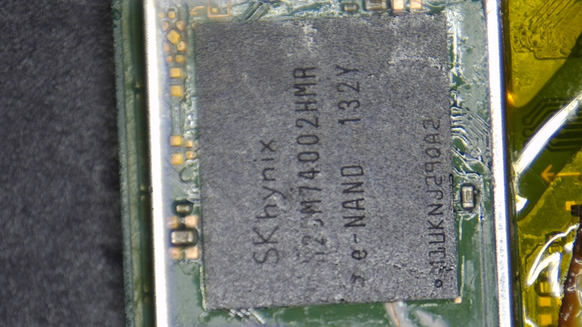

Pls dont do kamikaze. Its so risky. If you made a mistake, its permanent and its over.
Give reballing a try. its verryyyy easy. i nailed it first try .
You will need a bga 153 stencil (i recommend you buy the kit : chip suport+magnetic plates to hold the stencil) . solder balls 0.3mm (you can go with solder paste if you have the kit, but i dont have the kit for bga 153 ,i only have stencil,so its easyer with balls). And that is all.
Its so easy even a todler can do it.
