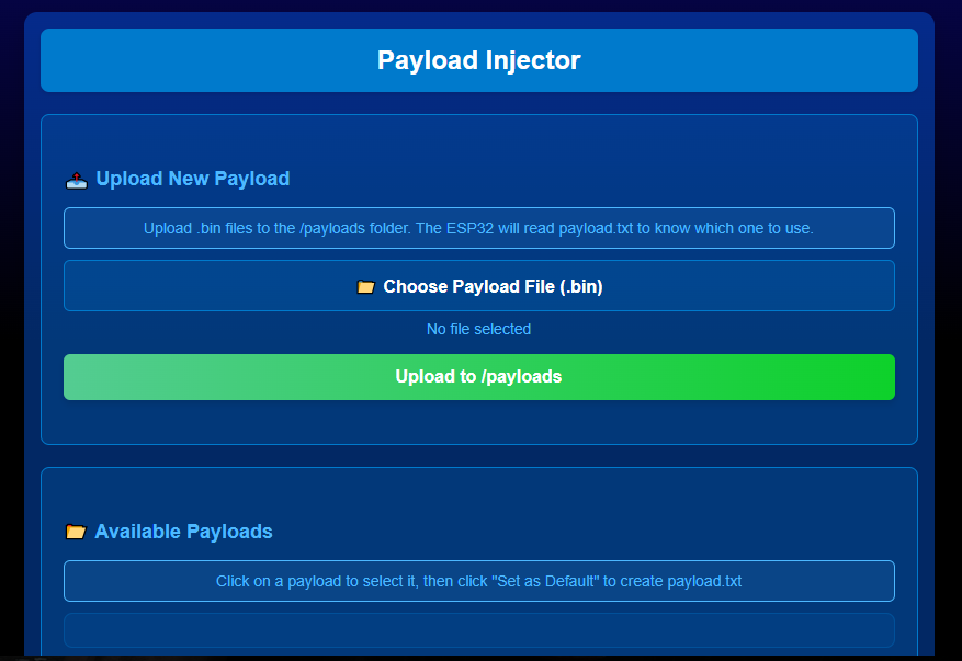

As per the title, I successfully created a payload injector using an esp32-s3 instead of one of those samd21 based chips. So far i've only made the injection code and it injects the payloads I tried properly and boots into hekate.
I've still got wifi stuff to add and a file manager for uploading new payloads as well as some other stuff that I plan on adding. I've not taken a switch apart before so I don't know how much room is inside it, Once I finish the software I was thinking I could use one of these:

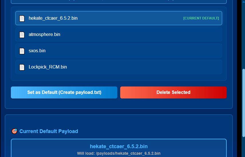

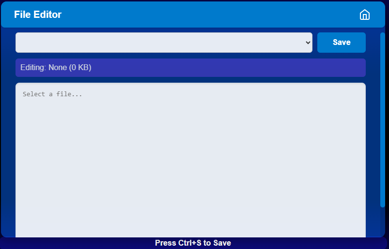

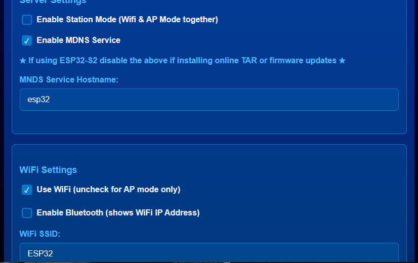

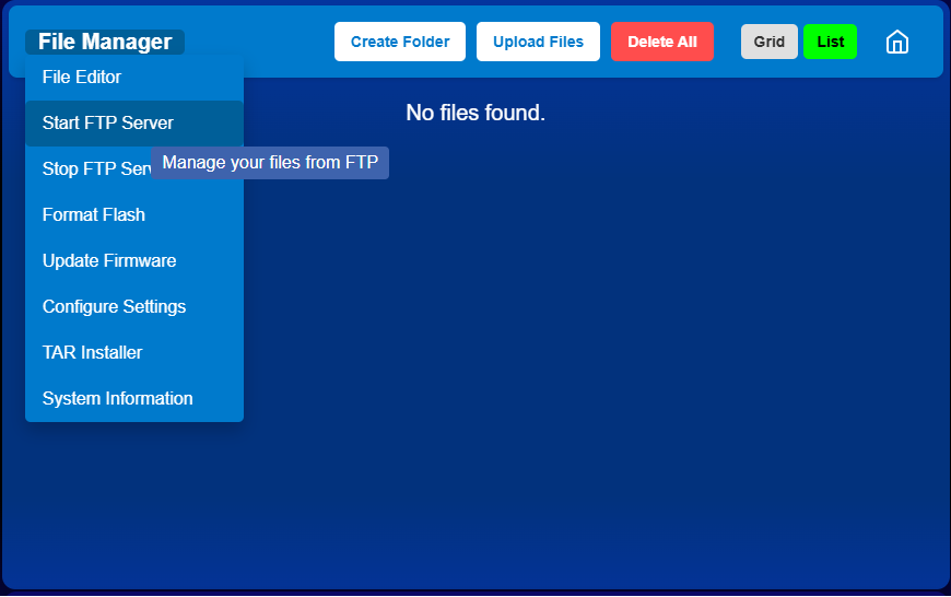

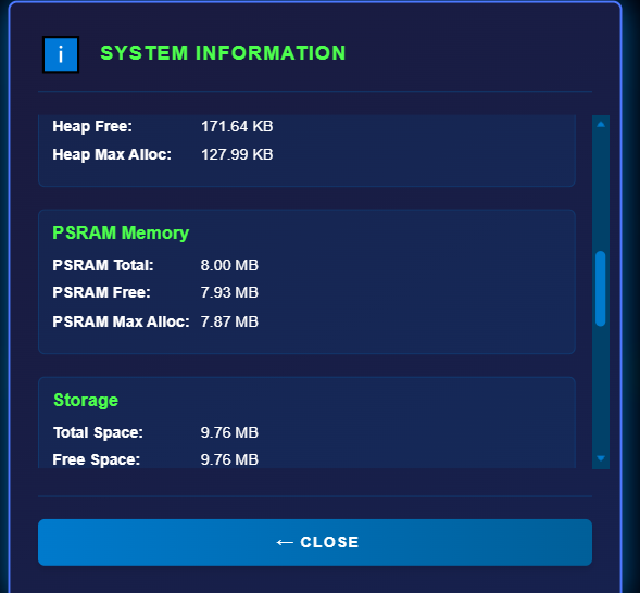

Yep thanks, I've written most of the code now:
Done - file manager, file editor, injection code, button code, led code.
Still do do - finish config page and this is what I was planning to do next for reference...
If the user doesn't press any esp32-s3 buttons during boot, the esp32 just tries to push the payload until it detects apx/rcm mode. Once the payload is pushed the esp32-s3 goes into deep sleep to save power. If the user presses an esp32-s3 button during boot, wifi or AP mode is activated instead and the user can use the web interface to upload new payloads or select from installed payloads, or update the firmware. I'm probably about 85% complete in the code now so should be finished in a day or two.
I've got Arduino compatible code and an esp-idf version done as well for the payload injection. I've tested so far on ESP32-S3 Devkit C1 - usb to switch is pushed via GPIO 19/20. Also tested on a Lolin ESP32-S3 pro. The code should also work on ESP32-S2 because that also supports USB host - but this has less SRAM and can have less features than ESP32-S3. Once the code is completed I plan on getting some ESP32-S3 mini's as these have the USB port already removed and once programmed any firmware updates or payload updates can be done via wifi.

If you PM me I can give you a very advanced version for testing that has many more features and probably the most advanced payload injector made yet.
WIFI/AP/Station mode.
Allows your esp32 to connect to you home network, create your own access point or do both at the same time
Custom FTP Server
Custom ftp server that can read/write to fat partition or micro sd card if enabled from the config page.
RGB LED support
Button Support;
Long Press - remove config (if you need to reset to default settings)
Double Press - turn off led
Short press - turn on led
Micro SD card support
Controlled by CS pin, so can use a micro sd card instead of using flash memory - could probably be wired to the switch micro sd controller so you could manage files via wireless instead of USB. Tested with inbuilt micro sd on Lolin s3 pro.
Deep Sleep support
Can shut down the chip after x minutes from booting, or after payload injection or both.
File Manager
Lets you manage all contents on your device such as uploading/downloading/creating folders/deleting all files/delete single files/format fat partition.
File Editor
Uses built in PSRAM to store files in PSRAM memory and lets you edit your files straight from the esp32
Payload Manager
Lets you upload/download set default payload and will put them in the correct folder.
Configuration Manager
Lets you change various settings such as WIFI connection, Assign GPIO pins etc....
Information Page
Show information about the esp32, like free flash memoy, build date.....etc.

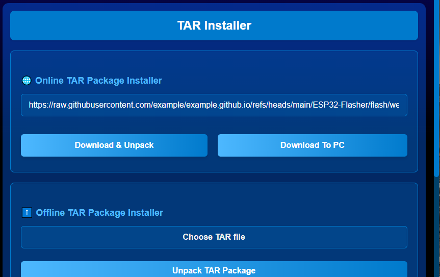

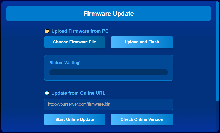

Firmware Flasher
Allows you to update firmware from a local file, or local/online web server.
Tar installer
Allows you to install a tar file from a local file or local/online web server
This is non public for now, but if you want to test on your chip let me know, then you won't need to mess about trying to upload payloads by using esptool.

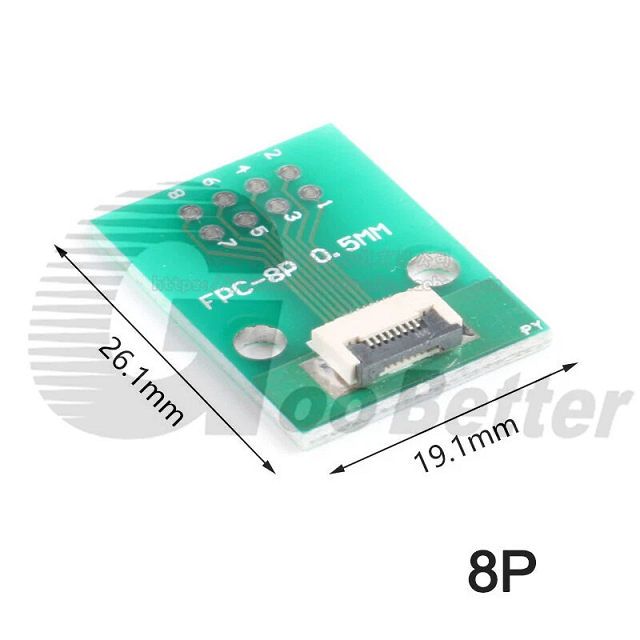

I also got the esp32-s3 board for internal modchip, I'm waiting for a breakout board to arrive for easy usb solder points.

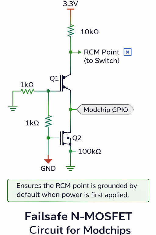

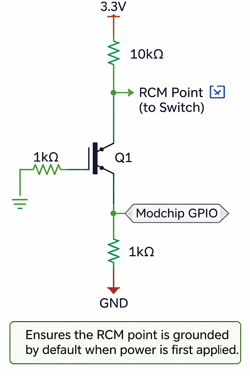

Full lifecycle of the modchip GPIO
🔴 0. Power OFF (console fully off)
Modchip has no power
GPIO pins are:
❌ Not driven
❌ Not high or low
✅ Electrically “disconnected” (Hi-Z by nature of no power)
👉 Important:
The MOSFET gate is held LOW by a pull-down resistor
So:
MOSFET = ON
RCM line = grounded
✔️ This already sets up the failsafe condition
🟡 1. Power button pressed (early power ramp)
Power rails start rising
NVIDIA Tegra X1 begins BootROM very quickly
Modchip MCU is:
still in reset / not executing code yet
GPIO state:
Still Hi-Z (input mode, unconfigured)
Circuit behavior:
Pull-down on MOSFET gate keeps it ON
RCM line = LOW
✔️ This is the critical moment → RCM is detected
🟠 2. BootROM samples RCM pin
Happens very early
Sees:
LOW → enter RCM
👉 At this point, the job is already done
🟢 3. Modchip MCU boots
Now the modchip firmware finally starts running.
Initial GPIO configuration:
Typically one of:
Sets GPIO → HIGH
Or sets GPIO → output + HIGH
Or briefly toggles depending on design
Effect:
Gate of MOSFET driven HIGH
MOSFET = OFF
RCM line released
Then the 10k pull-up pulls line → HIGH
🔵 4. Active phase (payload / logic)
GPIO is actively controlled
Could be:
HIGH (keeping MOSFET off)
Or switched as needed
👉 But importantly:
RCM line is no longer forced LOW
⚫ 5. Deep sleep (very important)
Now the modchip goes into low-power mode.
GPIO behavior depends on firmware + MCU:
✅ Most common:
GPIO set to input (Hi-Z)
Internal pulls:
Disabled or weak
What happens electrically:
External pull-down on MOSFET gate:
Pulls gate LOW again
👉 That means:
MOSFET = ON
RCM line = LOW again
⚠️ Wait — doesn’t that re-trigger RCM?
Good catch — this is where designs differ:
Two possibilities:
✅ Design A (common in simple circuits)
Deep sleep → MOSFET turns ON again
Next boot → always enters RCM
✔️ This is fine if:
You always want payload injection
✅ Design B (more advanced modchips)
MCU ensures:
Gate is held HIGH even in sleep
OR
Uses a latch / different topology
👉 Result:
MOSFET stays OFF
RCM not retriggered unintentionally
🔑 Clean state table
Phase GPIO state MOSFET RCM line
Power OFF Unpowered (Hi-Z) ON LOW
Power ramp Hi-Z ON LOW
BootROM check Hi-Z ON LOW
MCU boots Output HIGH OFF HIGH
Active Driven HIGH OFF HIGH
Deep sleep Hi-Z (typical) ON* LOW*
🧠 Final mental model (this is the “aha”)
👉 GPIO is irrelevant at boot
👉 Hardware guarantees the LOW
Then:
MCU wakes up → overrides hardware
MCU sleeps → hardware may take over again
⚡ One-line summary
The GPIO never “starts as ground” — it starts as inactive, while the circuit around it forces the correct state until firmware takes control.

Screenshots of upcoming firmware:
I've added bluetooth as well now, so you can find the ip address easily with your modchip is connected to your phone or router, the chip also has it's own server so you can easily manage your payloads. This firmware and code will be released soon(ish).
For those that know how to compile this, here's the full code with all the new advanced features.
First flash, make sure to use a custom partitions.csv file and put it in the same folder as the source code, then in ArduinoIDE make sure to select the following options when compiling;

See readme.txt, also check out RCM GPIO Explained for a wiring diagram and info if you want to use the RCM pin and use that for wiring into your switch, using that diagram is the safest way to prevent any wakeup issues.
RCM GPIO can be set in the web interface, use a GPIO from your board which is safe and is in a floating state when the chip is powered off. By default the first time you boot the chip a web server/access point will start - you can enter this by connection to esp32 ssid on your computer, then go to ip adrress http://192.168.0.1.
From that adress you can upload your payloads to the chip, then go into the configuration page and set up your wifi, onboard led, deepsleep mode etc...
If connection to your home router, you can also enable bluetooth. You will be able to scan for bluetooth connections from your phone and it will show you the modchips IP address, this saves you needing to look at your routers interface.
Anyway, this has now been tested quite a bit, for modders, you can mess about with RCM code, basically the current code sets the assigned GPIO pin high (from floating) when the chip boots. I recommend making a little custom rcm board for using this, if only needs a few parts and is easy to make, this saves on battey power, prevents any rcm issues.
For this with an ESP32-S3 dongle instead of using an installed modchip - no need to mess about with any RCM stuff, just flash and go. Tested on the following: Waveshare ESP32-S3-Touch-AMOLED-1.8 - with built in battery.
ESP32-S3 (various but all need PSRAM for extra features).
If you don't have PSRAM, I recommend just using one of the previous codes blocks from above, the one with payload streaming, then mod it how you like.
