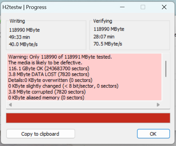

These are the results. Do i need a new microSD?
Also i thought of creating an emuMMC on SD partition rather than SD file. Would that make a difference?
