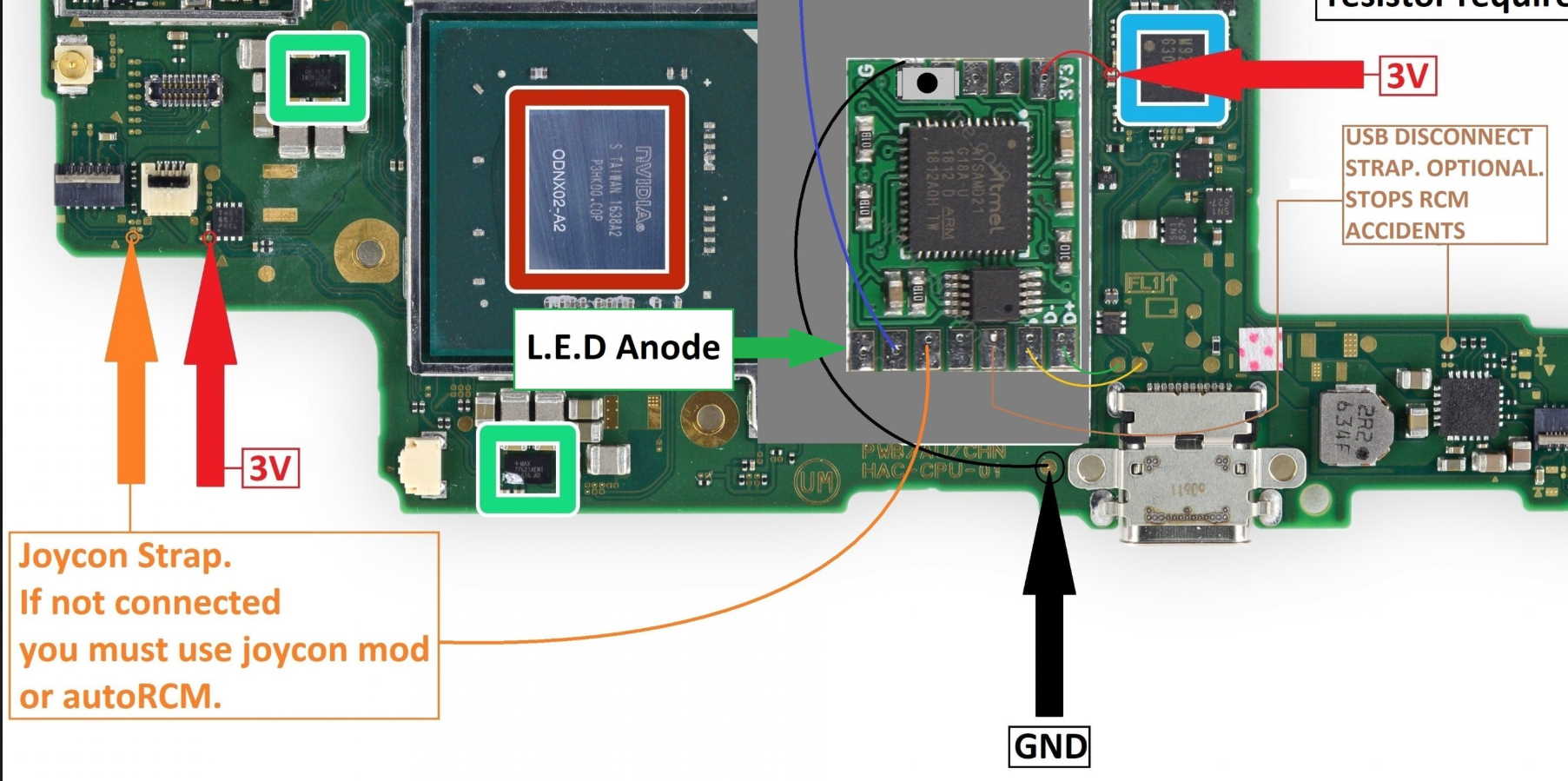

i dont have the boards yet, waveshare is usually fairly quick (couple weeks). i completely understand how the breakout board would make those points alot easier to work with. what im struggling to understand is (and sorry if im being a bit slow here) where are you connecting the breakout board to and why? are you connecting to the V,gnd,d+,d- on the switch motherboard so that you can use its usbc port to do something with the esp32 board (install/update)?

Yes, it's basically an advanced version of that but with wifi and way more features.
I will post install pictures when I do it, but it will basically be V+ (5volts point),, GND, D+, D-, RCM Strap).
