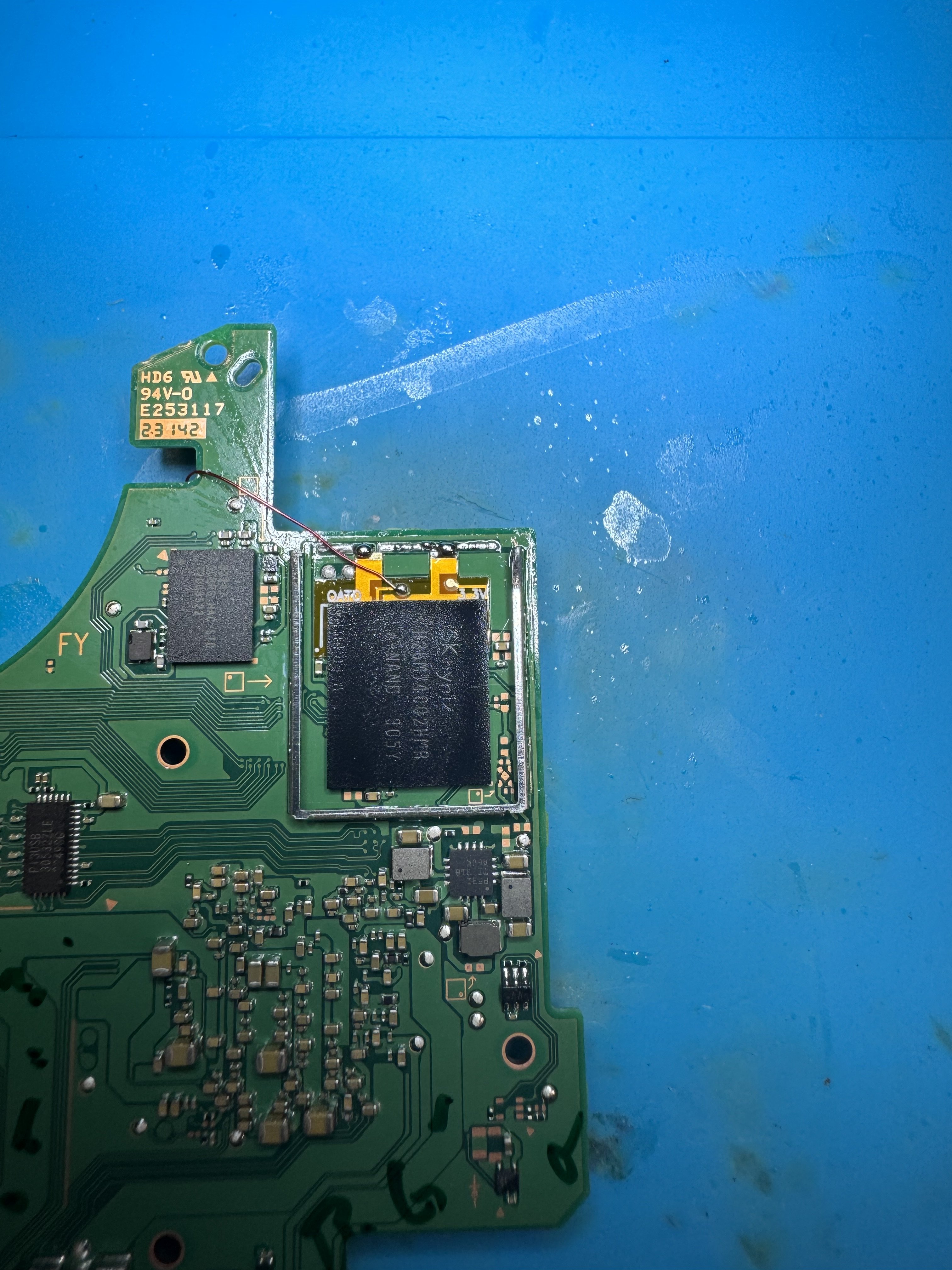

Any one know here the rst trace close to the emmc conector come from? I have ripped it and cannot make the solder stick to it.v1 switch
I tested that the emmc connector lead to that upper point on the bottom but I need to find where it come from to get to this red arrow(I need to make a bypass
Through each layer in between.
If you want to know, @Hassal just share file on pcb scan for each layer.
Search his post, or search on this thread.
Look that blue line, that is the reset connected through each layer.
For me it is safer to drill than to lift the nand. Not everyone has a good soldering station, the nand can break due to heat, break when handling it, break a pad, a lot of dirt spread by the flux, and thermal stress in general. It is very likely that the board will end up broken due to not knowing how to recover a pad or the chip itself. A jumper under the chip by joining dots, you connect the battery and goodbye. It is a job that is not paid, the client does not care if you install an adapter or a fixed point, if the adapter comes loose, the problem lies with the installer. Drilling is cheaper, cleaner, safer and you get the same result. A fixed point.

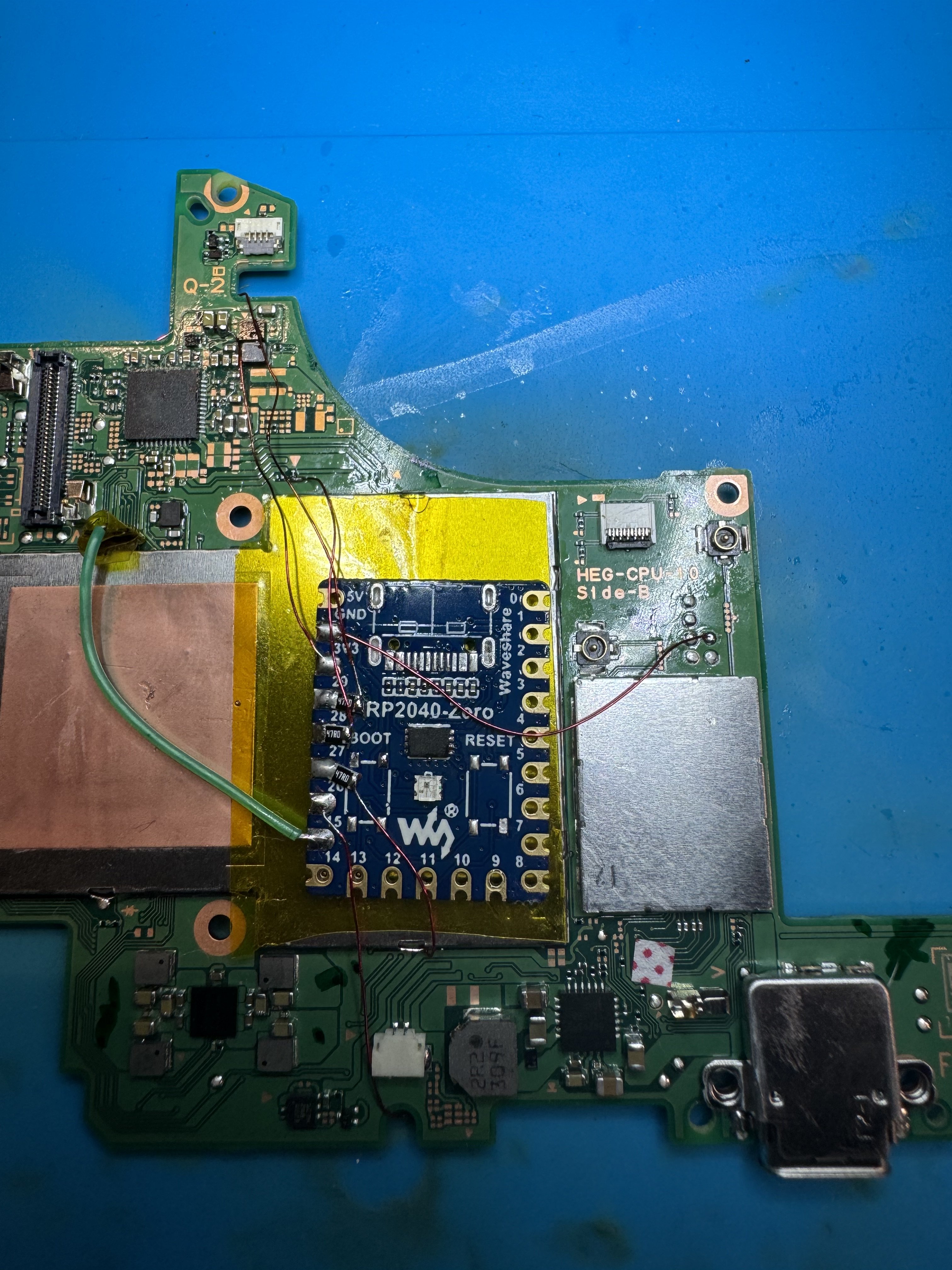

Having some difficulties with this OLED. I keep getting the *=* (no Emmc block 0). I’ve tried two different Dat0 connectors, reconnected everything , and it still the same. Readings are:
Dat0- .483
CMD- .636
CLK- .656
Dat0- .483
CMD- .636
CLK- .656
Two things
You have a spot of flux
The adapter is no good. I doubt you even have it aligned

Always in the same place, I go slowly completing each layer and cleaning to be able to see, a drop of liquid flux to hydrate and to be able to see through the layers. I scratch the line just enough with a pin and reveal it. Green nask around, flux, tin, I connected an enameled wire and secured it with hreen mask, first the hole and then the run. A slight tug tears off the line.
Yesterday doing internships I managed to change a SKhynix nand for a Samsung and restore the backup, take the opportunity to put enameled wire and get a permanent line.

All flux has been cleaned and I’ve used more than one adapter. Has to be something else.
But does it boot original? It may be that the ball of the DAT0 has deformed and that the tongs of the adapter are touching several points below the eMMC. Try cutting the left fork if you use the adapter
It was late last night so I didn’t try getting it to boot into ofw. Do I need to disconnect the whole thing? I did a reflow on it and I still get the same readings.
