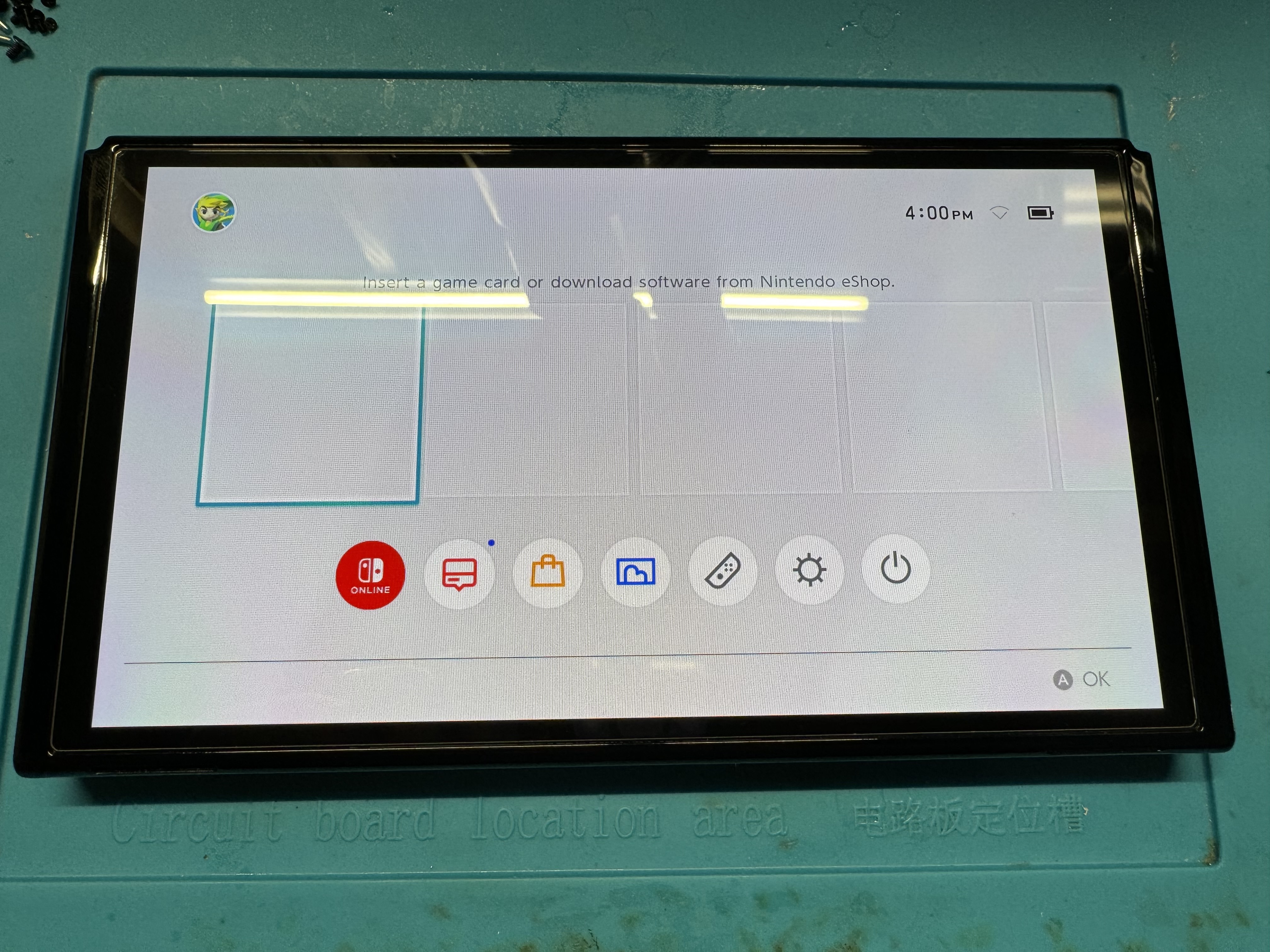

I just wanted to come back and say that you were correct… partially lol I went over the board again and removed the wiring. I had left it there in case I got it to work. When I removed the wiring from CLK I noticed that the pad had come away from the via. I restored the trace and lo and behold it works again. It’s no longer a candidate for a mod but at least it works. I had used a grinding pen to expose the point which I’ve never done. Definitely won’t do that again. Anywho, lesson learned
Reactions: LuigiGad
