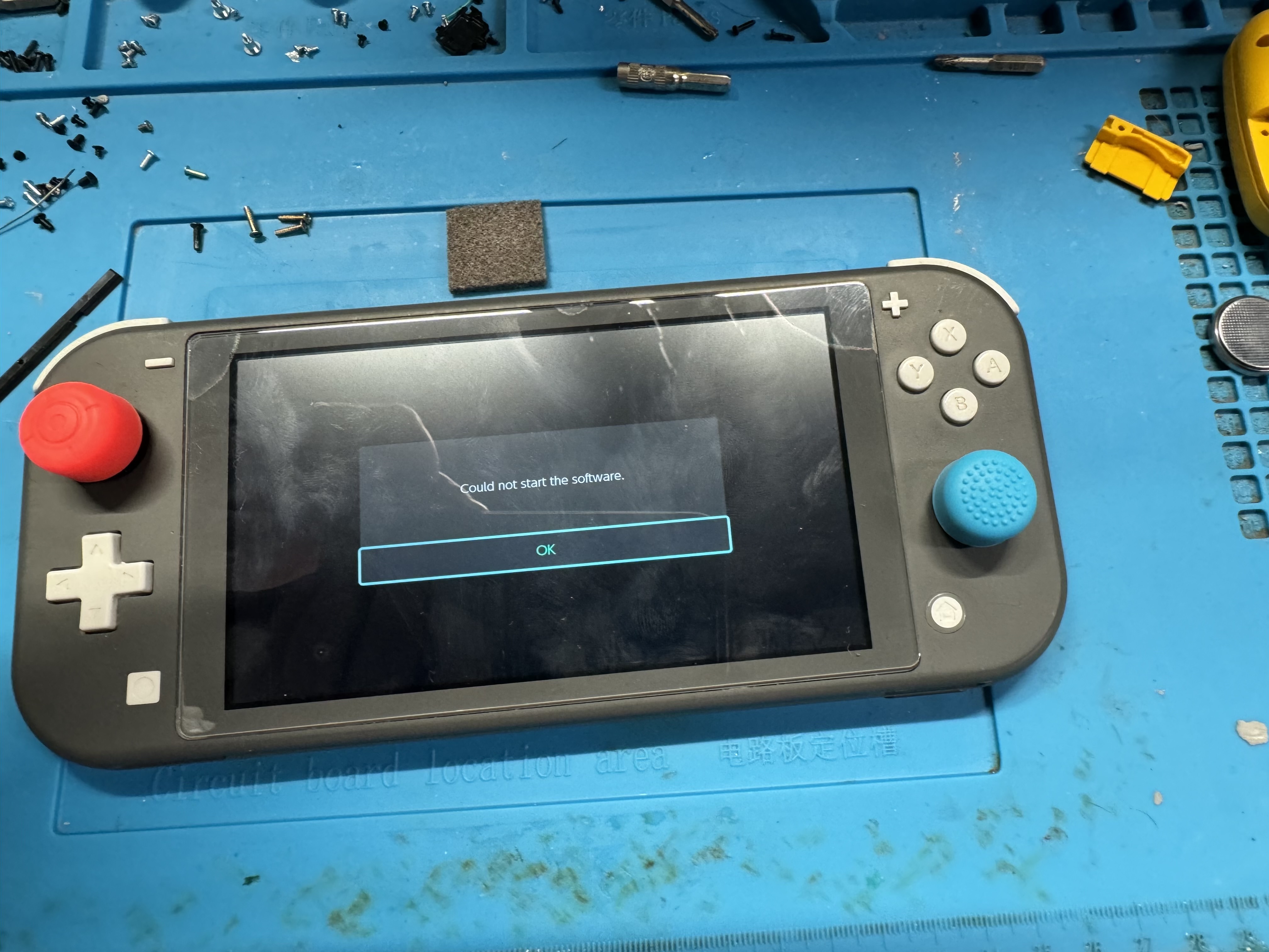

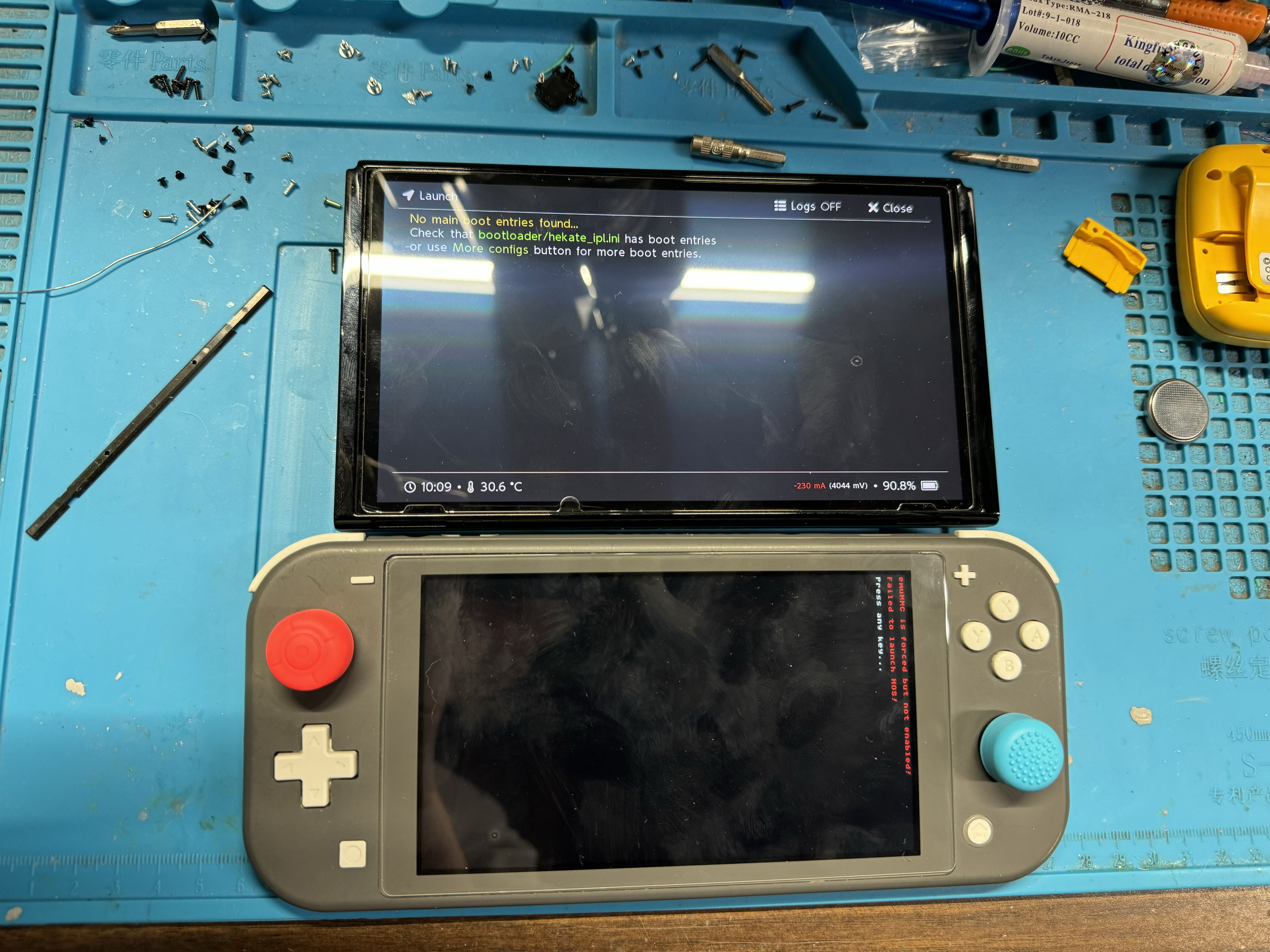

Have two switches here that have been modded (not by me). Apparently he brought them to my partner and tried to get him to fix them. He tried for about an hour and determined the emmc had somehow been wiped. He then brought it to me not knowing we work together. It boots into hekate but won’t boot into ofw. How is this even possible? I haven’t done anything with them. Are they bricks?
Wild guess but maybe the eFuses? (The user burnt the fuses with a newer firmware than the OFW/)
on the oled , you dont have the proper files set up on the sd card. on the other one it looks like you dont have emummc created. im just stating the obvious. if you have determined that in heckate->emmc info you have partitions missing (there should be 10 in total), you can try to restore nand data. If you are able to get prodinfo this would be great. If not, from what i can remember you can get a donor prodinfo but these consoles will be banned (i think).
for a complete tutorial to restore nand memory, you can youtube sthentix guide. I would start straight away with the lvl 2 one if you get prodinfo, if not go to lvl 3.
Again this is only in case the nand memory is bricked,and if your problem doenst lie somewhere else.
that does not make sense. if you install a fw on OFw and burn fuses, it wont matter unless you change the fw on OFW AGAIN to an older version
You never know what the previous owner did with it.
Afaik if you don't have a modchip installed and the fuse count is too high, the Switch just won't boot with a lower firmware and therefore you just can't upgrade to a higher firmware as well.
Another thing I just realize, you mentioned that the entire emmc is somehow wiped.
That would also include your BOOT0 partition. Hekate doesn't need it, OFW does require it.
In Hekate you can select to dump the Boot0/1 partition.
If the emmc is completely wiped, then Hekate will show an error.
There were some reports of people messing up their emmc in this thread if I recall correctly.
Not sure how they fixed that but there is a manual for rebuilding the NAND with a donor switch :
https://gbatemp.net/threads/switch-unbricking-guide-for-dead-or-replaced-emmc-consoles.609891/
Someone mentioned that he could not boot into OFW when his battery was dead.
For Hekate 0% battery was no problem but the OFW/CFW does not boot with 0% left.
Hekate shows the battery level so that would be an easy check.
So the lite actually ended up being a kiosk model so I have to install a special atmosphere to get it to boot and even then it wouldn’t go to cfw. Only the sysnand. So it’ll just get banned. But at least it’s usable. The oled on the other hand is toast. Has a bad emmc. I spent the better part of the last 24 hours trying to fix someone else’s mistake so im done.
