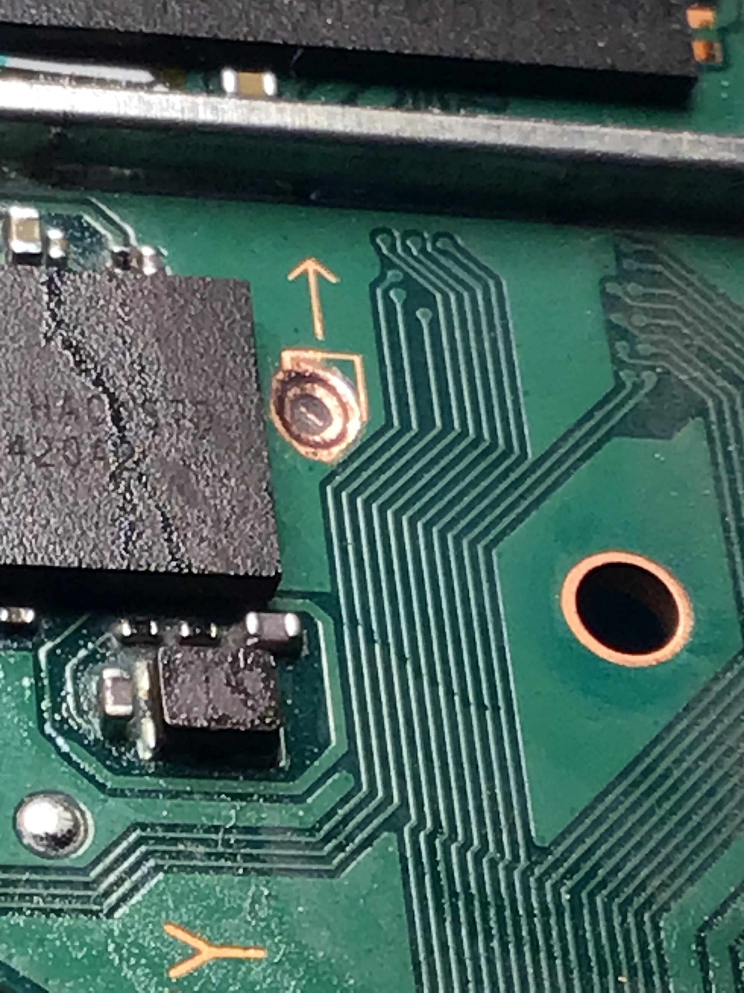

I regularly had problems with the DAT0 contact on my OLED switch and decided to connect by drilling. Everything went well, but I spent the whole night using my wife's nail machine to do it :rofl2:
I also managed to discover the runway, but I assure you that it flies with a sneeze... It is not easy to take the point in that "well" without interrupting it
This is still so amazing and crazy to me. Can you share your method of doing this? Just a rough explanation, not asking for a step by step guide :D
do you have any pictures with the clk pad damage?
I don’t. The pad has come away from the via but was still attached to the trace.
People has warn like thousands time in this thread, don't use grinding pen, its risky. That the only method you used, when theres no other method available.
The problem not just lays on the risk of grind that trace out of the pcb. Its also the debris, which almost couldn't be cleaned out. You will need an ultrasonic cleaner for that, and it gives another risk of destroying the component cause of the ultrasonic waves. And you need to use alcohol, if you use water, it will lead to another risk of corrotion. Even the alcohol you used have water on it, except you buy a 99% methanol/ethanol.
And even if the clk ripped, that device still could be modded, if you use emmc adapter. Since the clk, cmd, dat0, 3.3V, gnd all exist on the emmc pins.
Like i said, the clk point is risky. I rather use emmc adapter, to solve the risky clk, the problematic dat0, and the difficulty of cmd point, in one solution.
Thank you for all the info. I didn’t know you could use an emmc adapter for those other points. How would one go about that? Obviously I would still like to mod it but u didn’t want to disturb my hard work getting it back up and running. It’s my personal switch. Would have never risked a customers switch trying something new.
Un
Always in the same place, I go slowly completing each layer and cleaning to be able to see, a drop of liquid flux to hydrate and to be able to see through the layers. I scratch the line just enough with a pin and reveal it. Green nask around, flux, tin, I connected an enameled wire and secured it with hreen mask, first the hole and then the run. A slight tug tears off the line.
Yesterday doing internships I managed to change a SKhynix nand for a Samsung and restore the backup, take the opportunity to put enameled wire and get a permanent line.
I'm probably lacking the knowledge but did you solder the dat0 wire as a jumper to that via? So that you could get an easy solder point from that pad on the right

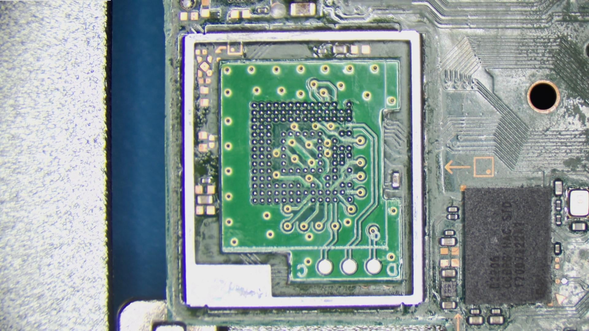

This adapter is no longer sold by any seller on aliexpress, However you can order your own by ordering from JLCPCB with the files from the link provided by @Crung above. You will need to reball the adapter and the emmc.
What's the best way to install these btw? Reball adapter => solder to pcb => reball emmc => solder to adapter
Or
Reball emmc => reball adapter => solder emmc to adapter => solder emmc+adapter to PCB?
Or
I'm doing adapter first, then emmc. Seems more logical, and it's a good idea to not expose the emmc to more heat than necessary. So the workflow is as follows:
- detach emmc from mainboard
- clean mainboard with solder wick
- clean emmc with solder wick
- reball emmc
- reball adapter (on the bottom side)
- attach adapter to mainboard
- attach emmc to adapter
Reactions: LogicalMadness
Or
im pretty sure you solder the adapter to the motherboard and then the emmc to the adapter. if you solder the emmc to adapter first and then to motherboard im pretty sure you wont have enough heat or no way of knowing if its properly there

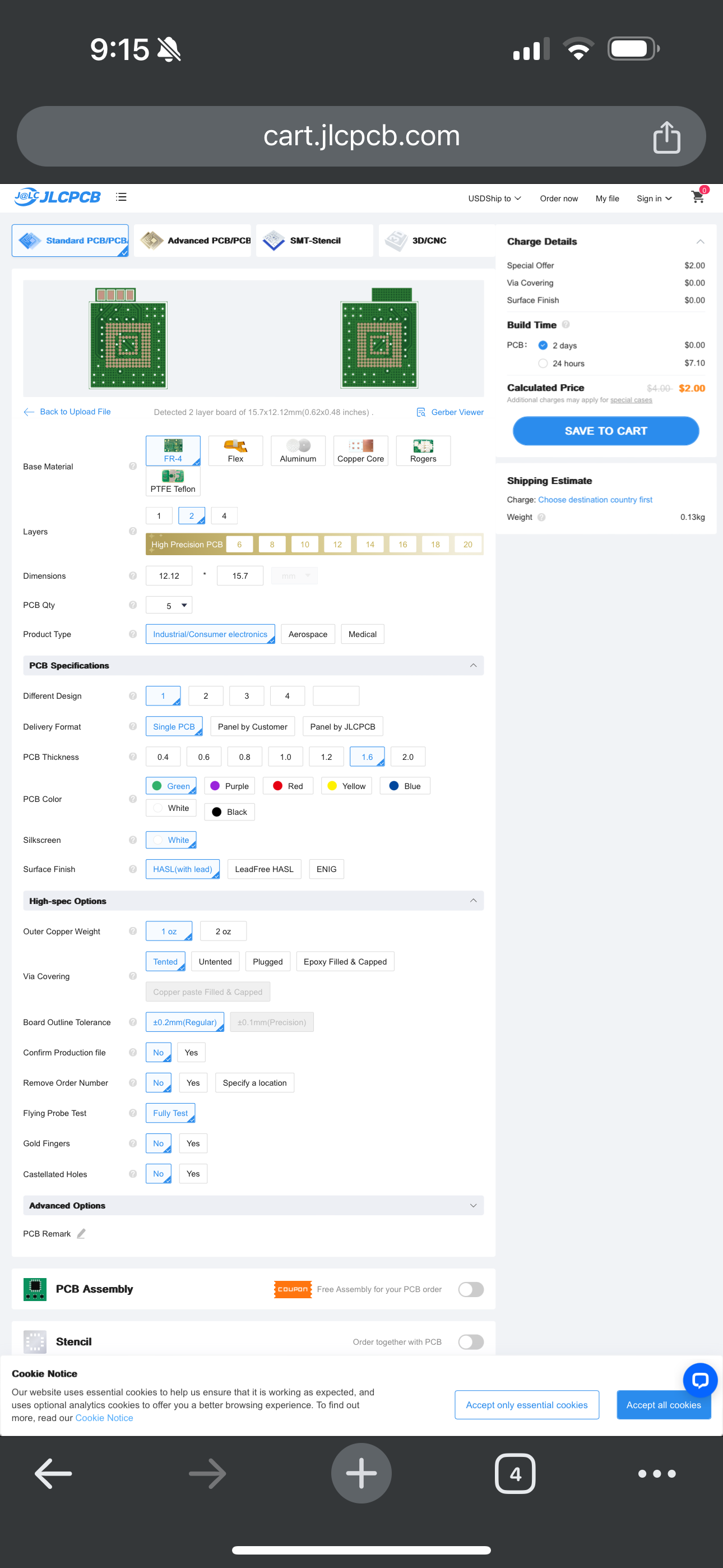

Great. Thank you! Do you know how many layers the board is? I’m assuming at least 2 right?
I’ve never done this before. Does anything need to change?
me neither,im also new to it and will order soon. i dont think you need to do any settings? pretty sure everything is in gerber files and it loads automatically. Right @abal1000x ?
