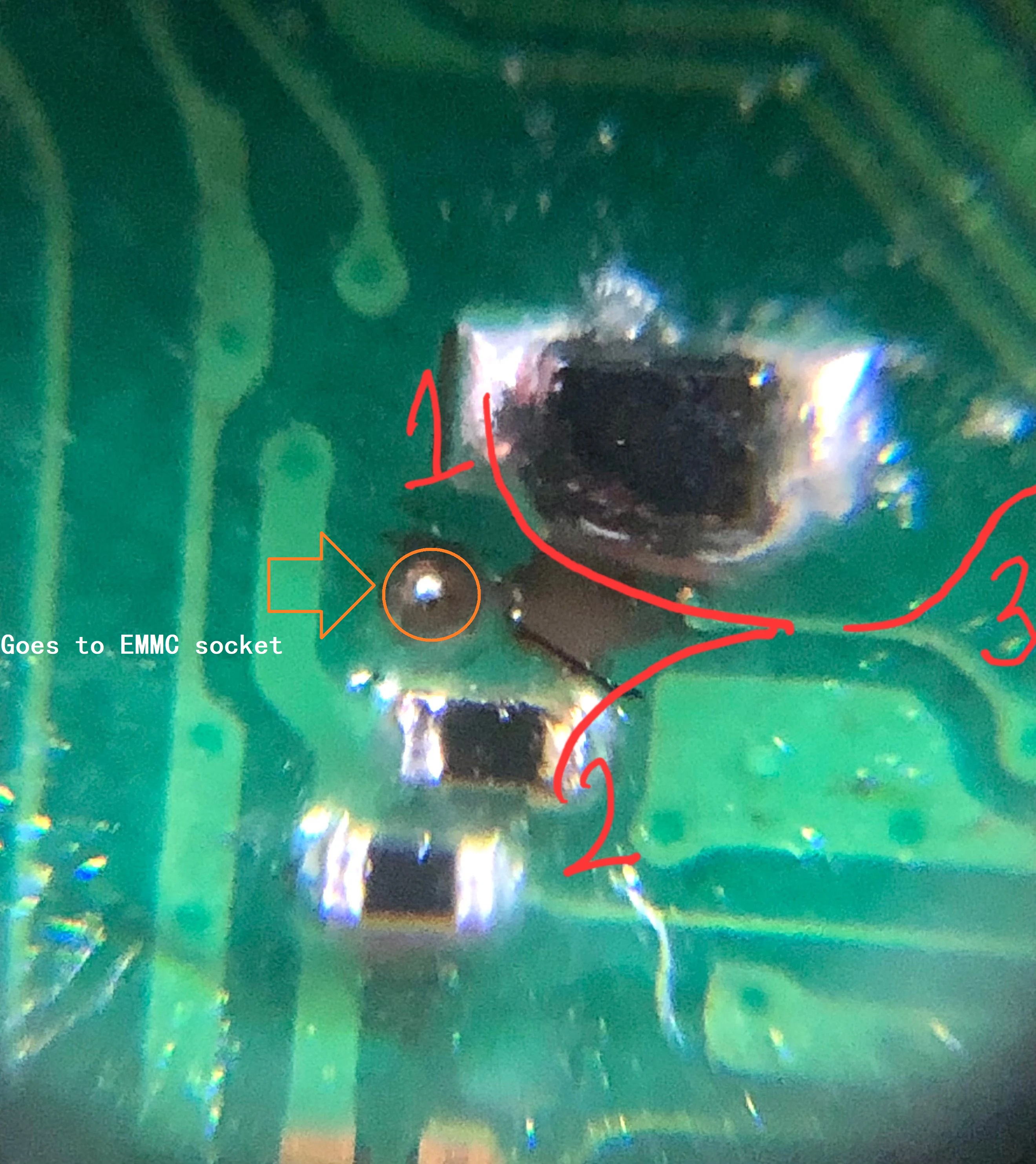

I messed up the RST point on my V2 board :/ Is there another place I can solder RST to?
I think that you need to fix that trace first.
CAREFULLY scrape the green solder mask as indicated in the photo with yellow marking.
Then you need to solder 4 wires (you can use same wire but it will be more difficult)
Wire nr1, nr2 and nr4 is to restore the damaged trace and wire nr3 should go to RST point in Pico.
The Diode in that point might also be damaged (I can't see clearly) but it's worth a try.
If you are not confident you can do this, take it to a professional before more damage is done.
*Edit*: post and photo edited to include correct information regarding through hole point (nr.4 in photo) provided by @jkyoho
Good luck
Then you need to solder 3 wires (you can use same wire but it will be more difficult)
Wire nr1 and nr2 is to restore the damaged trace and wire nr3 should go to RST point in Pico.
Good luck

Oh damn 🤯 that’s like an order of magnitude harder than what I could do 😑 no other way to do this? Get rst from another place and solder to these components?
You can but it will not be easier and I doubt that the switch will work without fixing that damaged trace.
But you are welcome to try, gotta learn somehow :D
The through hole via in Orange needs to join with 1,2,3 as well, other wise you need a jumper from EMMC soket pin2 from top to the 123 joint.
