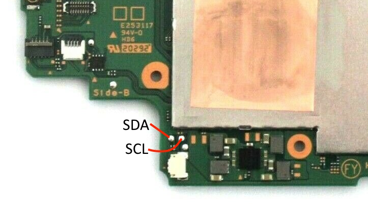

Waveshare rp2040: SDA=12, SCL=13
Pi Pico: SDA = 19, SCL = 20
XIAO 2040: SDA=3, SCL=4
ItayBitsy 2040: SDA = 18, SCL = 19
pinout for Mariko v2 board:
I have pinouts for Lite & OLED, but haven't tested it yet. You can easily track the i2c wires by yourself using board views here http://balika011.hu/switch/ (OLED here)
The firmware is in alpha stage, so use at your own risk
