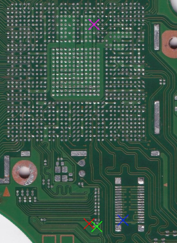

The through hole via in Orange needs to join with 1,2,3 as well, other wise you need a jumper from EMMC soket pin2 from top to the 123 joint.
My switch seems to still work normally (turns on and off and I can play games from eMMC) - does that mean I don’t need to fix those traces or is it necessary for the modchip to work?
if this is the case then you are lucky (and we here also learned a few things today :) ).
But I still think that the mod will not work, especially now that @jkyoho pointed out that the orange point goes to EMMC, and in your case the trace that connects APU and EMMC is cut.
See the picture below, all these points need to be connected
In your case you have a connection between Blue and Green and also between Red and Violet but you are missing the connection between Green and Red.
So you need to fix the line between Green and Red first in order to proceed.
Anyway, you could just try your luck and try to solder RST point to either RED or Green and see what happens.
Worst case scenario we all learn something new :D
