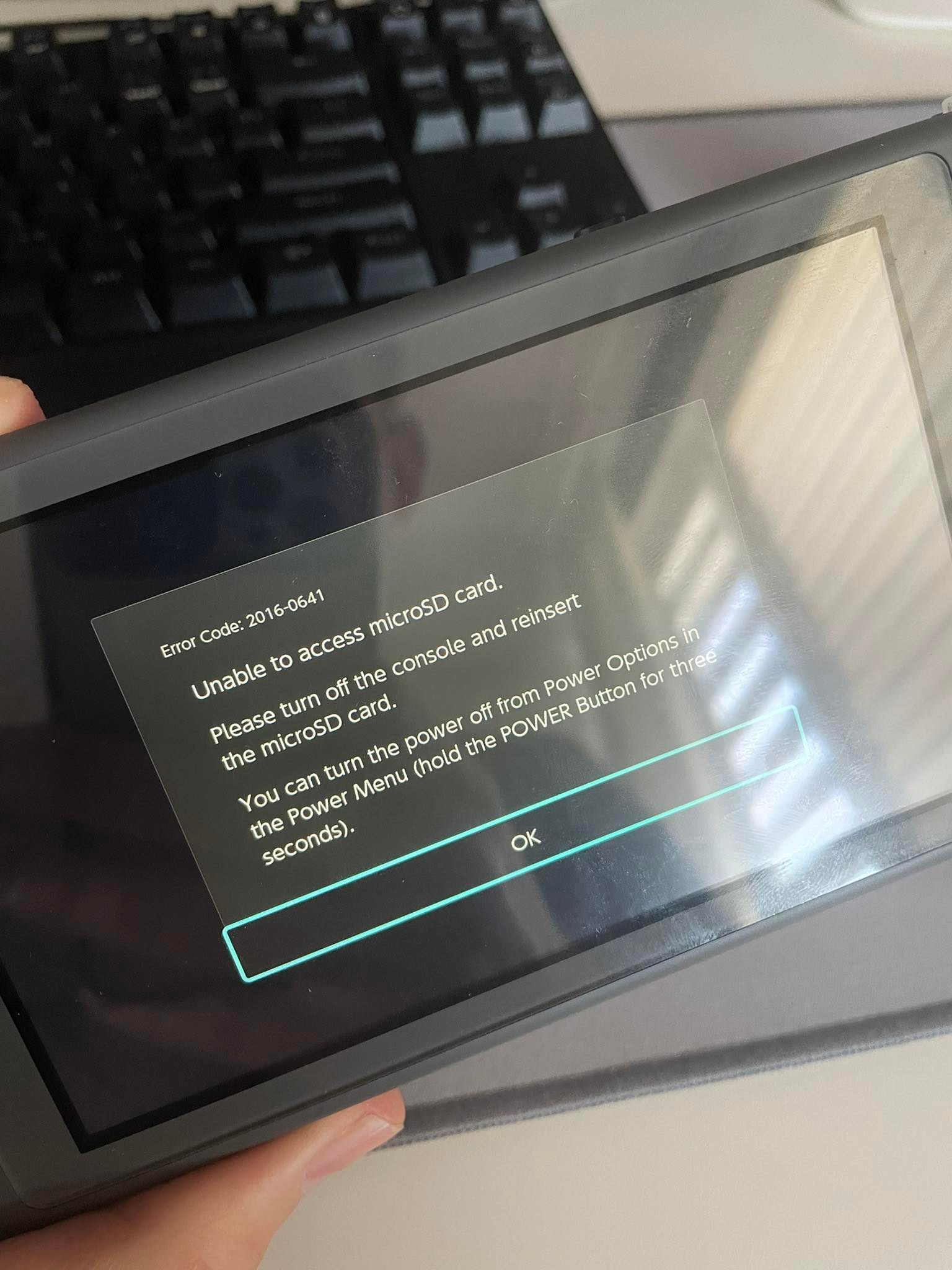

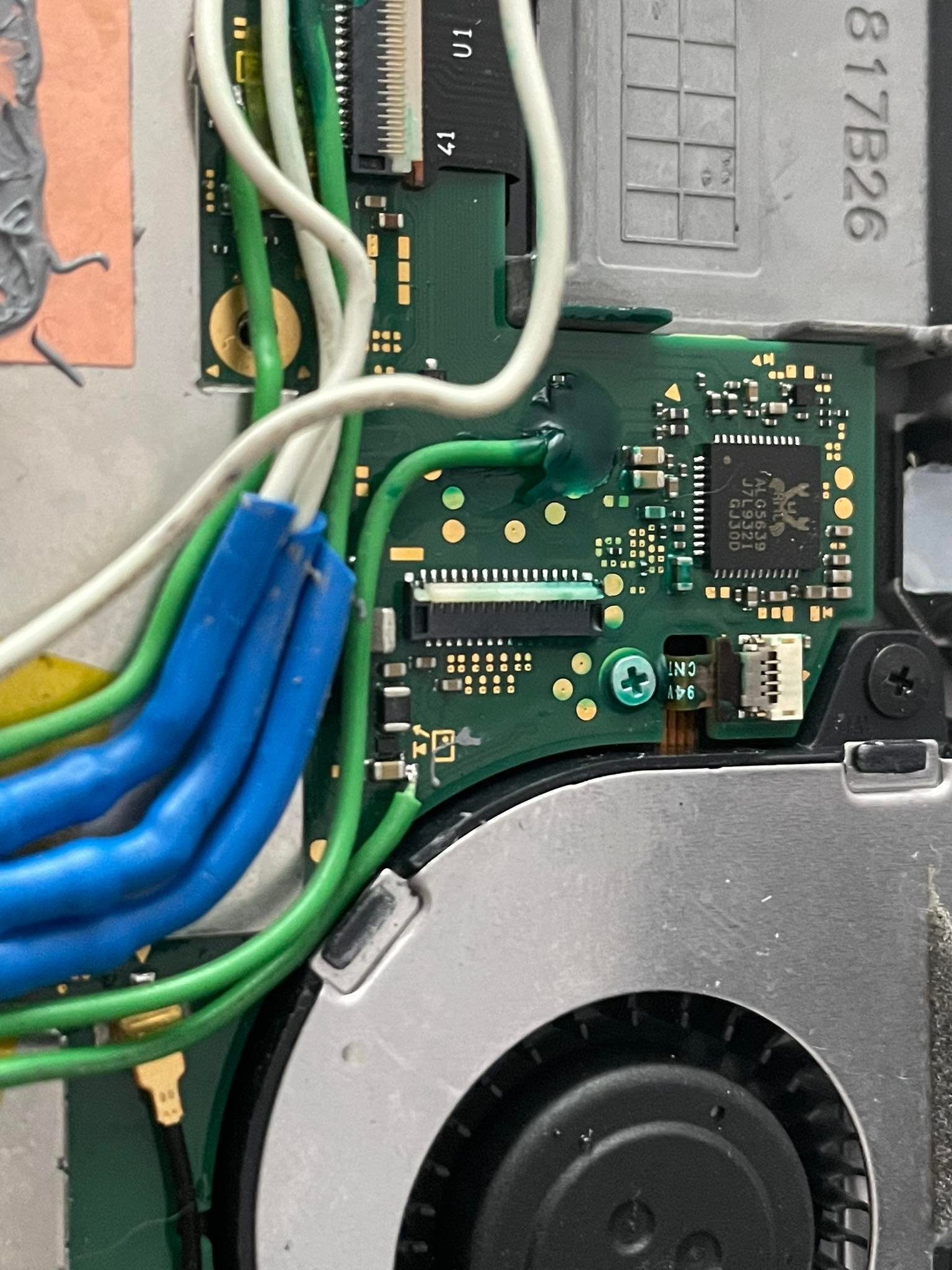

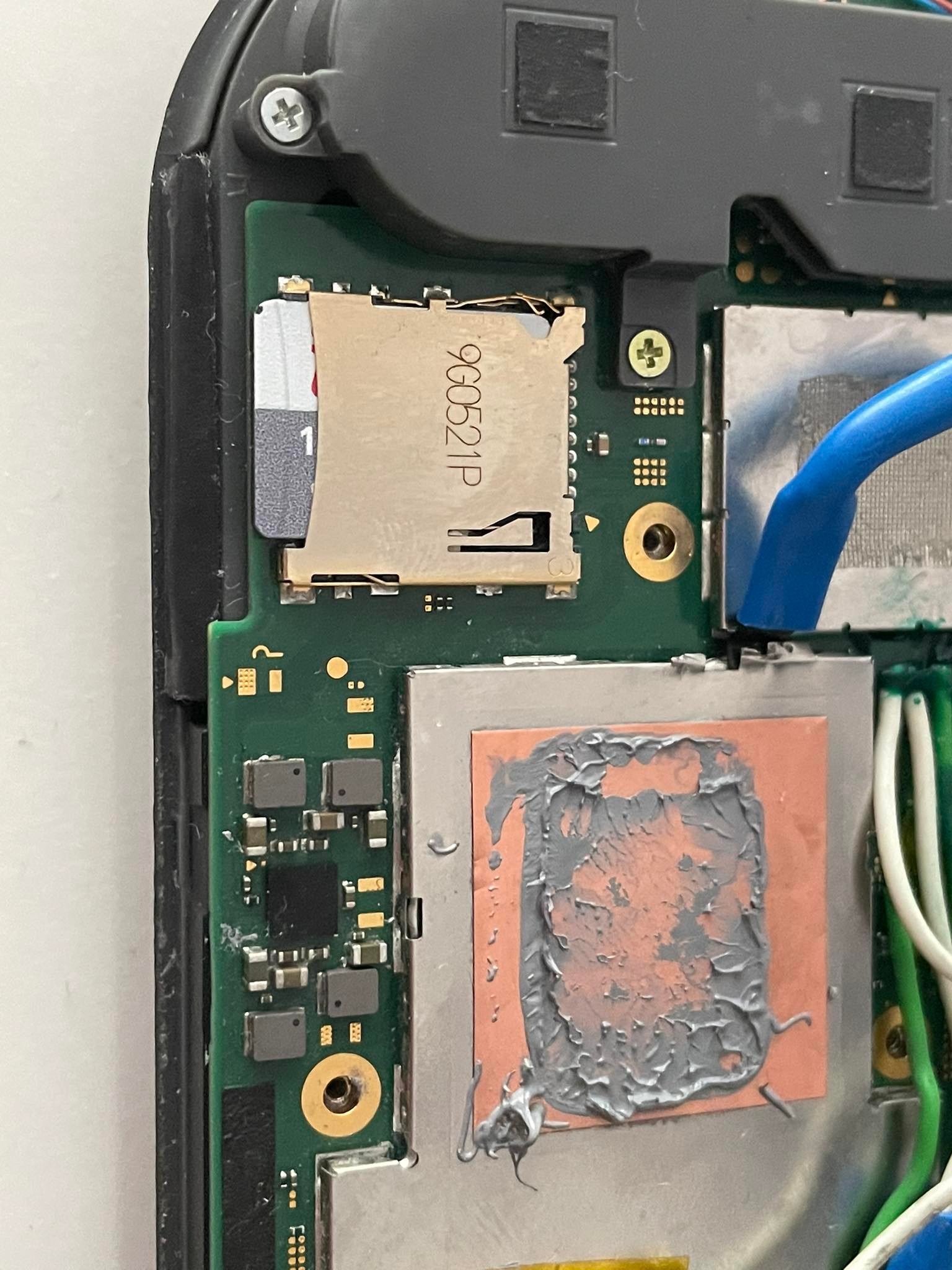

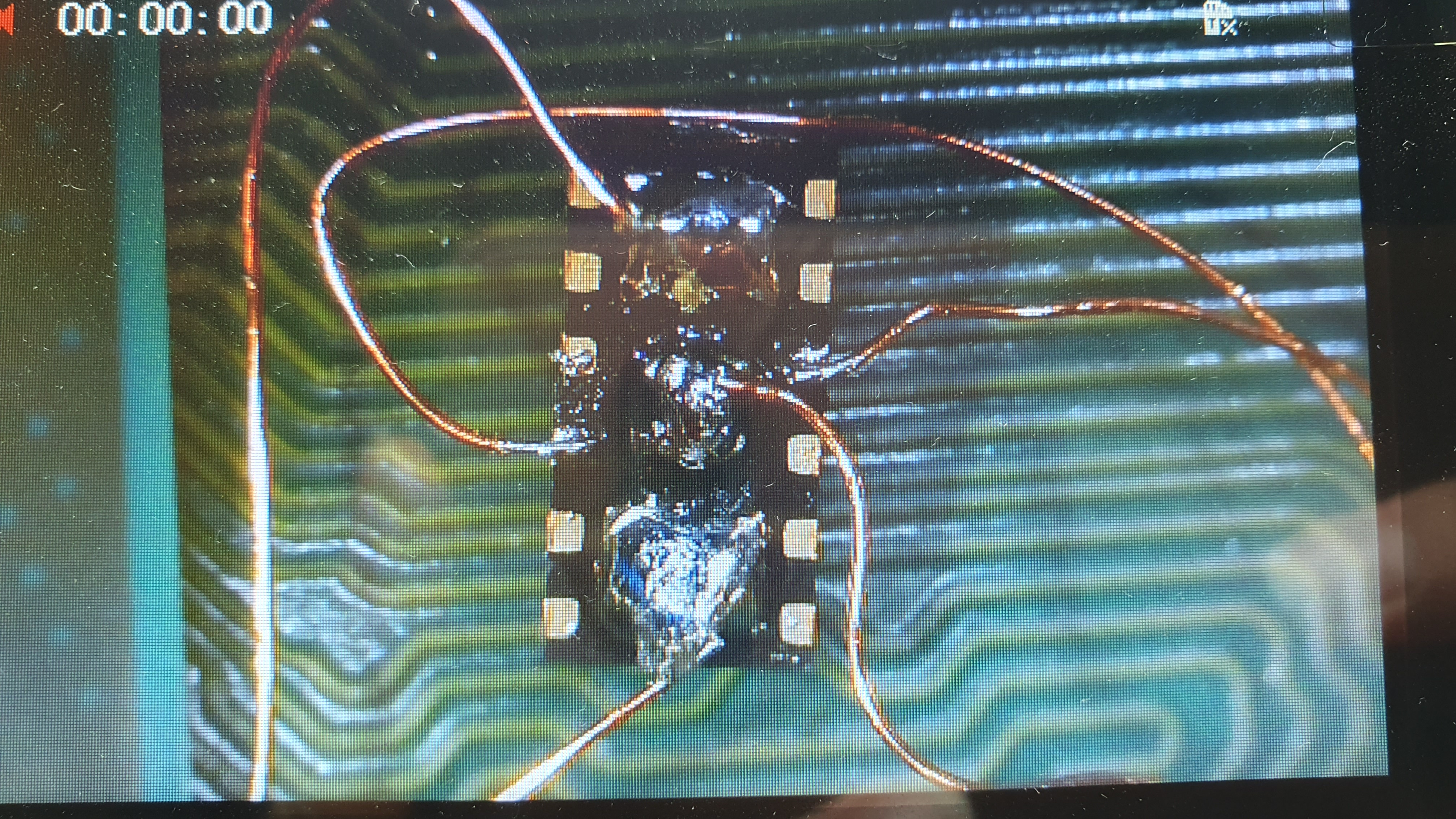

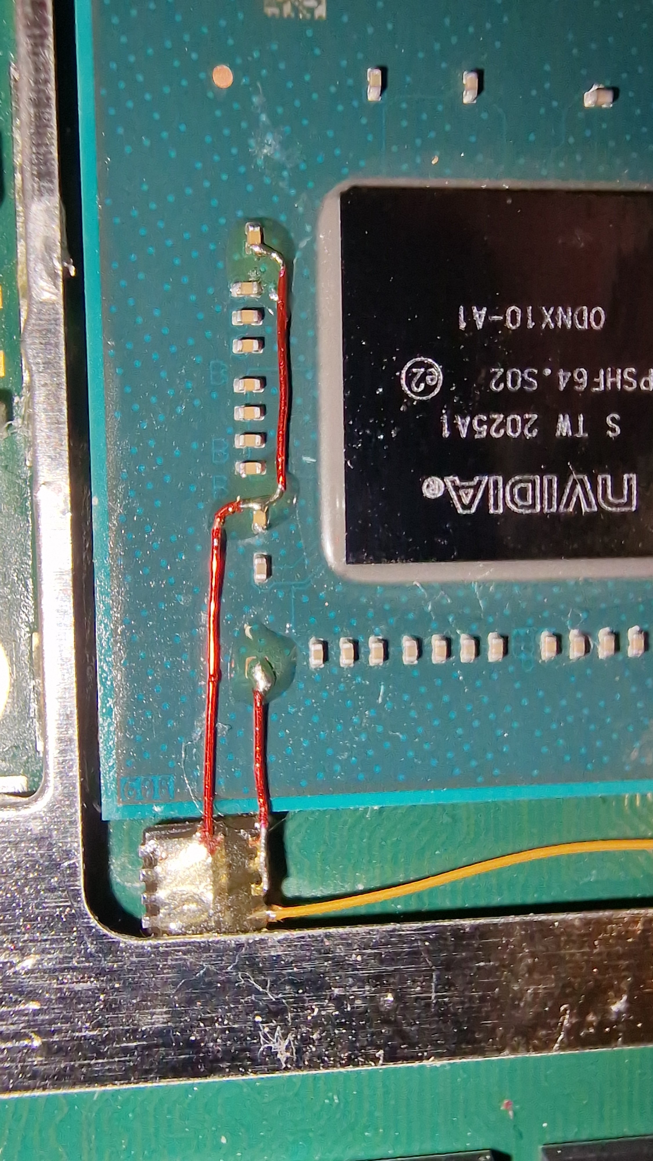

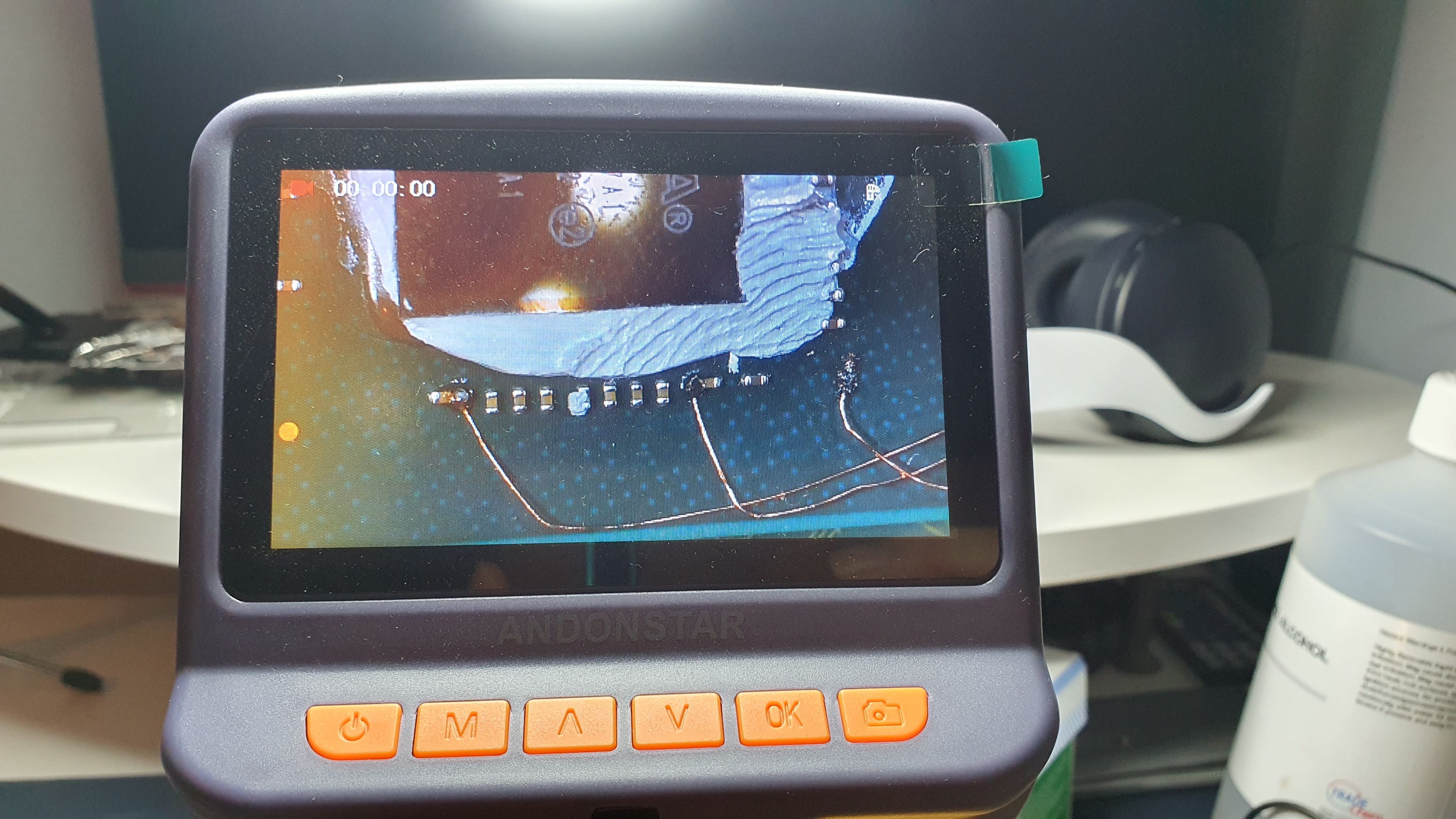

Hi all,
Could somebody give me some pointers?
I have done a shed load of lites, v1, v2 and oleds without issue using APU flex cables... however, tonight I thought I would have a stab at the mosfet thing on a V2 on 16.0.3...
It glitched and went white, then blue, the the usual green.
This time it just booted OFW???
It does the same thing everytime, no 'NO SD CARD' prompt at all.
Odd? Included photos...
I have followed the following diagram too...
Thanks,
Ant

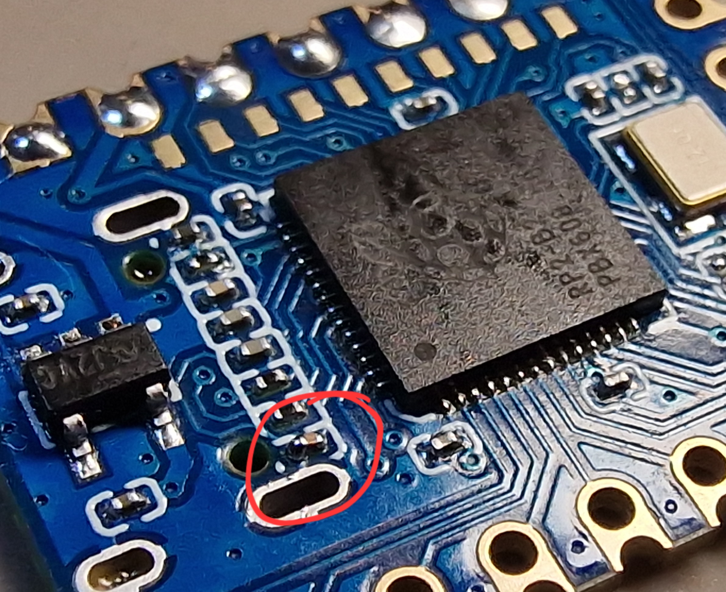

It is likely Cyan underneath the kapton (instead of green), but if you have a spare rp2040-zero, or can attach wires to that pico to reflash it, you could try Rehius' most latest 2.7 firmware that would help you diagnose your issue with long and short flashes.

Try using different 3v3 and GND (it worked in 2 cases)
Use thicker wire for 3v3 and GND.
Shorten all your wires (if possible)

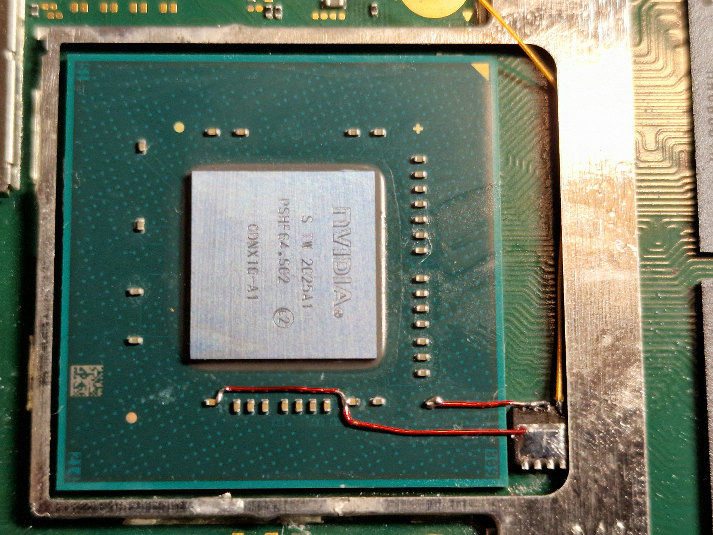

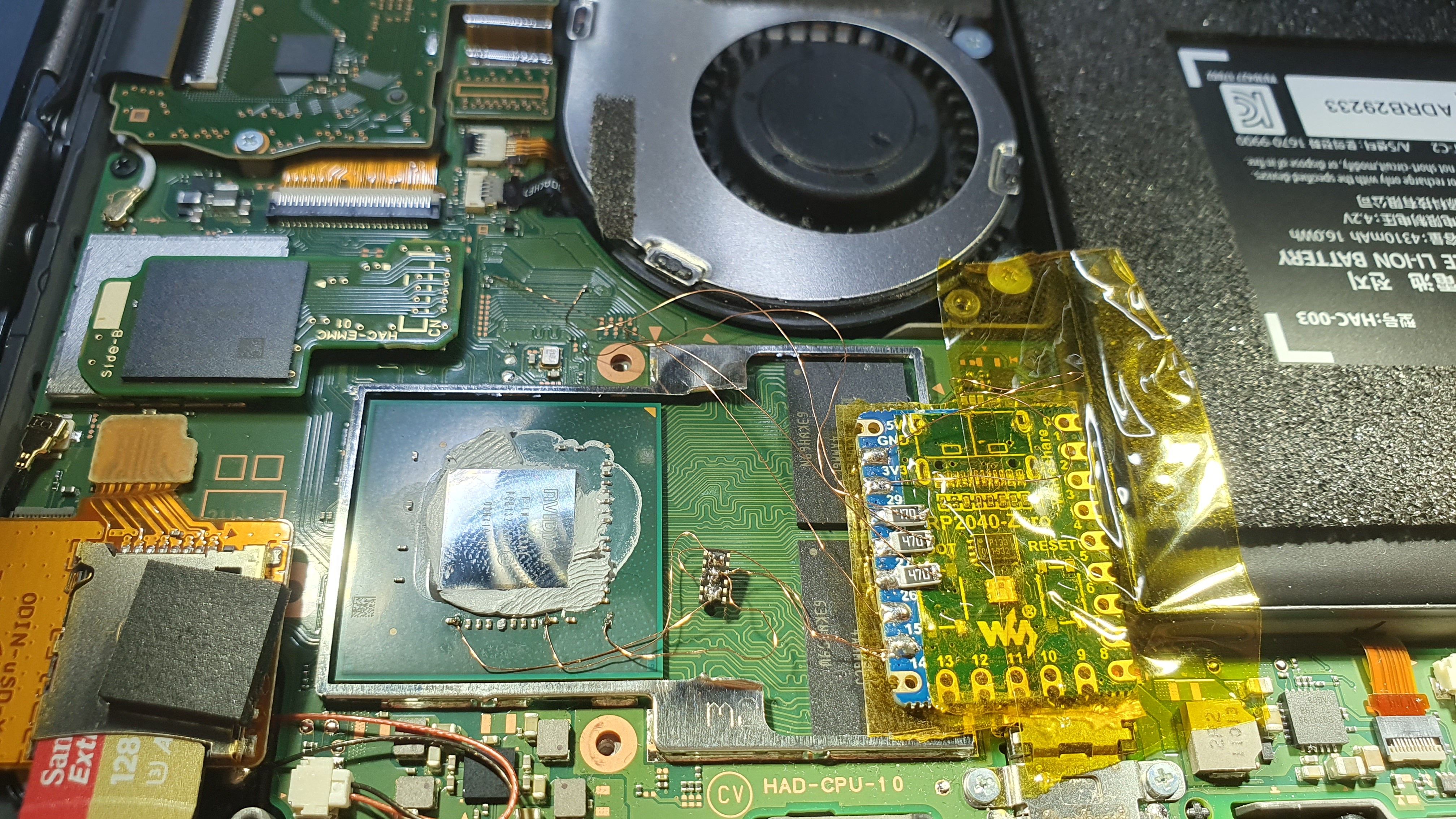

So, in the name of science (and mostly fun) I disassembled my Lite to try some other mosfet that I got today and to celebrate the release of fw2.7
The hard part (this time) was removing the previously installed SX Lite chip.
After removal and some cleaning I installed a single AON7506 mosfet which looks like it has the perfect package size (3x3) for these installations.
This time I used this new transparent (3 second curing) solder mask and it works as advertised.
I encountered a small hiccup while disassembling my picofly when I accidently wicked away a small capacitor on the bottom side of Pico.
Luckily I was able to retrieve it and solder it back (not very proud of that solder job but still…)
Also, the capacitor on top of the SDcard is damaged, but that was from my SX installation more than 3yrs ago. I don’t know what that cap does but I never had any issues with Switch, and even after removing the old chip and installing Pico everything works.
In the end everything worked out great so I didn’t get a chance to test the new “pulsing” error codes.
There are a couple of videos and photos attached where you can see flashing, first boot/glitch, 5th boot (after assembly), and also the assembled shield with Pico underneath (perfect fit).
Cheers
Cheers
Is this the same mosfet which you used or not?. I want to order this because it is bigger and will be easy to handle while soldering.
