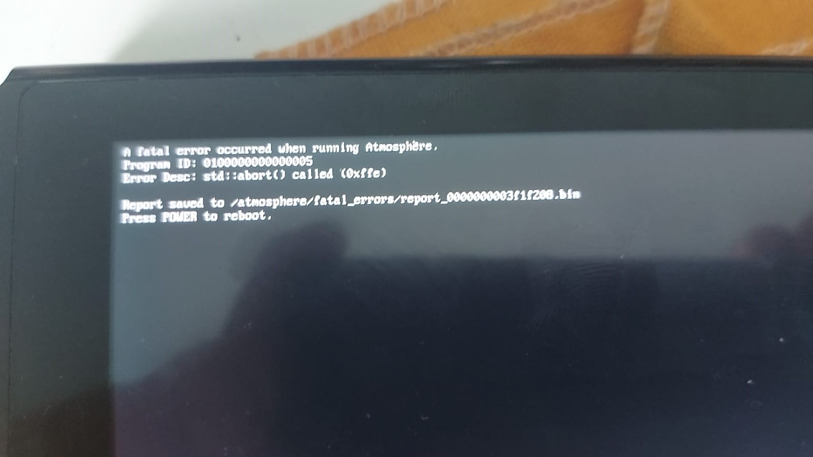

hello everyone, I did the whole process of installing the emunand chip, but when starting the environment I get this error, does anyone know a way to solve this?

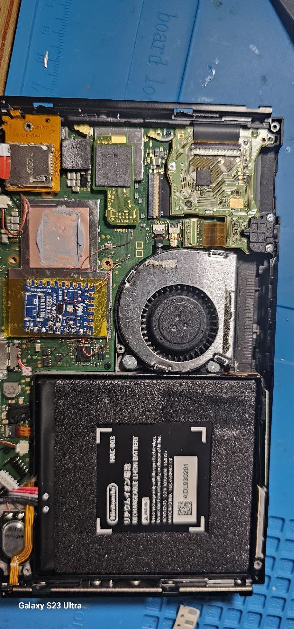

Anyone knew what issue will be if the caps on red is not installed, as i missing it when cleaning the point.
Install is success and in fact now my kids playing on it. Only issue is touch screen is not working, it was working before of course. Any clue?
Thats pin six of m92t36 which is vsvr 3.3v the cap is a decoupling cap 1uf or 2.2uf it wouldn't stop the touch screen working Pin five next to it is vccin 3.3v I believe pin 5 and 6 are to do with voltage from battery or mainboard

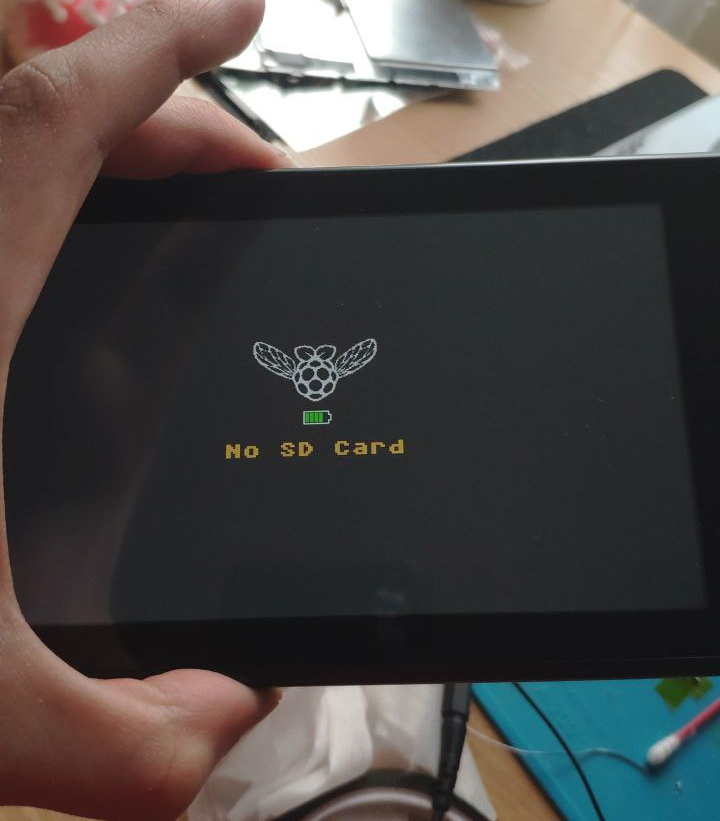

hello all, do you know what is the problem with this swich v2? it cannot boot cfw and ofw and shown as the picture below.
thanks.
That error code Ive had with a batch of fake m92t36 chips from aliexpress.
As you soldered the 3.3v and ground to it I'm guessing it must be a fault with the chip or the soldering around it check for shorts around it
