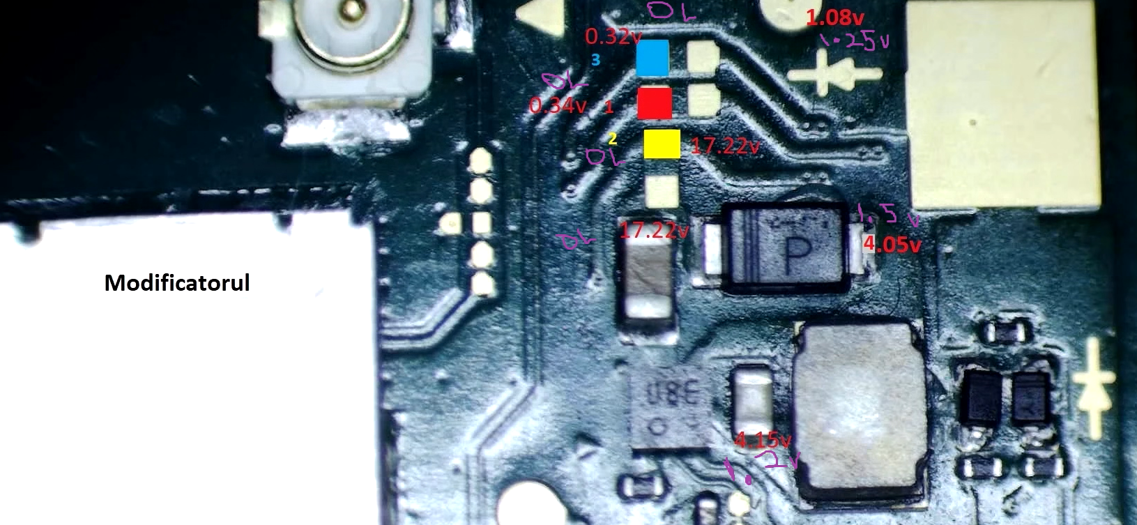

Sorry to bother you, is it possible to check with you what the daughter board does?
I accidentally damaged the ribbon cable from the main board to the daughter board. Now my switch lite does not turn on. (No sound, no display, nth) But the motherboard shows power when I press the power button @ 3.3v pt.
(Tested this with the picofly)
Could that ribbon cable to the daughter board be the issue or it is smt else?
I refer you to an earlier post I made, helping someone else with the same issue.
Try troubleshooting using this post
https://gbatemp.net/threads/sx-lite...he-screen-doesnt-turn-on.571362/#post-9172025
I had a similar issue when hacking my gf's switch lite, and though nothing was obviously damaged upon visual inspection, one of those points didn't have continuity for me. I run some magnet wire between the two that weren't connected and it brought the screen back to life.
Hi, my values are very different. For 1,2, and 3 are OL. The capacitor directly below pt 2 is also OL. The component with
is 1.5V -> 1.8V -> OL. The capacitor below
is 1.2V -> 1.8V -> OL. Lastly, the diode pt is 1.25V.
The values are the same with/without the ribbon cable from the motherboard to the daughterboard. There is also connectivity for pt 1,2 and 3 b/w boards.
Thank you for your time.
It looks like your first photo is of the LCD connector. The connector the points in your second photo are connected to should be located on top of the switch lite battery connector.
Yep I did took the voltage from the one above the battery connector. I mean I saw that the previous post posted a photo of that so I did the same.
My values are very weird. Even when I measure at the exact same points.

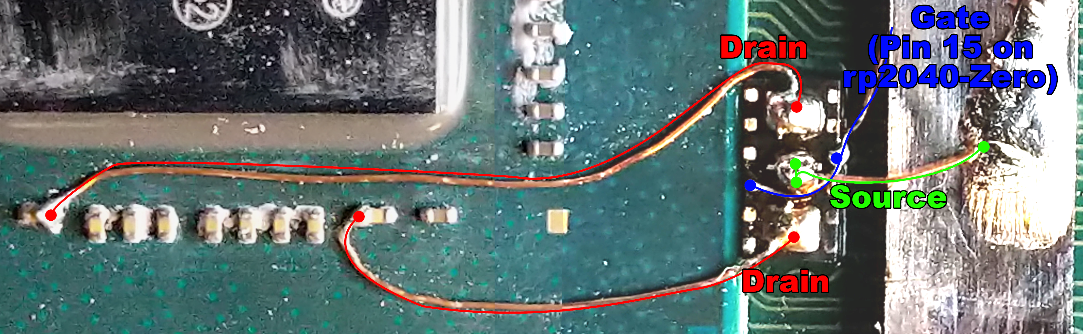

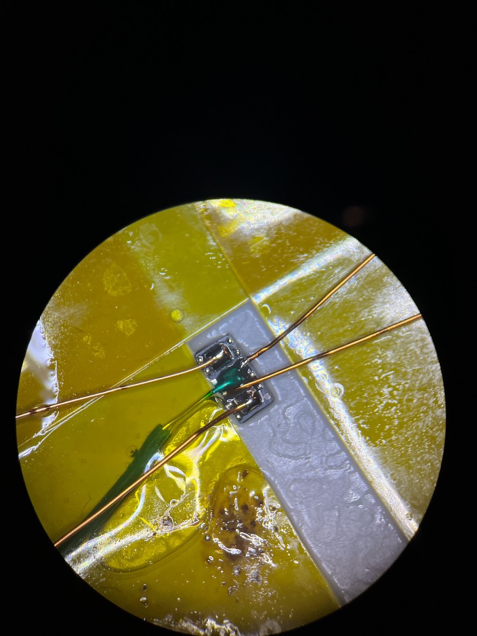

Just received my resistors, so I'm slowly going through soldering it all. Is it okay to solder the two mosfets together like this? I don't see why not, but resistance of the wire could maybe affect it?
Here is a composite image I just took of a double mosfet install I am doing on a switch lite. The circles are the general points of interest and where they need to be hooked up. I jumpered between the gate pins on the mosfets and ran a single wire to the rp2040 to keep wire clutter down, as has been suggested previously.
Here is one of my installs doing almost exactly the same thing. I just combined both the gate pins onto one wire.

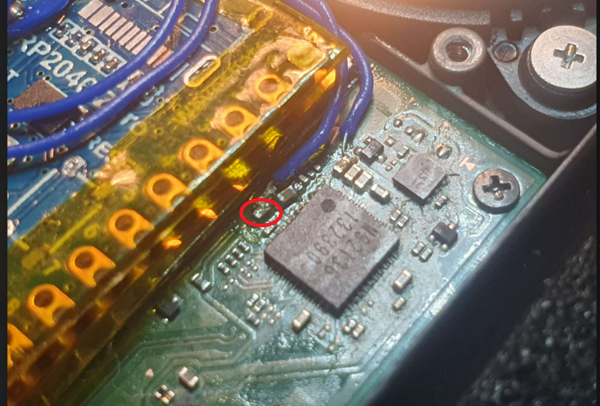

Anyone knew what issue will be if the caps on red is not installed, as i missing it when cleaning the point.
