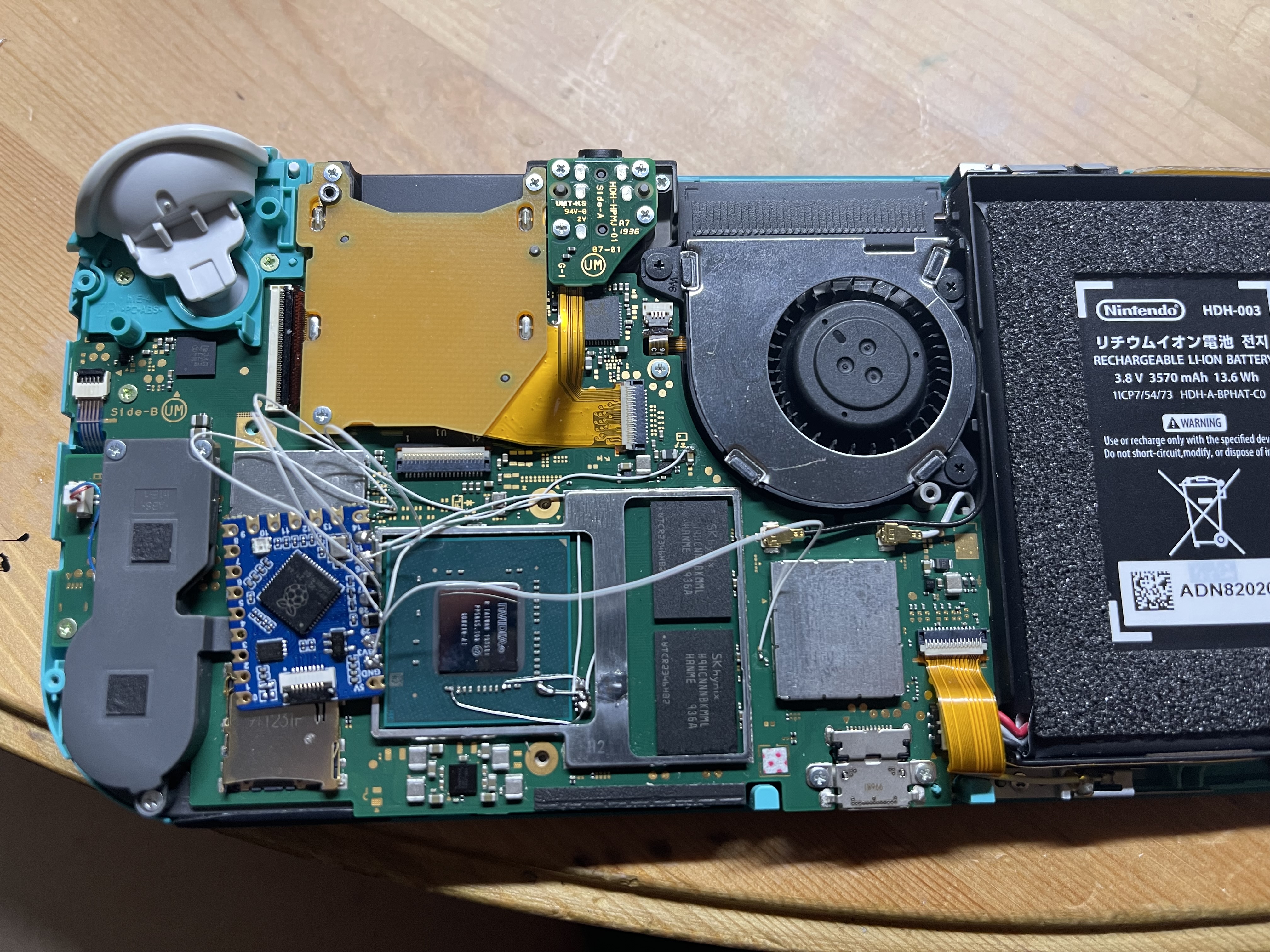

Well it's done, with huge success.
First picofly install for testing in my own switch lite. I preferred make myself the mosfet glitcher. The soldering process is painful, same in microscope.
I was in doubt if was better start the installation test in my v2 or lite. How is basically for learning, I guess the micropoints solders of lite are a good teacher about difficulty with micro soldering. Next phase is try a oled installation from zero, included homemade mosfet glitcher
I confess: the micropoints of switch lite board for clock/cmd/dat0/ dive me in a frequent conspiracy about shortcut. I was made the soldering points near of 20 times, to certificate about the things are completely well done.
congrats:toot::grog:
those mosfets soo tiny yep
i give up with 8342 hehehe, frikin tiny for me.

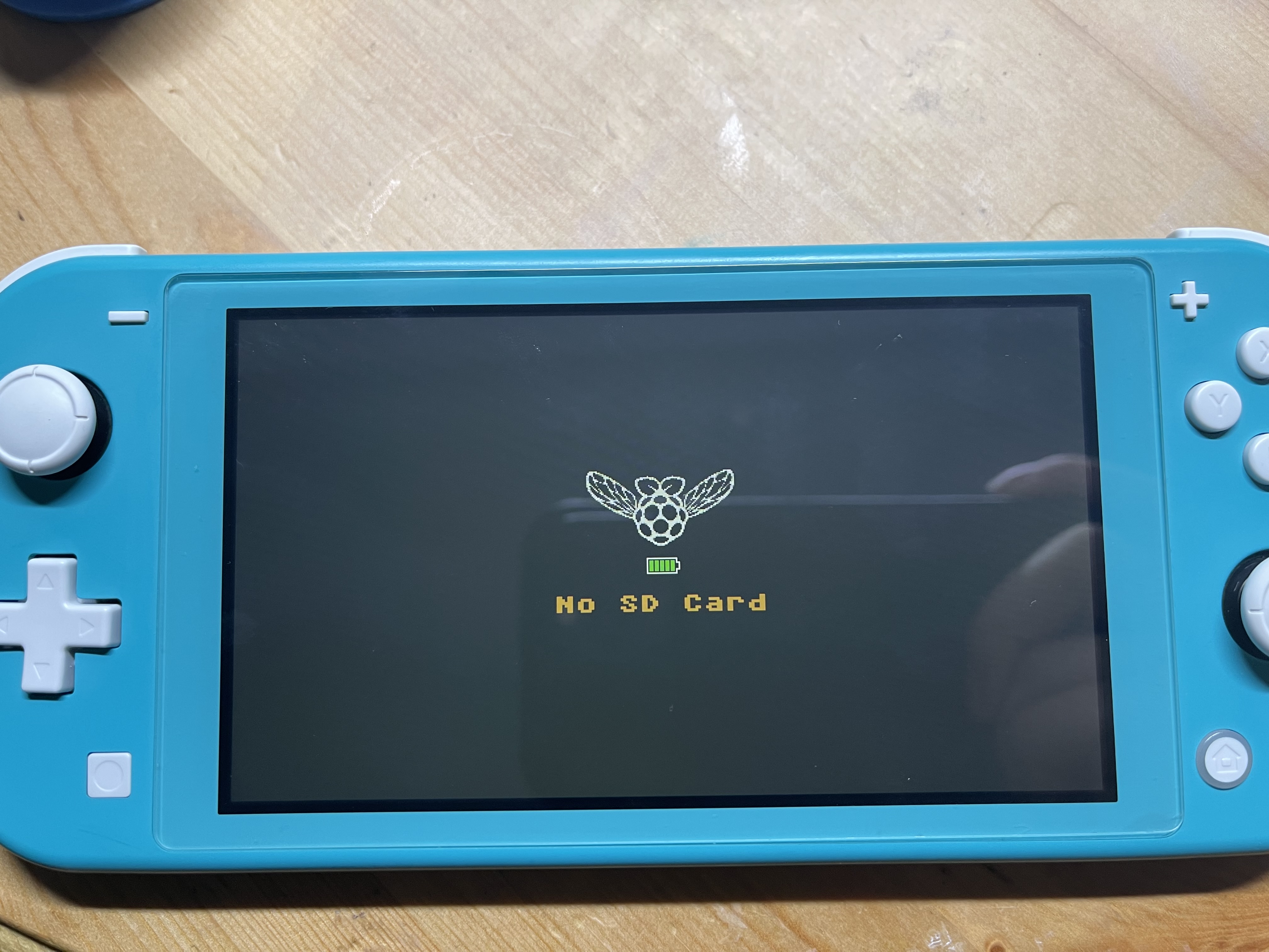

I've just finished my picofly installation. Now im struggling at this screen. What should i do next? Or where i can find some guides? i have 128gb samsung microsd card and have no idea to do with it.
congrats:grog::toot::switch:

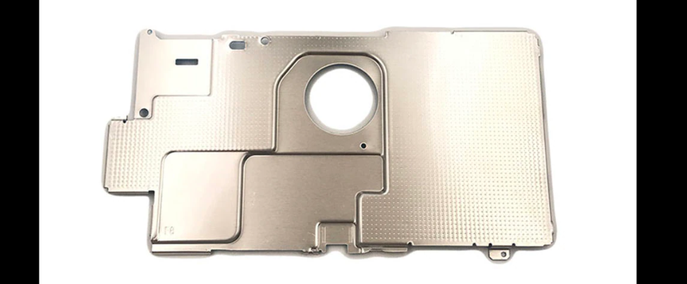

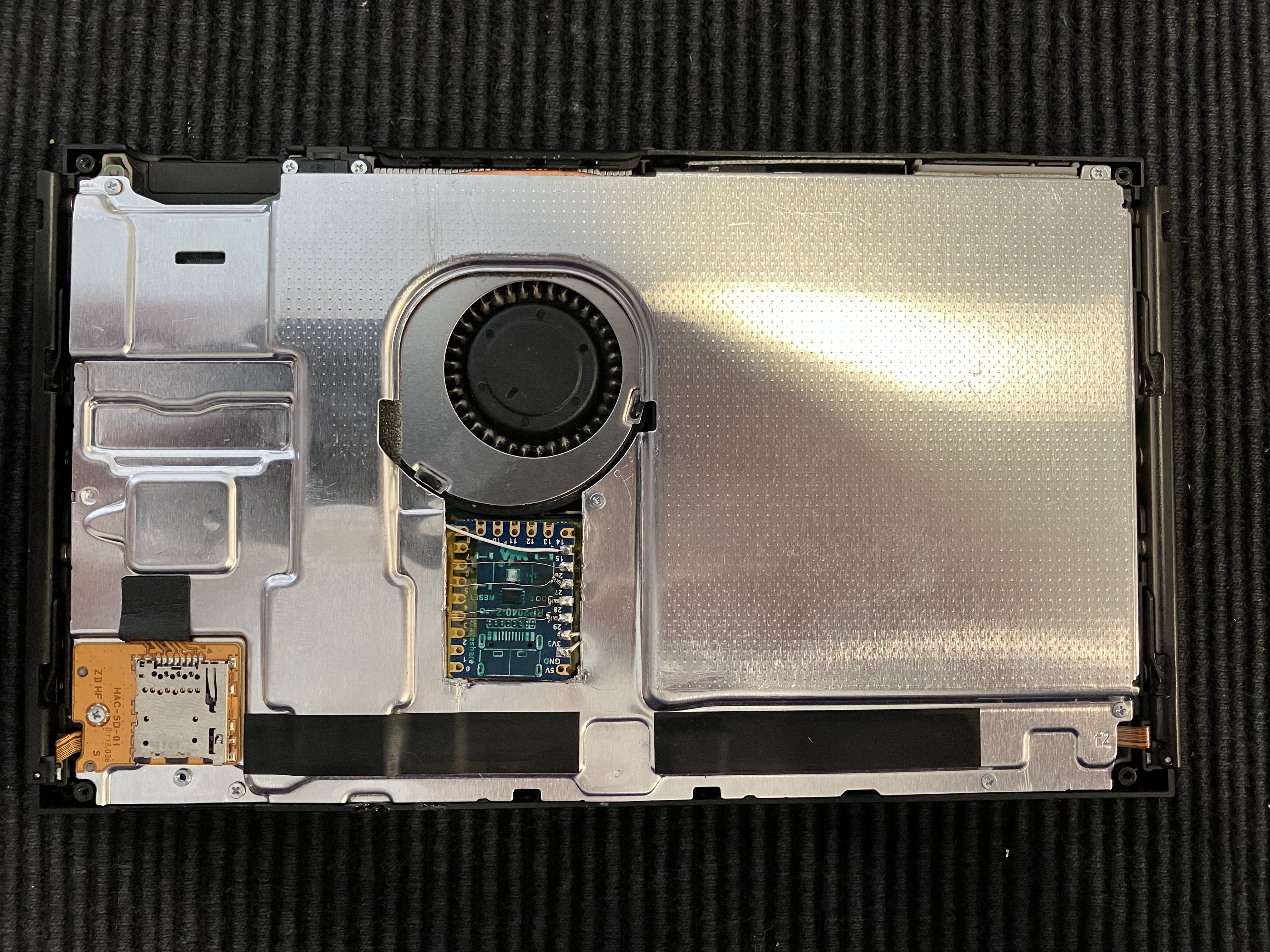

btw how the RP2040 Tiny fit with the metal heatshield??
is it fit perfectly ?
since the RP2040 zero need to remove port usb-C
how is it compare to RP2040 Tiny ?
It fits pretty well under the heat shield. I used double-sided tape to place the Tiny on the EMMC shield below the heat shield. The Tiny has a low-profile FPC connector connected to a USB adapter board(it contains USB TYPE-C female socket, FPC connector, Boot, and Reset button). Also, the backside of the Tiny board is a flat surface.

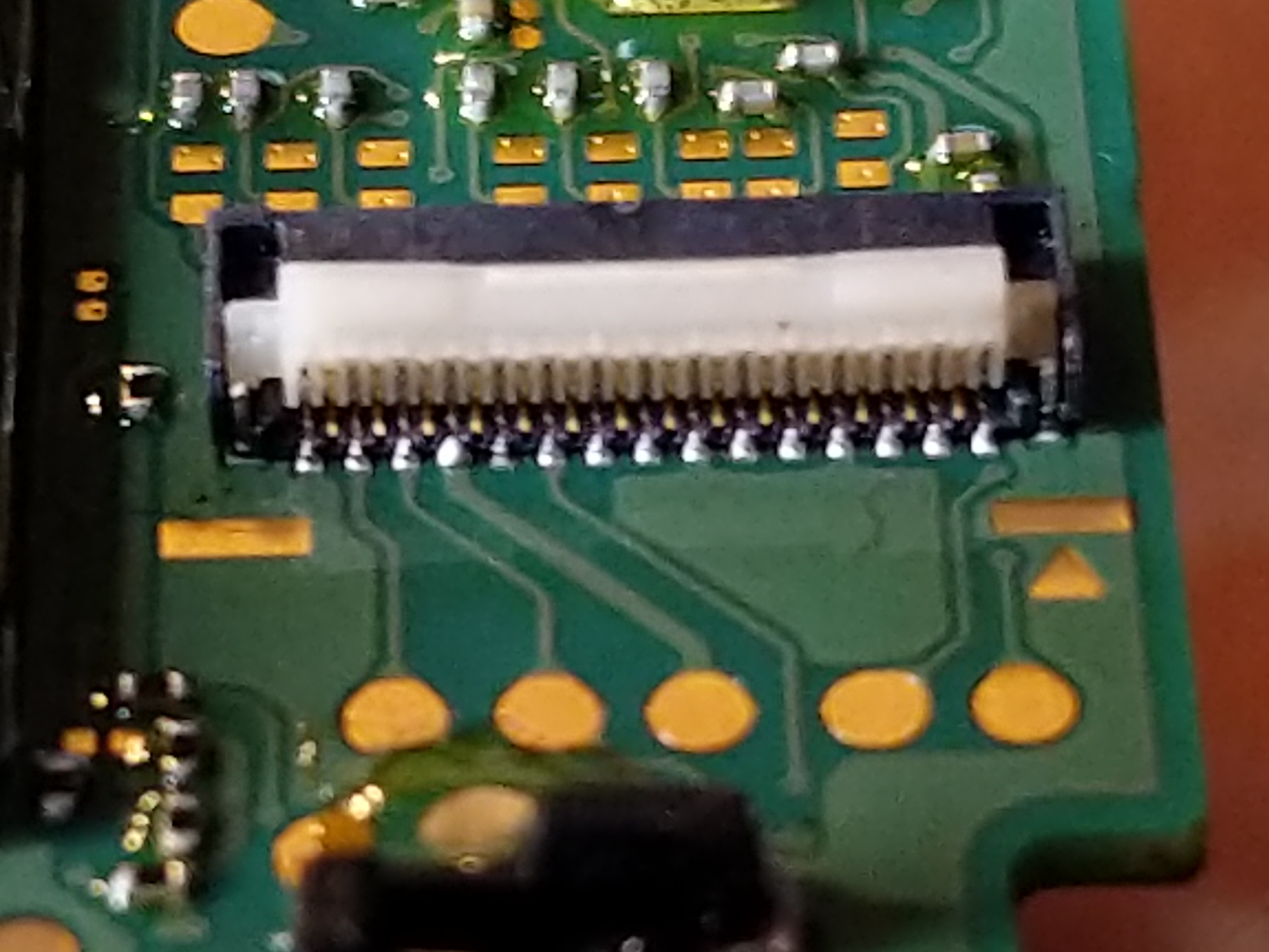

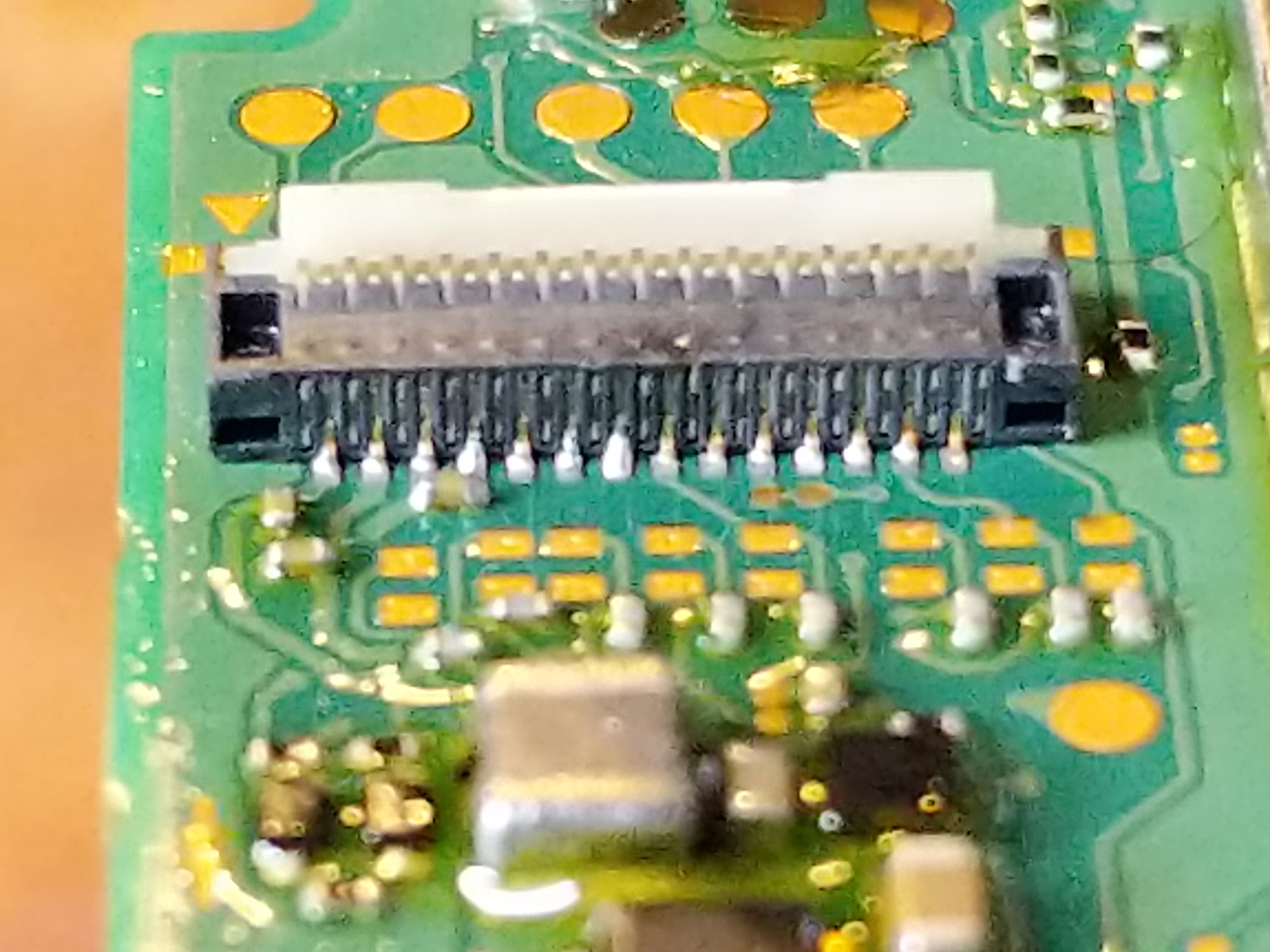

Just finished up my fourth picofly install, third switch lite. Technically this mod was done before the second switch lite, but I mangled the daughterboard connector from opening and closing it too much.
Thankfully, the connectors are available online from parts repair stores, so I ordered two and attempted the replacement myself with a lot of flux, a hot-air station, and at the recommendation of a youtube video I watched, I heated the bottom of the board to remove the connector and place the new one. I didn't get super large solder blobbing on every single pin, but she boots with a live and working screen plus touch and left joycon control!
I have a few more switches in the pipeline for friends that I plan to mod with picofly, but it will be a little before that happens. The next install is likely going to be a roadtrip with my tools to a friends', to perform an install in his living room with him present lol.
Frontside of the connector after replacement
Backside of the connector after replacement
