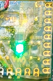

There is a hole in kapton, but light is definitely cyan as it's not working, I tried to add 20k resistor on rst and nothing changed, except ofw stops working(without resistor it's loads fine). Well, then will try to solder two mosfets, as i resolder one around 3 or 4 times already with same result.
You can also try a different mosfet like IRF8788, IRF8714. they are bigger and they would eliminate any doubt you might have with soldering on those points.

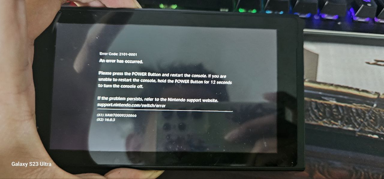

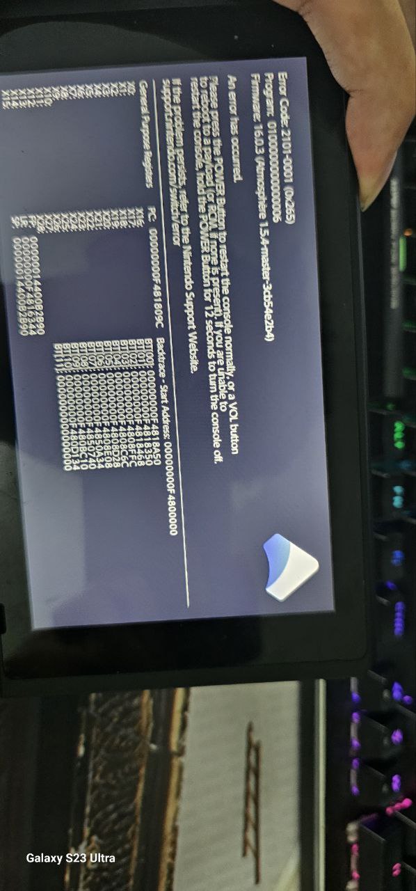

hello all, do you know what is the problem with this swich v2? it cannot boot cfw and ofw and shown as the picture below.
thanks. View attachment 371486

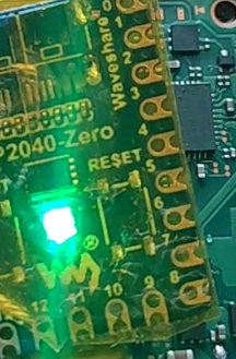

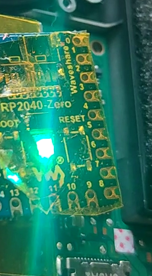

At first I'm using 0.1mm wires which worked on my previous switch using picofly but on this switch I have to switch to 0.25mm coppwr enamelled wire and two mosfet. Because on one mosfet it show blue and than Cyan. But with two mosfet picofly shows Green light after Blue but proceed to OFW. Or is it because I'm using a long wire for a CLK, CMD and Dat0 ?

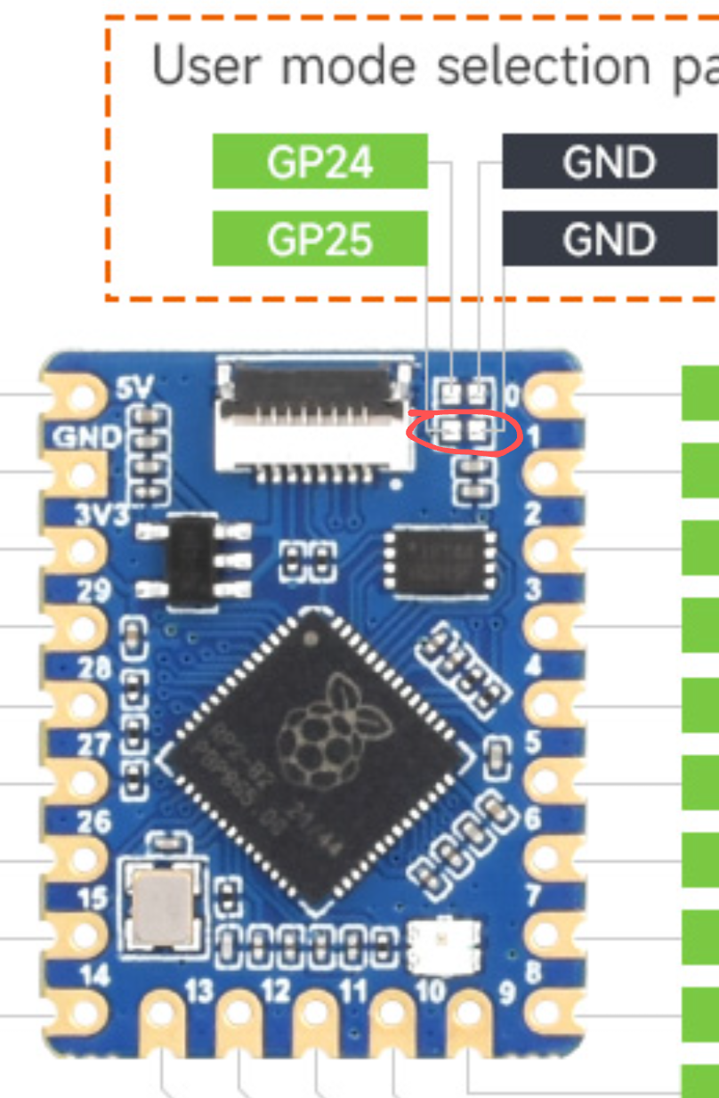

hey guys any of you have use the waveshare rp2040-tyni , im looking for the rgb point , and a review of how good this alternative fits on the v2 switch . https://www.waveshare.com/product/rp2040-tiny.htm
According to the Waveshare website, shorting the pins inside the red circle should be the same as shorting the "RGB/BGR" pins on the 2040-Zero
Also, you won't find many people who have installed a Tiny yet, let alone wrote a review yet, because it JUST released AND has backorders due to the mistake they made with resistors.
