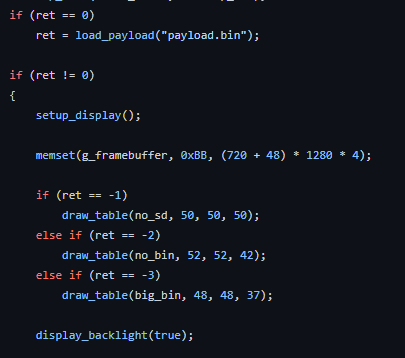

Also btw I took a look at the sdloader payload that does the misconfiguration, it seems to only run the code to route 5v wherever if it fails to load a payload off the sd card, so it's not as big of an issue as it initially seemed (still should probably avoid using it though).
(edit: setup_display leads to display_init, which contains the offending code)
i tried to run my oled for a while without sd card and only black screen appears... can it damage my device? and after restart and i put back a micro sd it work normal. also is same thing between "fails to load a payload" and run switch without an sd card?
So will this problem linger after powering off if it were to be booted without the correct payload file on the SD card, if it was ever booted without that is it messed up afterwards? Or after a power off and then with the correct payload in place it wouldn't load the code that sends the 5V where it shouldn't?
So if my switch is already correctly setup and working, as I never intend to actually switch it off, just rebooting to go from cfw to ofw and back, there should be no further risk so long as it correctly reads the payload on the very rare occasion it will need to? That'd be quite amazing if so
God bless for this find. Should teach people to be extra careful and read the guides more carefully now :P
If you were to boot without an sd card and it survives, then you do boot with an sd card, it wouldn't linger
yeah

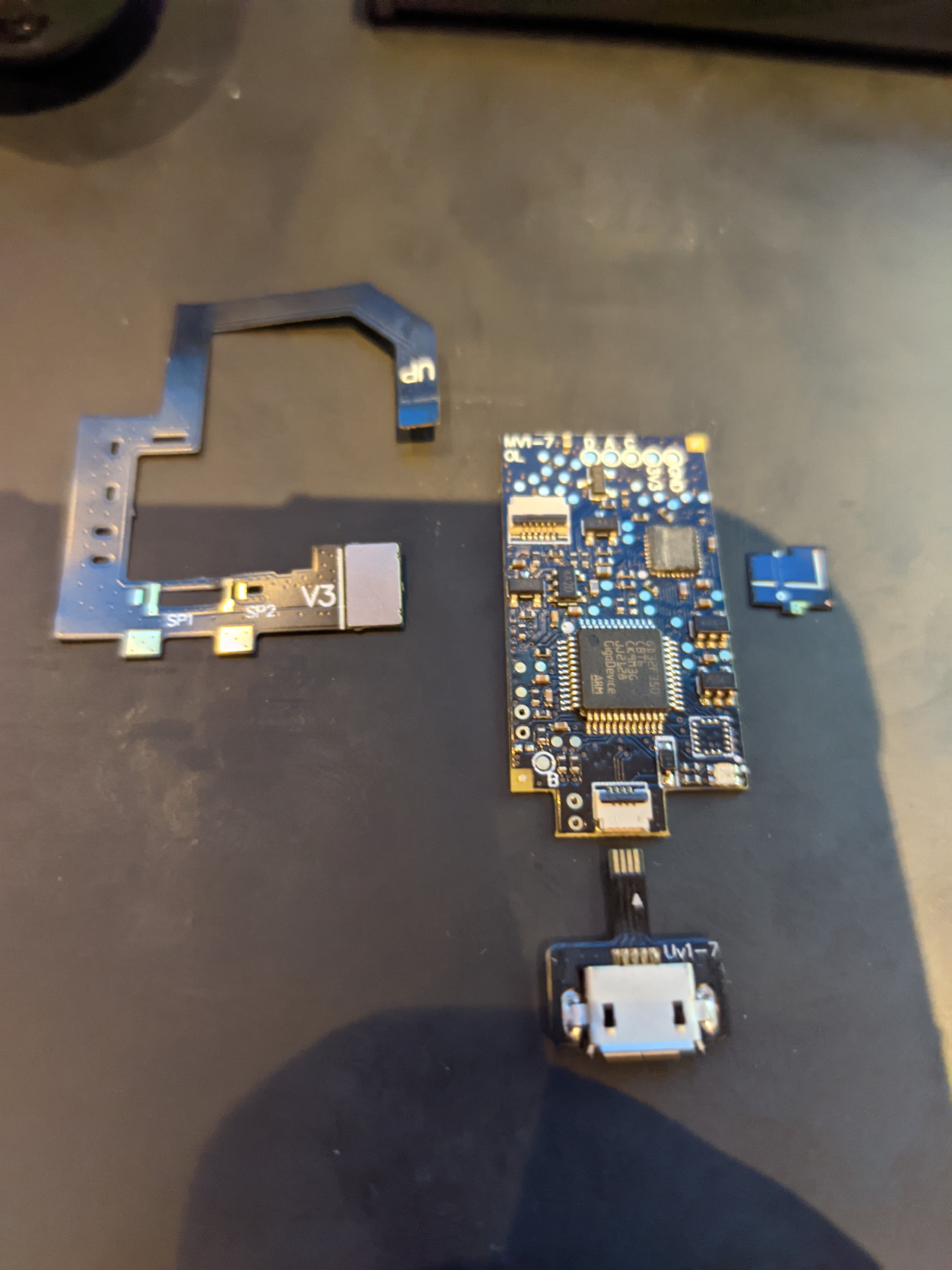

For the arch flex chip, does anyone know (beyond an educated guess) which way the USB connector faces? It says "UP" on one side, but based on their behaviour before I wouldn't rule out the possibility that they have that on the wrong side. This is the chip I'm referring to:

For the arch flex chip, does anyone know (beyond an educated guess) which way the USB connector faces? It says "UP" on one side, but based on their behaviour before I wouldn't rule out the possibility that they have that on the wrong side. This is the chip I'm referring to:View attachment 293291
Flip it over for the way you have it in that pic so it says up
Yes, opposite from how you have it
Interesting you can see the GD32 chip code, on my HWFly core you cannot see that on my locked out HWFly as it has been laser etched off.
