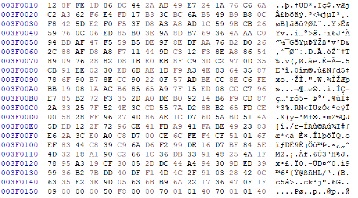

Dump BOOT0
Check it on application

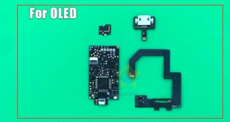

Hello guys!
I recently ordered this modchip from Aliexpress. It's an OLED specific one so should be fine?
Does anyone know for sure and/or has checked what it comes with?
Thanks!
if you ordered the one with white background (no usb debugging port but with a new ribbon cable) from Taobao, I’ve just got a clarification from their tech guy on YouTube it uses spacecraft v2.
That's good to know thankyou. I ordered it from AliExpress but I guess its the same thing. Have you got a link to the tech guys YouTube channel please? Just so I can keep up to date on things.

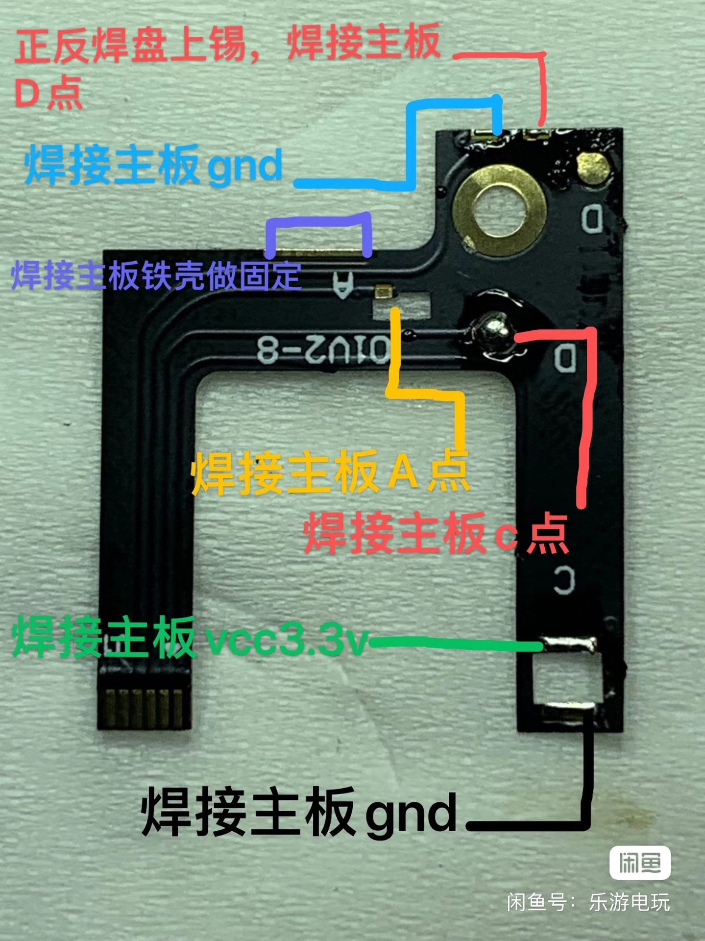

For those who are interested in the ribbon cable come with the no usb version oled specific chip, here are the soldering points (in Chinese) but should be relatively easy to understand.
There are only 2 wires required, rest of them are soldered on the board.

My BOOT0 looks like below
