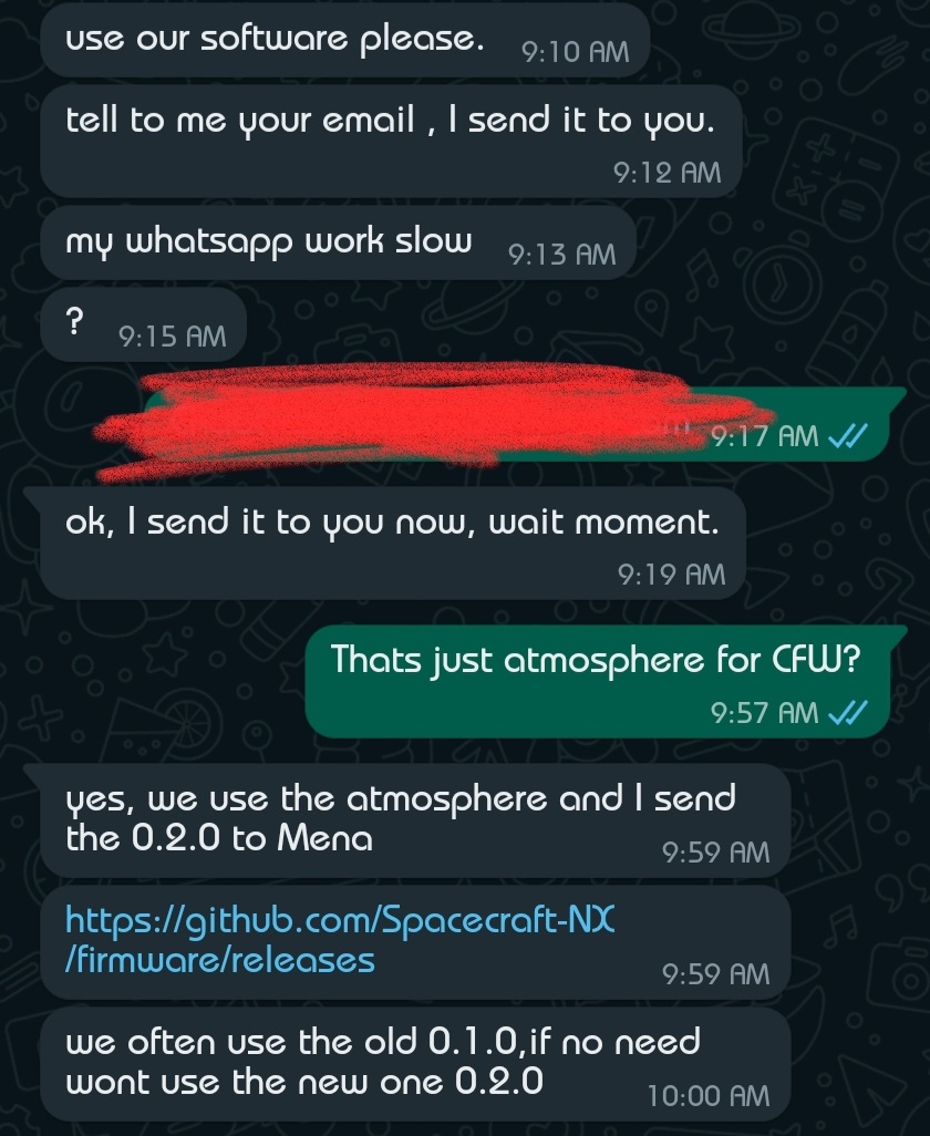

I would simply heed the warning by the actual hacker who managed to glitch his OLED on day one, who wrote the open-sourced microcontroller firmware that hwfly stole for their modchips, and who wrote the open-source payload that initializes the switch to the point where it can chainload into hekate. That payload was updated for OLED switches, because this same hacker identified dangers with the original payload that was purely intended to run on units with an LCD screen. This LCD screen requires different supply voltages than the OLED does, among which at least a +5V and -5V for the backlight circuitry. But there are more differences. And hwfly still uses the old version of this payload without warning anyone about its dangers.

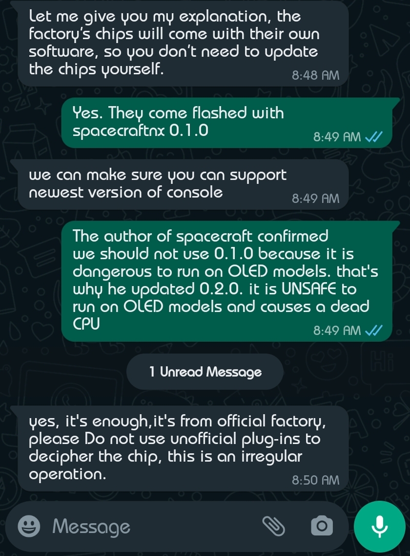

The hwfly lite clones are locked. Magnus Hydra attempted to update my chip from spacecraftnx 0.1.0 to 0.2.0 as he showed above and it failed. It comes like that from the factory....
Mena even explains here what spacecraftnx is doing. It WILL damage your OLED if you keep it in there. Ive seen others report that their switch has even bricked and they had to replace the mobo and chip to avoid the issue altogether.
