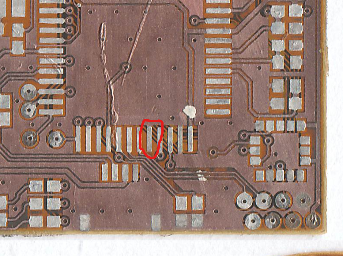

Can't watch the video, I was going to try connecting the ST Link programmer as usual and lifting pin 44 and applying 3.3V to it instead of ground, this should in theory change the boot order and not run the onboard code leaving SWD open so then in theory you can unlock the chip and program whatever you want.
The highlighted pin below

supposedly @doom95 has already tried this and it did not work for him. my method does involve changing boot order with boot0 pin but it uses another interface
woohoo I was half right lol!! Do I assume once you have done this the USB interface is back open and the chip can be flashed normally in the future as you have uncrippled the stupid sh*t the HWFly guys did to this in the first place by using the regular firmware?
Also hoping debug works on it as well!!

it requires fixing of option bytes. @doom95 can likely get it sorted or some other community member. I'm simply releasing the method and people can tweak and adapt it from there
