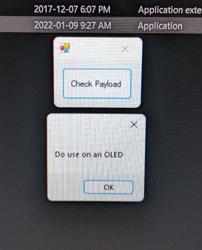

sean222
Sep 7, 2007
92
777
Paid $200 to see this message :rofl2:
Just installed my new OLED specific chip, came with SpaceCraft 2.0 obviously. Would be sad if it didn't.
