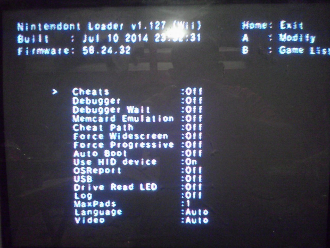

your first pick is so wierd its impossible to see what version you were using lol and nintendont is shows red for you? heck mine is white :P
I took the photos with my mobile phone, so yeah. Also, yeah Nintendont menu is red on my CRT (can't handle ntsc signal).
Anyway, Nintendont is r126 if you look closely. At least you can see that Batman IS working.

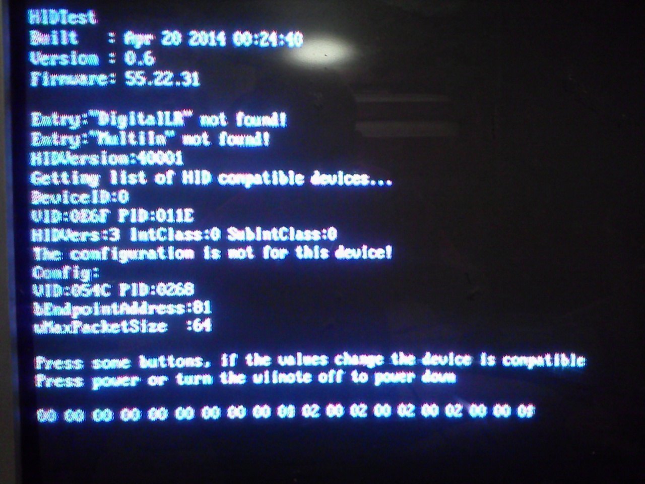

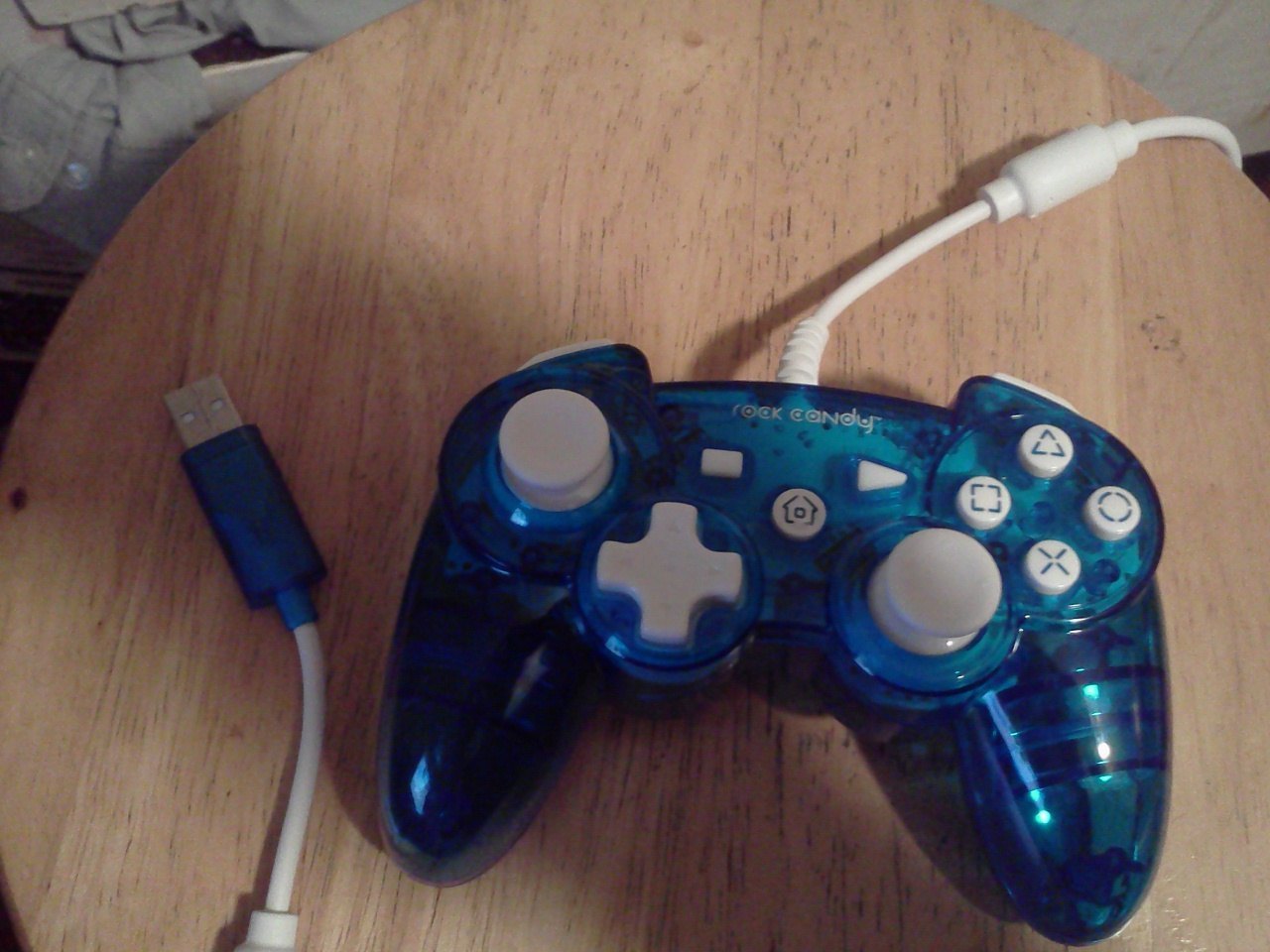

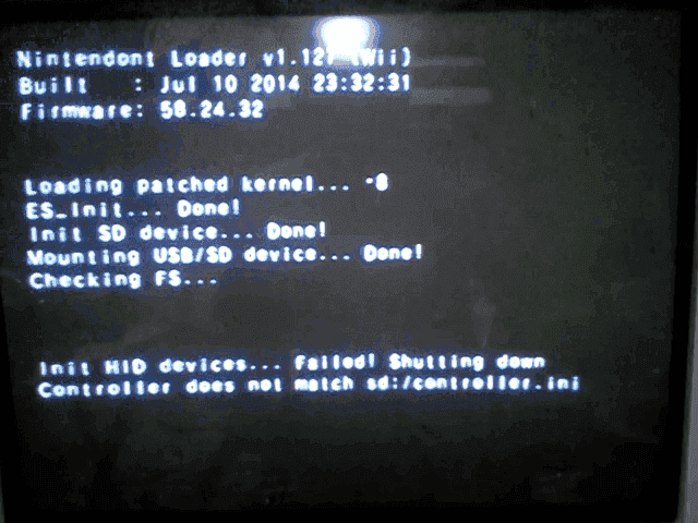

i am having a hard time configuring the .ini for the rock candy ps3 controller,has anyone already made one or has one that they may share?
i plug the controller in, then when i load it up in hid_6 , and the values are going haywire, and its saying no compatible ini detected, tried loading nintendont with controler ini available for ps3, and it errors then shuts down, i have one of the new black wiis, controller works fine with everything ive used it on
The ini should be in the root of the device where you have your apps folder to use it with HidTest. But it will say it's not compatible if the PID and VID don't match. Not sure what you mean they're going haywire, the values change even if you don't touch anything?
What problem do you have when making the ini? The steps are really simple once you understand the instructions
heres the controller im using, it's brand new straight out of the box and tested, and also a few pics of what im seeing on the wii
View attachment 8909View attachment 8910View attachment 8911View attachment 8912
The VID and PID of your controller are different, edit the controller.ini and change those to VID=0E6F and PID=011E. then check if the values that change when you press the button match the ones in the ini, as they might be wrong too. The values for most buttons are the Offset (the "pair" that changes when you press the button, you count them from left to right starting at 0) and the Value that's shown when you press it.
The AnalogR/AnalogL use only the Offset and the Sticks have an Offset for each axis.
