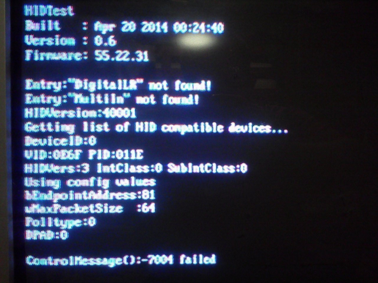

The VID and PID of your controller are different, edit the controller.ini and change those to VID=0E6F and PID=011E. then check if the values that change when you press the button match the ones in the ini, as they might be wrong too. The values for most buttons are the Offset (the "pair" that changes when you press the button, you count them from left to right starting at 0) and the Value that's shown when you press it.
The AnalogR/AnalogL use only the Offset and the Sticks have an Offset for each axis.
VID=054C and PID=0268, are what it already had in them;
[Dual Shock]
VID=054C
PID=0268
Polltype=0
DPAD=0
Power=2,01
A=3,80
B=3,40
X=3,20
Y=3,10
Z=3,08
L=3,01
R=3,02
S=2,08
Left=2,80
Down=2,40
Right=2,20
Up=2,10
StickX=6
StickY=7
CStickX=8
CStickY=9
LAnalog=12
RAnalog=13
when i tried switching them around to this it accepted, but when the game started i couldnt do anything with it,

-also, are the offset supossed to keep changing as i press the button, they eventually stop at "FF"

As you can see in the post you quoted, I had edited my post a bit after I posted to correct the VID and PID because I had mixed them up. you must have read it before then. I also told you to check if the values were correct precisely because being a different controller, it wouldn't work in-game just after changing the IDs.
If the values go from 00 to FF then that button is analog, that means they're "pressure sensitive". that usually only matters with L and R (that's why you have LAnalog and RAnalog to set the offsets that change like that. The same happens with the Sticks.
i went to check the values and this happened -
Try using the HID test without the controller.ini; take note of the values that change and the offsets and then make a new controller.ini
the main problem im having with this, is the pressure sensitivity you were describing before, i cant get an acurate offset because every button i press turns into either FF or a series of random numbers,
If each button (X, O, [], etc) changes ONLY ONE Offset and it's not shared, you can either try using only the offset position for it (not sure it'll work) or you can use the offset with an FF value to use the button only when it's fully pressed. I've never read about someone using that kind of controller with nintendont here so I can't accurately tell you how to configure it, but try what I said before. It might work.
