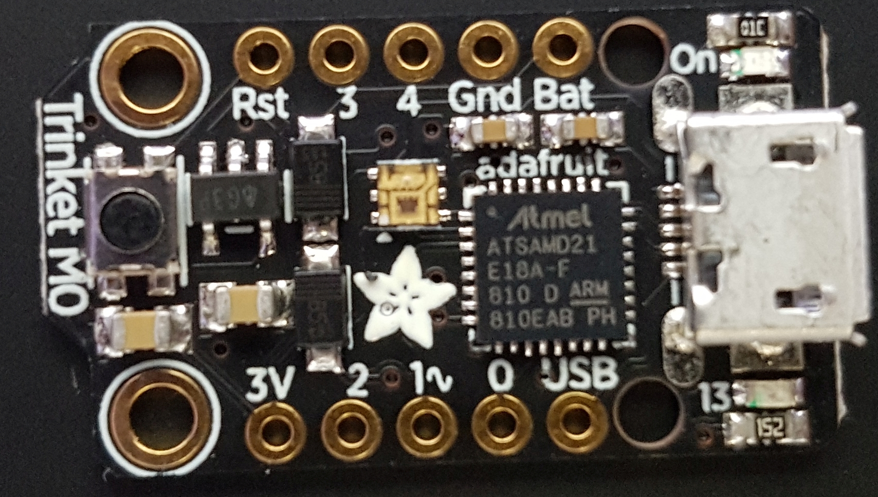

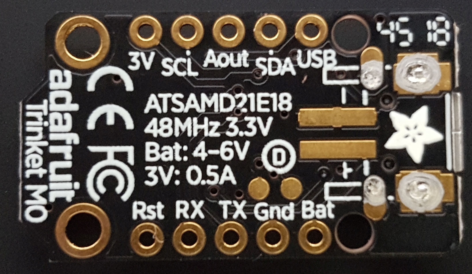

Got a new Trinket M0 chip.
When I copy the .UF2 files with 512KBs to the Trinketboot system it turns off. But when I plug it back into the PC no switchboot drive appears.
It always remains the TRINKETBOOT drive.
When I touch the board the USB disconnect tone sounds and the LEDs start flashing.
Fear that it is hardware defective. What do you think?

I've done it now. Thought I could switch to Part 2 but the post in front of me showed me the right way.
However, I find it very strange that my Trinket M0 separates when I touch it on the board.
View attachment 165684 View attachment 165685
Edit:
You have flashed wrong file. You are using method3 or legacy 3 file I guessing.
Touch pin 2 or 4... Guess it reboots the chip
Reactions: Moneyforthecash
