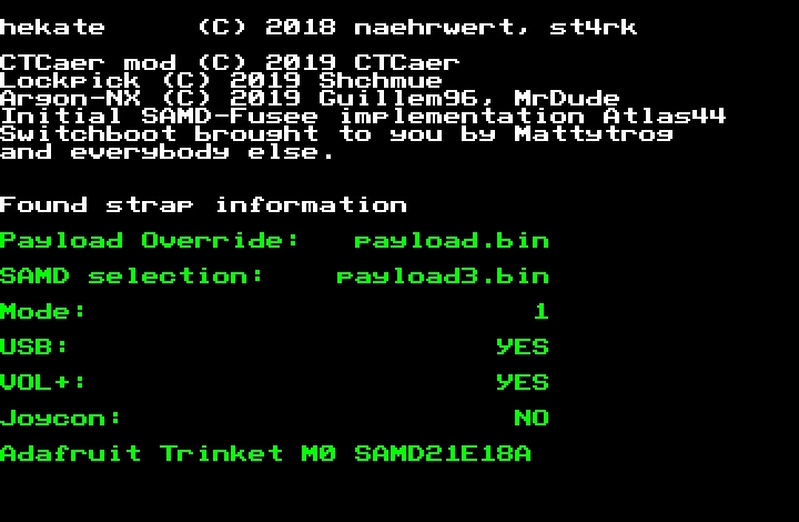

Making UF2s now... The new drill is...
Use Fusee-UF2 - it will create a file.
New Switchboot versions will be able to read this file and display chip info.
This way, you don`t need to update the fookin UF2 every time...
This is the new modchip info screen. Using a Fusee-UF2 "straps_info.txt" file.
Reactions: peteruk
