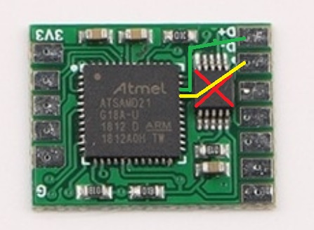

Here we are. If someone wants to ty this...
Remove USB logic chip (red cross)
Join new wires to green and yellow points.
See if it fixes RCMX86 issues?
Reactions: FR0ZN

It's the usb logic chip that's doing it. Notice how rcmx86 inject slower than a rebug or trinket
Finally I think I found the RCMX86 usb problem, at least in my case.
I think it was the magnetic reed that was close to the switch fan and its magnet and was causing problems with GND.
I moved it a little bit down and it's working properly, no more problems with usb.
Fantastic. The coils in the fan probably cause problems. Leading to partial current flow to the SAMD reset controller. That never occurred to me. I don`t use reed switches... I fit a "trinket" SMD one
