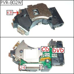

As you described,your PlayStations Laser is "maybe" at his end...
You can now try to change the Laser of the Drive and hope it works.
There are three types of Lasers:
PVR−802W
KHM−430
SPU−3170
To get sure which one is the right you have open your PlayStation and take a look at it:
As you see they have two screws for CD and DVD to adjust the Laser.
This is another option you can try,but please Note:
- MARK the starting position (to get back is you turn the screw to much)
- LITTLE steps/turns,not even a millimeter each try.
Maybe a little "turn" is enough and your Laser works for now (Please also note that the laser will not last forever).
