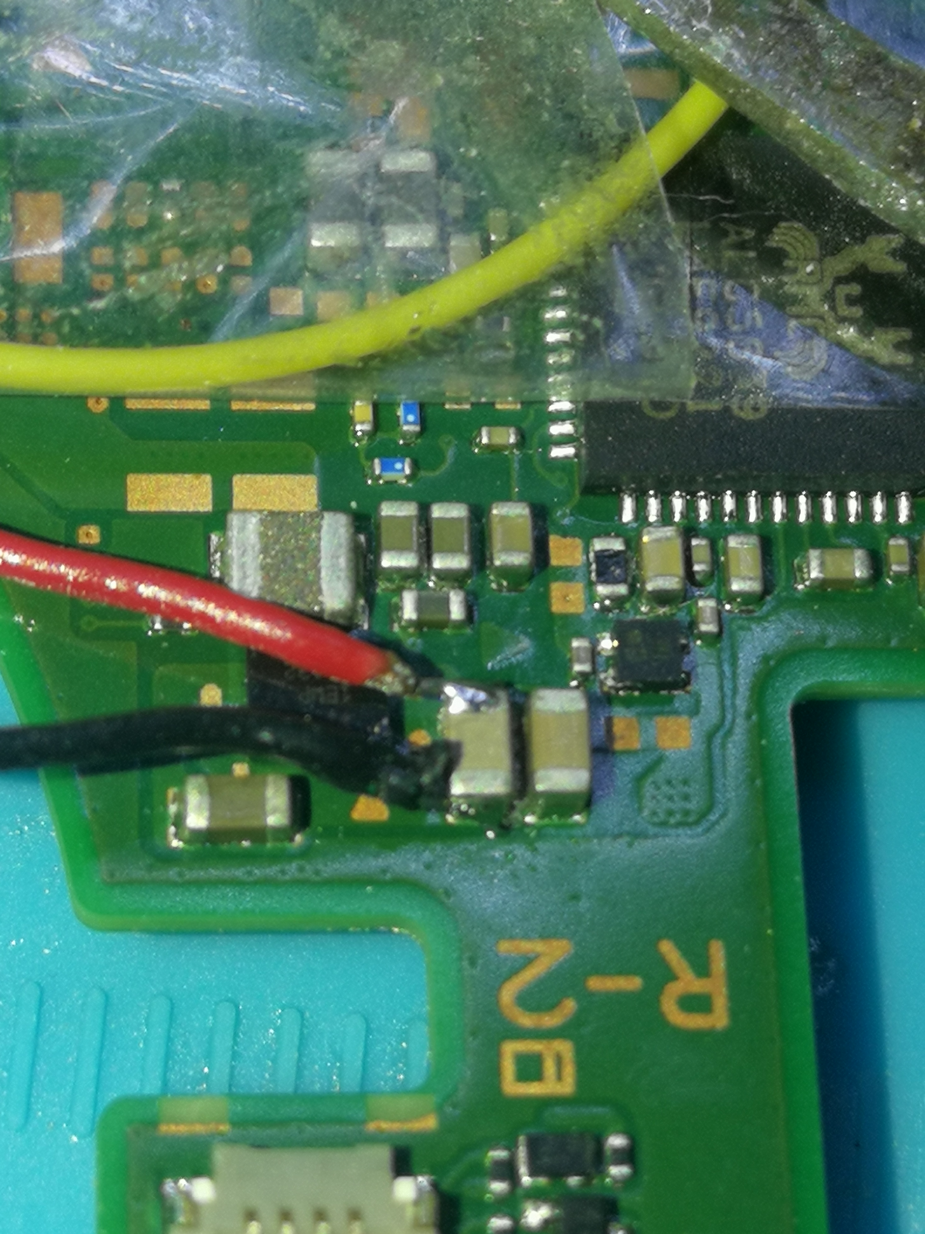

In terms of your readings I always want me readings between 0.5 to 0.9. That would be on DAT0, CMD, and CLK. According to your flex cable that would be points A, C, and D.
Make sure that you are using flux. It will help your solder flow and make a much cleaner install.
Post install. Check for shorts. Is the pico flashing an error? Also, check the lcd fpc connector. Make sure you didn’t bend any pins reinstalling the cable.
Thank you for replay... Yes all 3 oled console working fine after remove all things i well post my install pic.. Let me teake pic of all job. And reading value.
Dat0 adapter reading 0.696 v
Cmd 0.464 v
3v3 0.884 V
Rst 1.3 v
MOSFE cpu read 0.201 v
Gnd 0
Clk 0.714 v

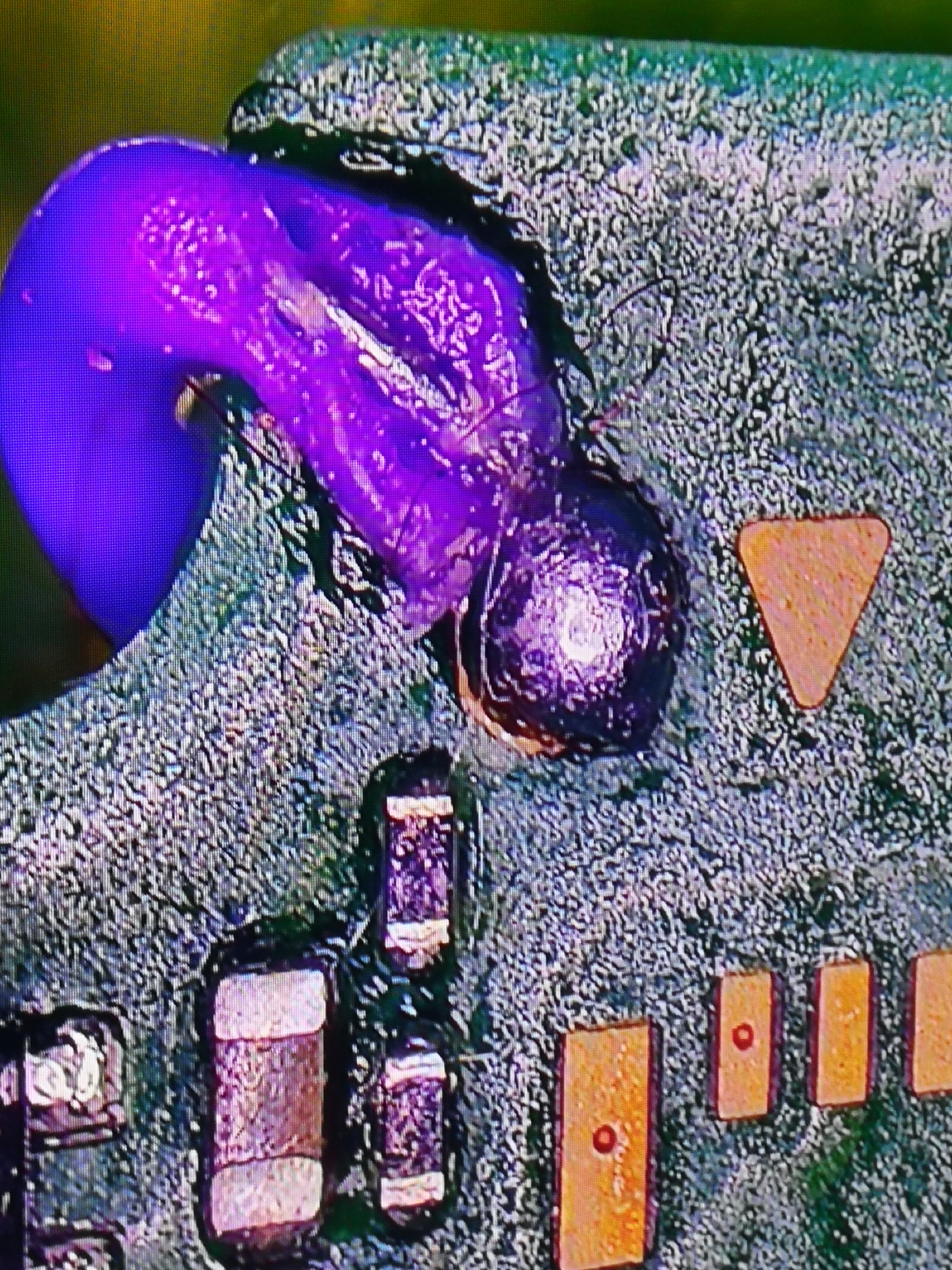

The adapter not soldring yet for more info is it good pic with 2k camera and use boom rf4 microscope.

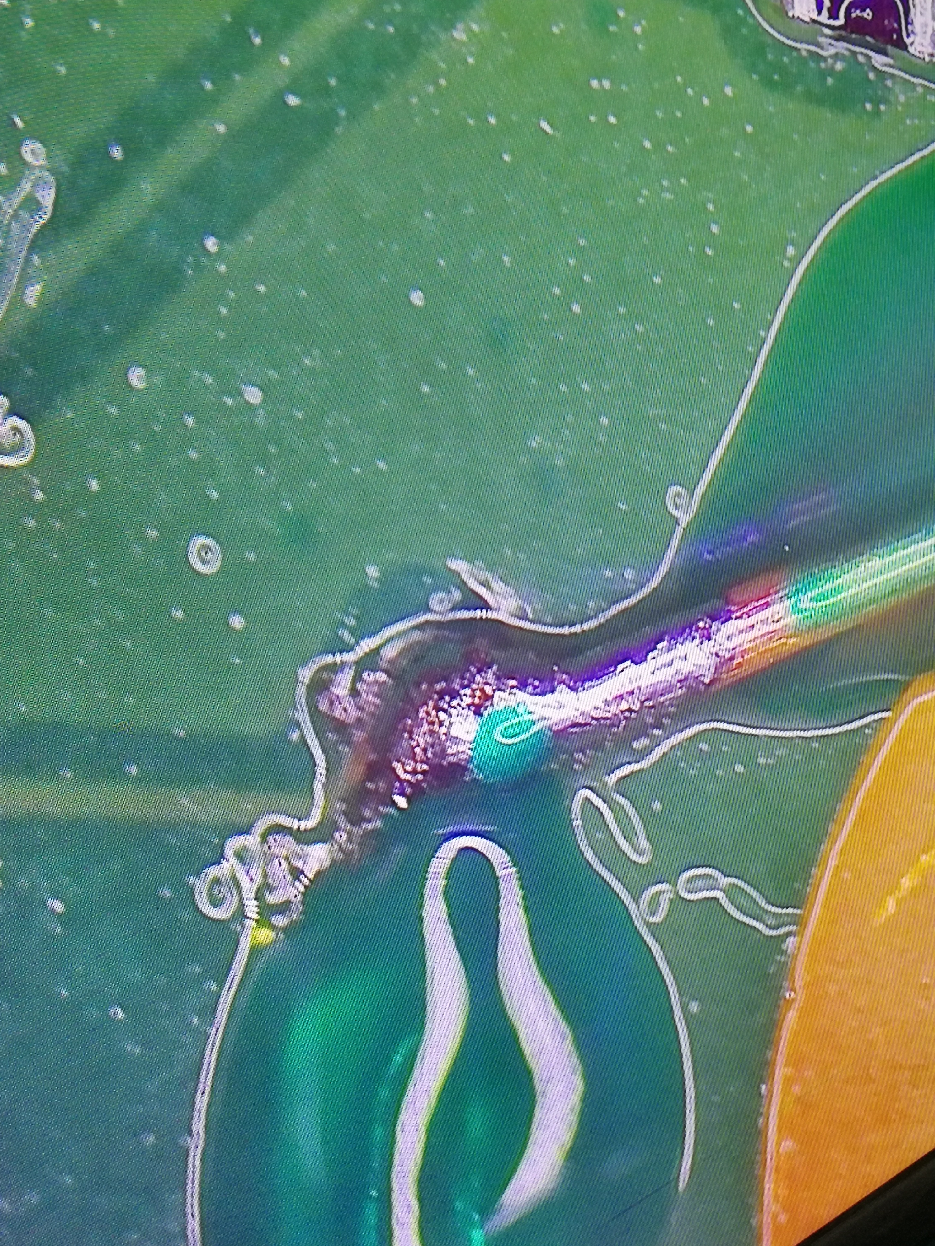

The green mask to keep magnate wier way from Gnd. I use other wier in pic on Clk but size worry me on Clk so i change it to 0.02 mm

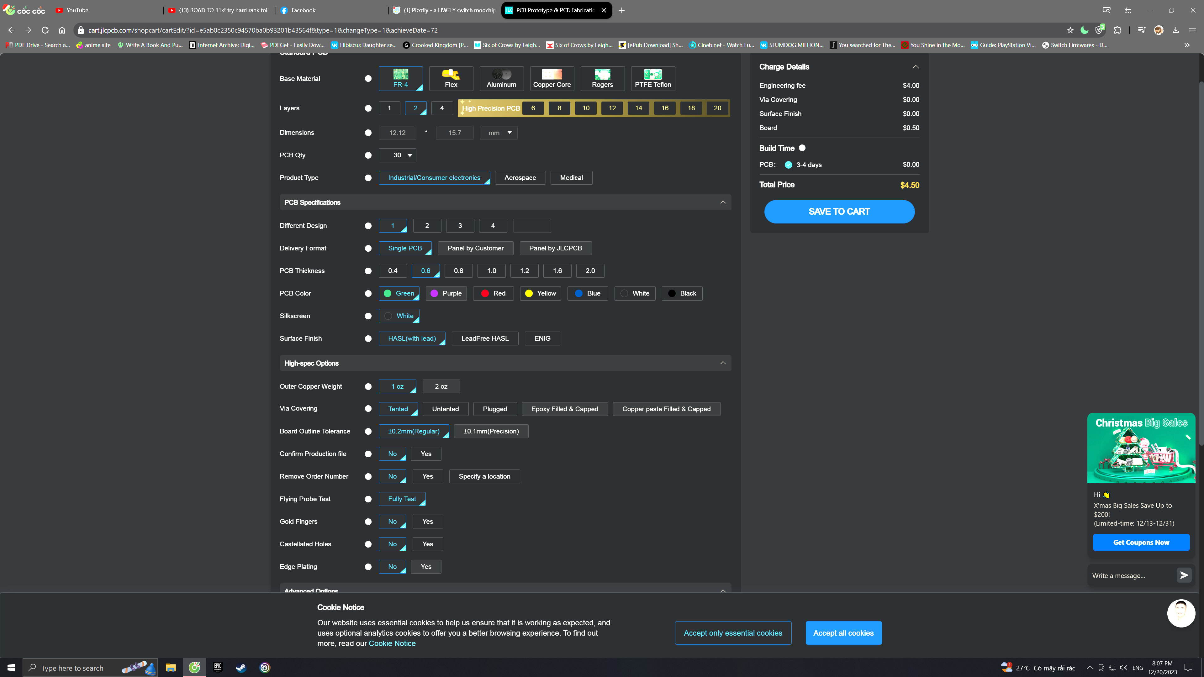

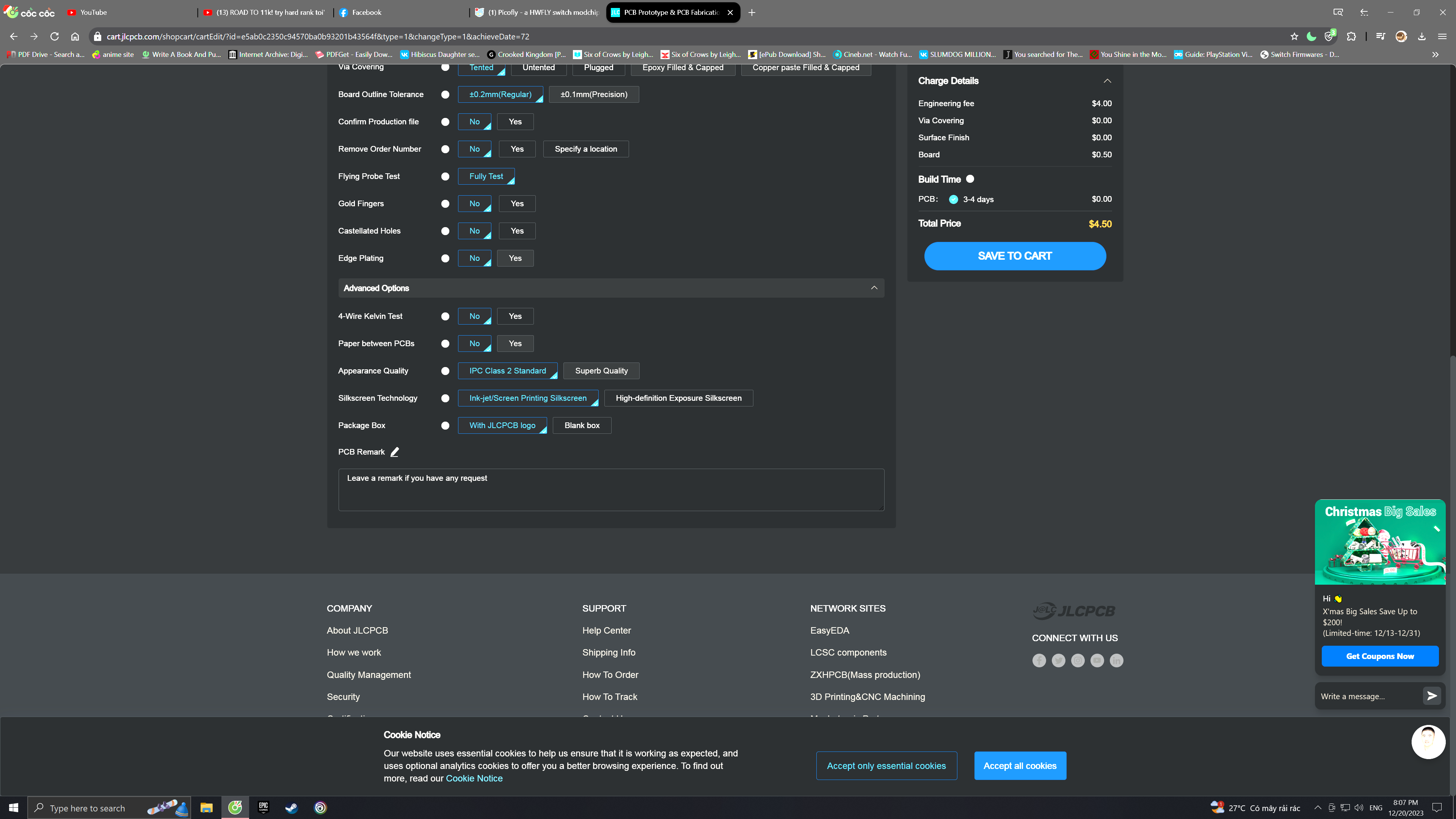

thickness should be 0.6mm, otherwise it won't fit under the emmc cover
hello friend. do i need to change anything aside from thickness? thank in advance

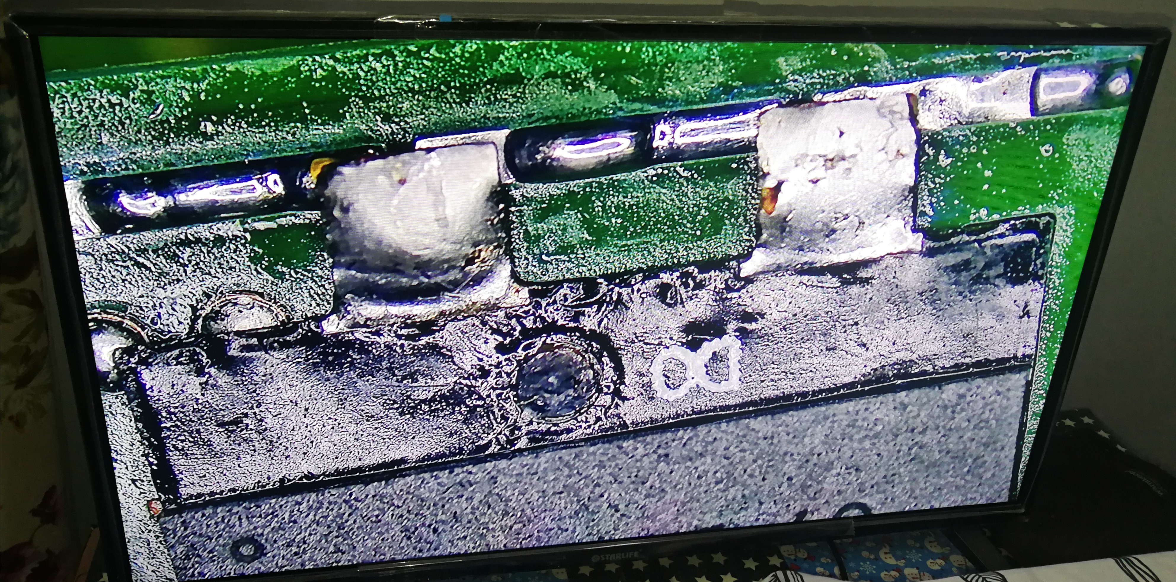

The green mask to keep magnate wier way from Gnd. I use other wier in pic on Clk but size worry me on Clk so i change it to 0.02 mmView attachment 409665View attachment 409666View attachment 409669View attachment 409673
Good job! Make sure to give everything a good cleaning with some IPA (alcohol)
