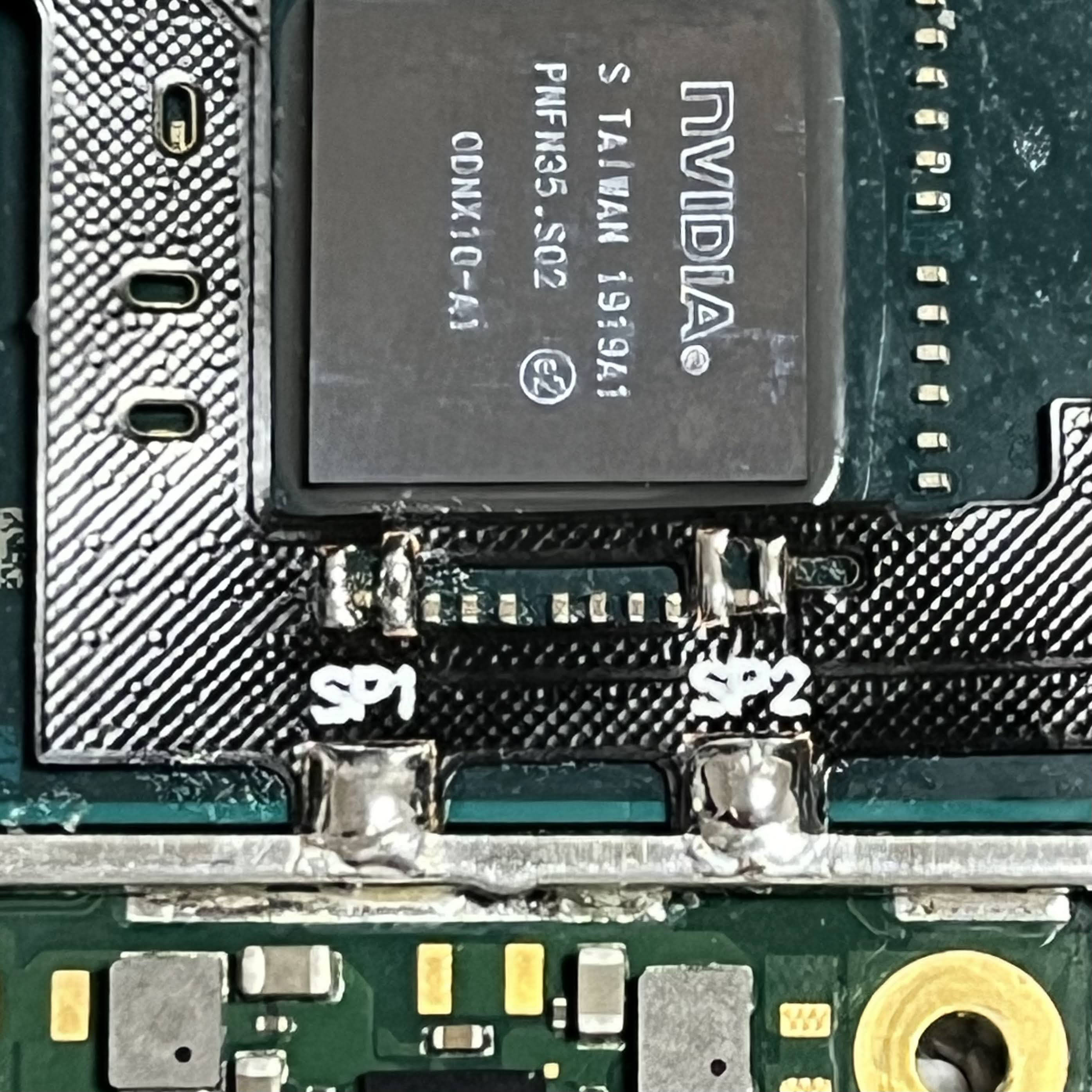

Last week I managed to install the picofly on my Switch Oled (well, it's working, even though I killed the SP2 capacitor), however during assembly I noticed that the measurement for the 3.3v point was approximately 1.05 instead of the range of 0.5~0.8, even though the chip was receiving 3.3v normally and it worked, I ended up leaving it alone, but I had it in my head and today I took the flat out to take a look and apparently everything is normal, even so the measurement is 1.05. The Switch is working normally. I ended up ordering the SP2 capacitor from Aliexpress and I can try to fix both at the same time.... does anyone know what it could be? Is it okay to leave it like this?

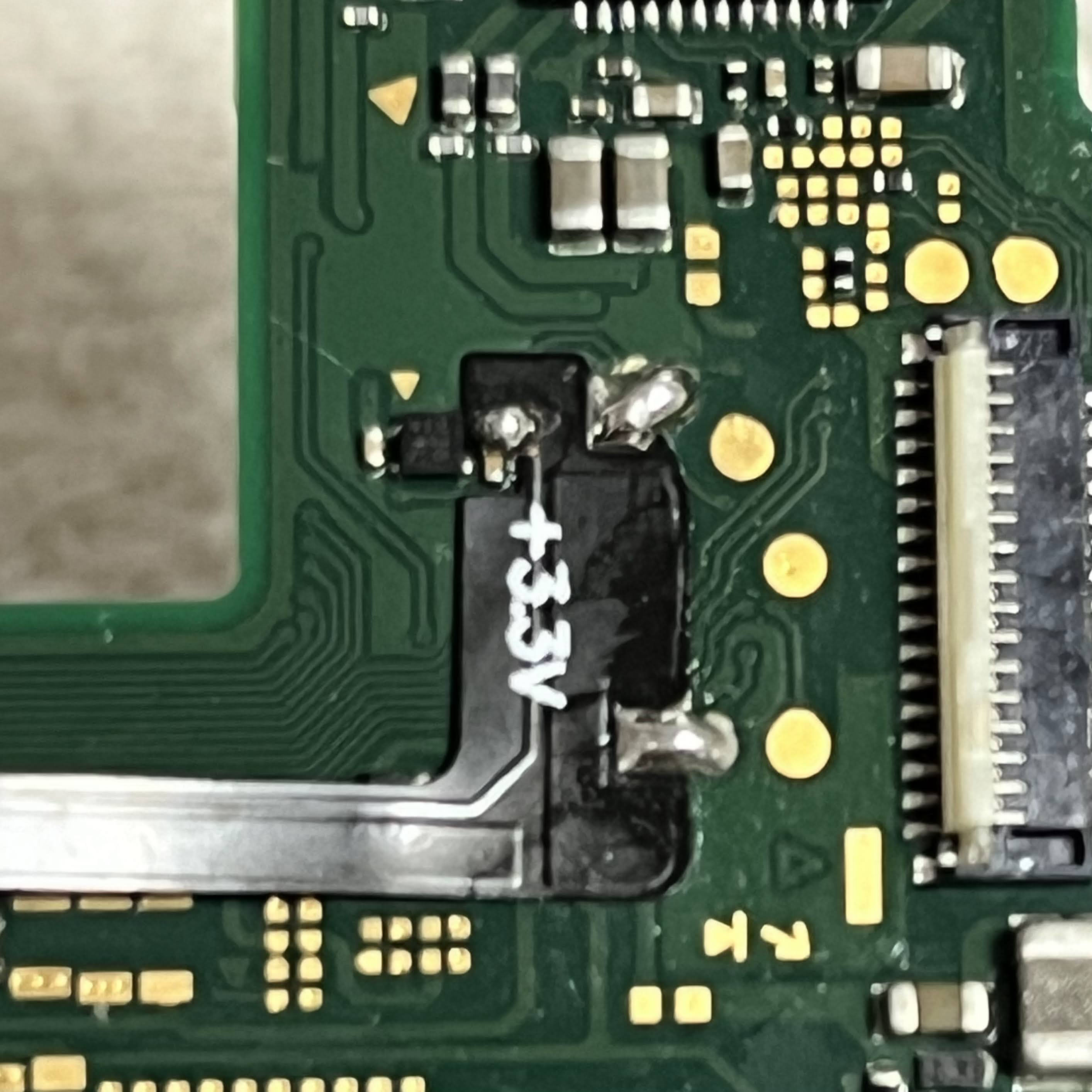

Not a problem to leave them like this, it's common ground and common +3.3V on those caps.

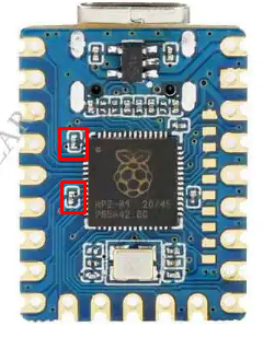

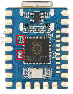

Regaring the SP1/2 cap, as suggested by rehius, you can source them directly from your Rpi if you use RP2040-Zero baord for example:
Once I left it without the SP1 cap, the console works well. Since it's a filtering cap and you want to keep it OEM for a peace of mind, replace it.
Thanks for the answer! I used a picofly v5 from Aliexpress, so I can't steal the board cap. Maybe I expressed myself badly in relation to the 3.3v point, my doubt is not in relation to ground and common to those points, I know that they are in parallel on the PCB itself, what I would like to know is about the measurement with the multimeter on the diode scale showing 1.05 instead of the 0.5~0.8 that the tutorials indicate, I want to know if there is a problem with the board or any other component due to this "strange" measurement. In addition, as far as I remember, the 3.3v was the second point I made (the first was dat0), which is why at the time I didn't pay much attention to this strange measurement, as I hadn't yet reached the complicated points.
Are you connecting the red probe of your multimeter to the ground while in diode mode? If not, that's why you have "different" readout.

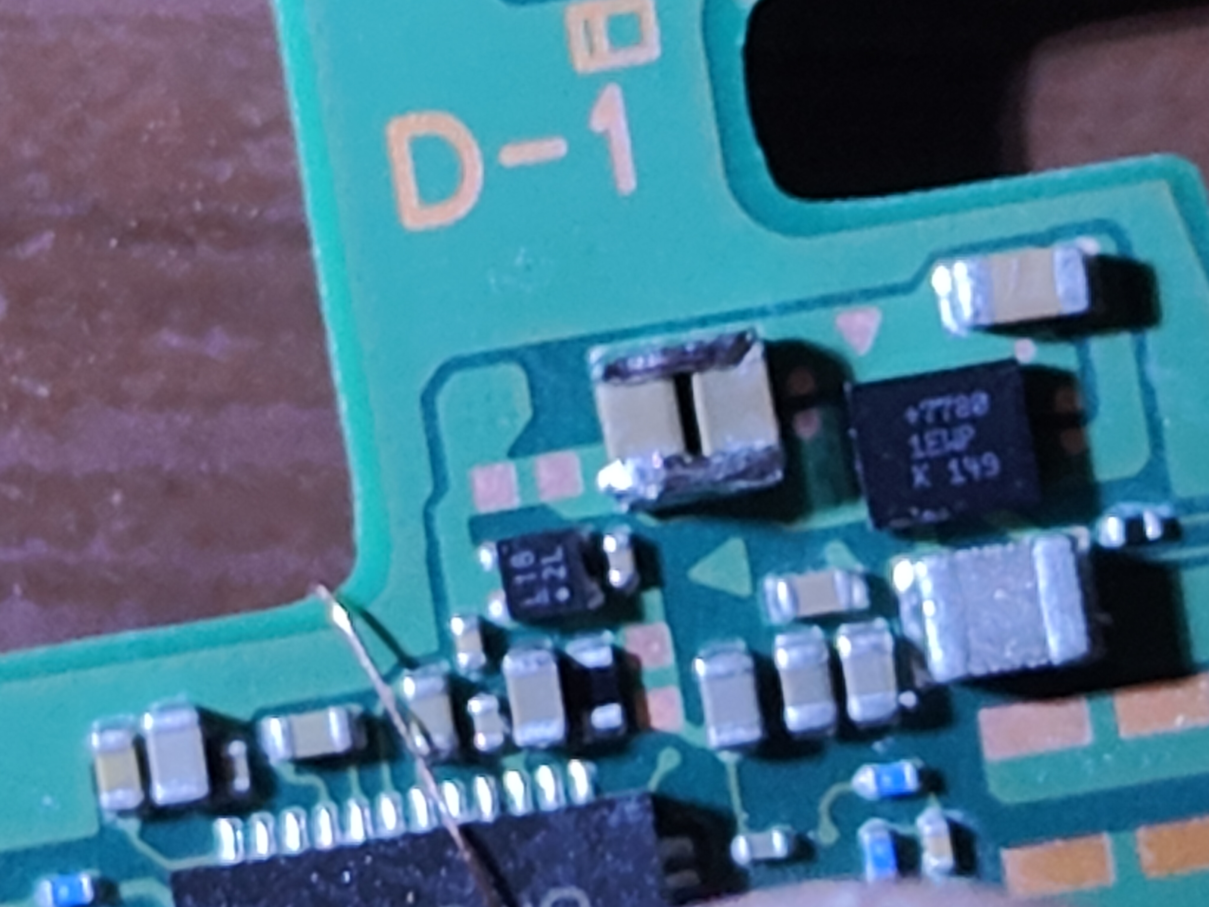

Post your work. Are you sure your DAT0 is connected to the right spot? On the lite they’re kind of all close to other points.
thank you for your reply. :)
The solder on DAD0 doesn't look good, but I've corrected it nearly 7 times so far, and all of them were "=* D0 is not connected". I have never seen the picofly boot screen (no sd).
I will leave a photo of the area I worked on. It's the x5 zoom on my smartphone because I don't have a digital microscope. I apologize in advance.

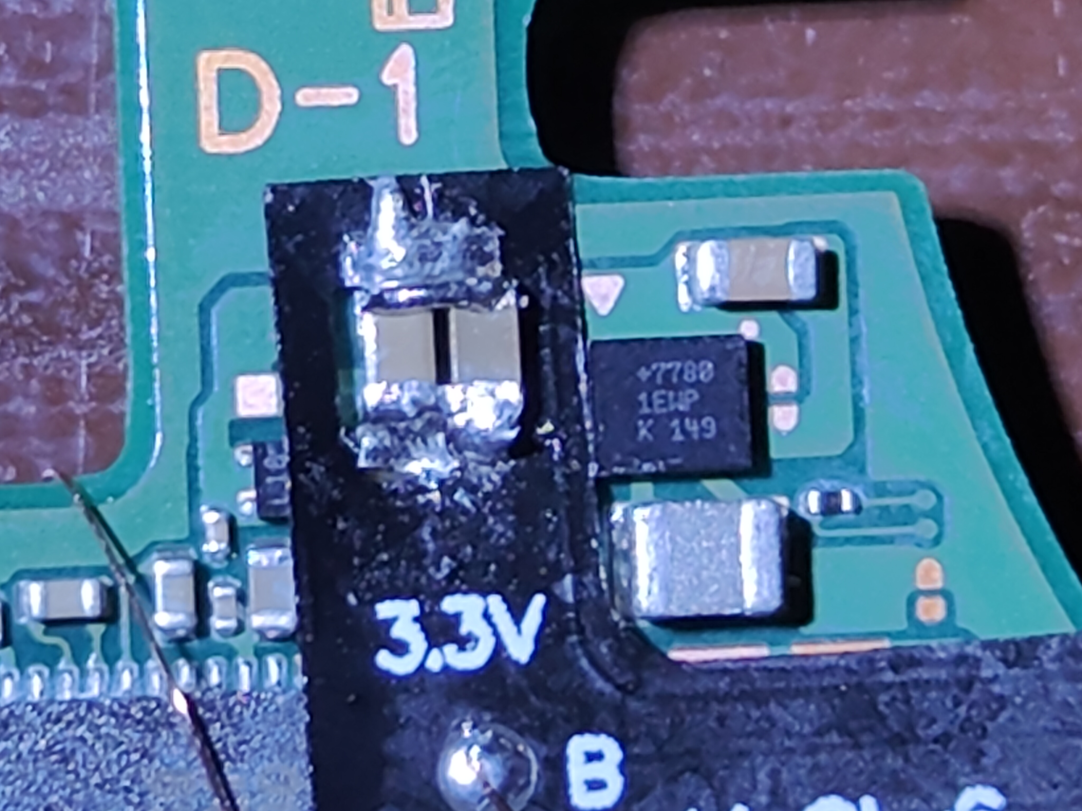

No wonder you dont see the picofly boot screen.
First off is that your flex on the cpu is not seated correct.
So it is hard to tell if you even have made contact with the correct points and not bridged anything.
I dont see the cap to the right of sp2, is it missing?
And your solder looks terrible, no flux?
And it seems like you dont have contact with all points and possible bridge under flex.
For the rest of the flex cables i cant tell because i have not done a lite.
But it seems you have bridged stuff there also.
Does the switch even boot?
I would say that you dont have the skills to peforme a mod like this and you risk fucking it up even further by attempting to fix it by yourself.
Better leave it to a pro and have it fixed.

ah. . Thank you for your important advice. I think everything you say is correct.
Fortunately, my Switch Lite seems to be booting and alive in OFW.
It seems that I installed the CPU flexible cable (FPC) in the wrong position. I placed it too high. The chip next to SP2 is present, but it appears to be hidden because the FPC window is located higher up.
Do you think it is possible to safely remove and reuse these FPCs? Or should I reorder.
I cleaned all the flux to take this photo. Paste flux is usually used. Thank you from the bottom of my heart.

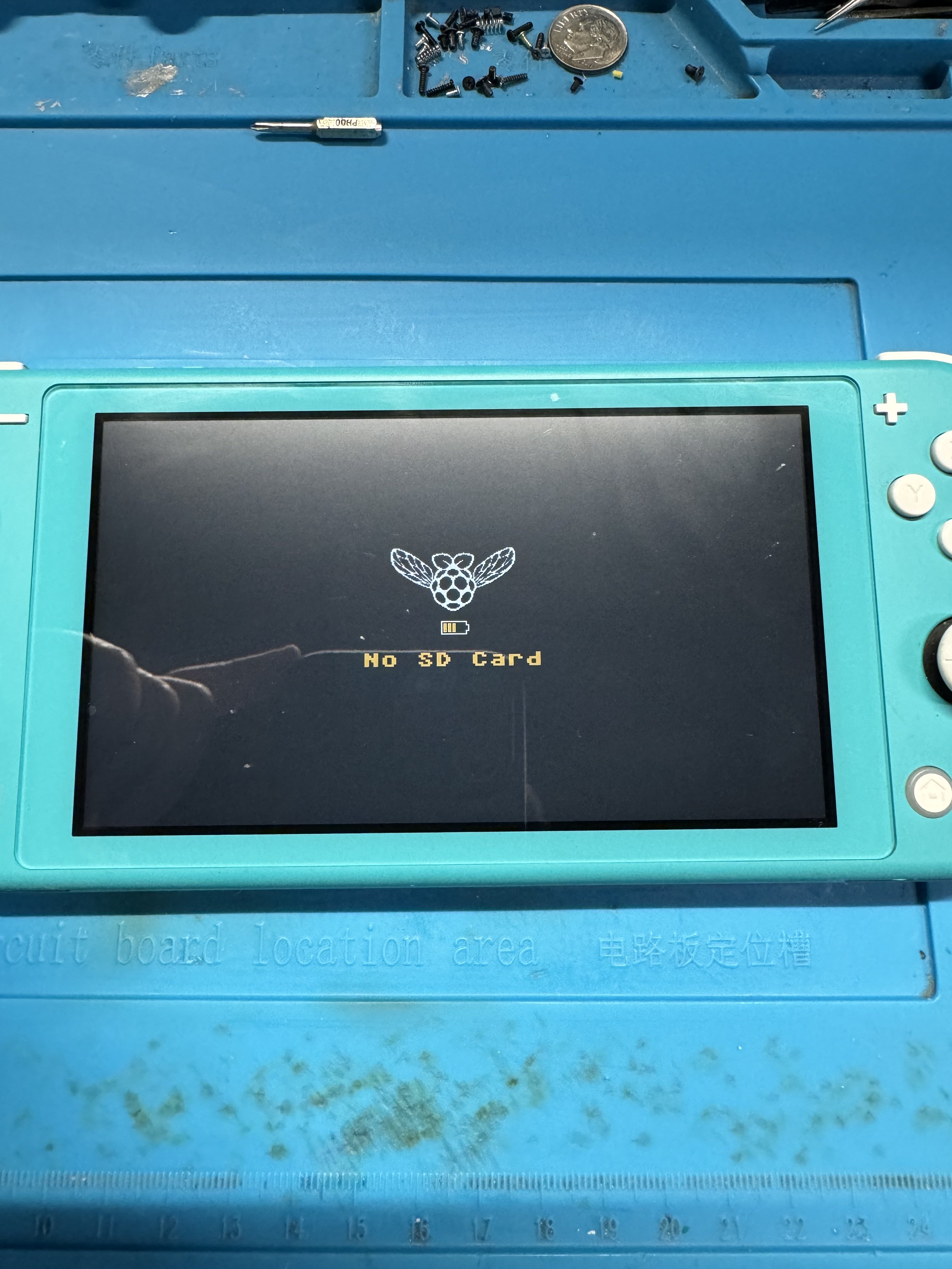

have an hwfly in my oled. it worked till yesterday fine, but now suddently it says no sd if i wanna boot it. i have an sd in it, formatted with fat32 and tested it of errors but it doesnt have any and its a genuine 1tb sandisk ultra. it was at 20 percent battery before i went sleep. could this be the prob?
Boot ofw and see if it sees the SD card. Else your sd carder reader probably have died.
still get no sd error
got it
booted to the modchip menu and it booted hekate now it works
created a new emummc and put back my files (ok installet games are gone but idc)
