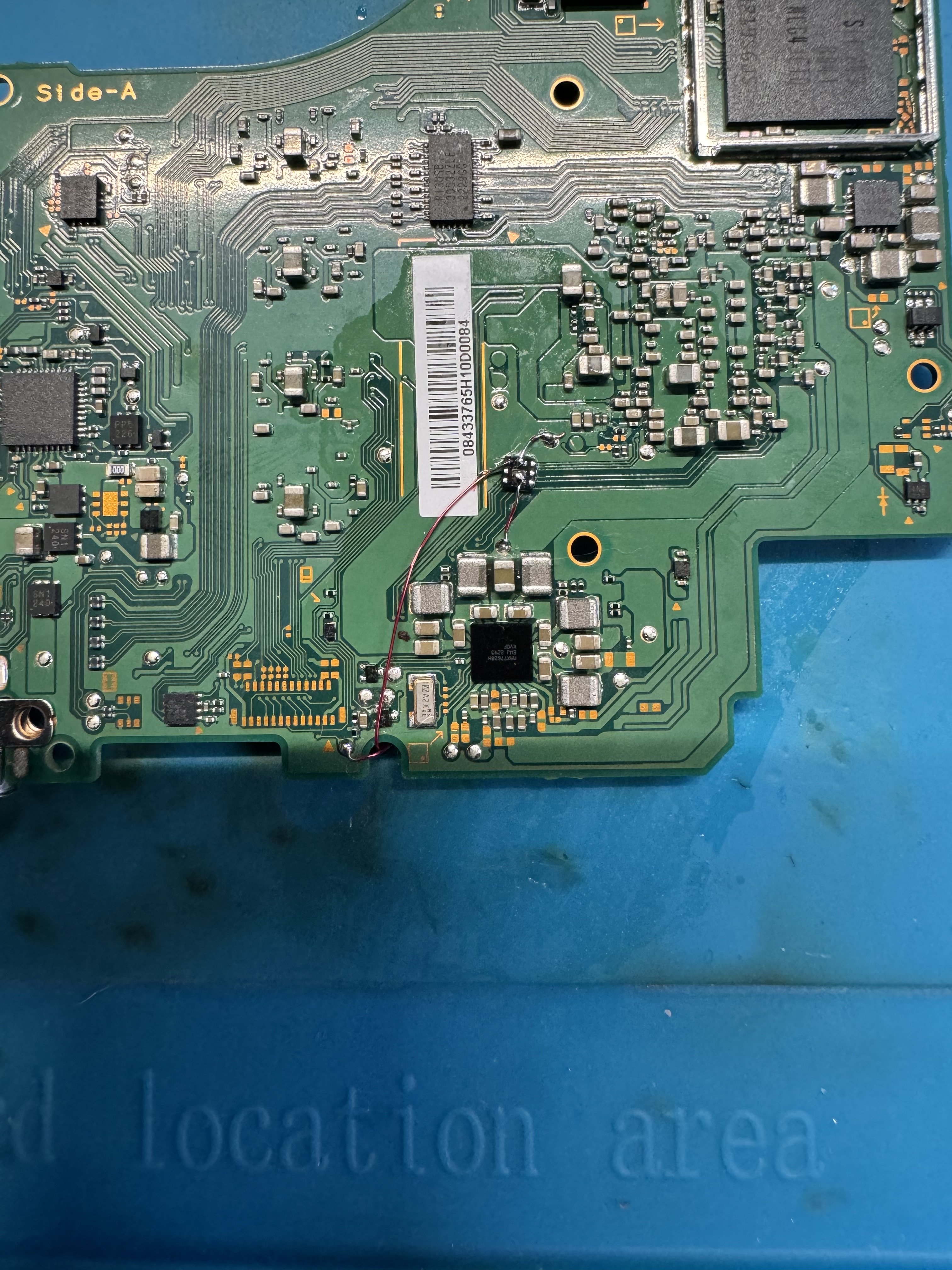

Aaaaaand a first successful rear single mosfet install on an OLED. 🙌🏼
Glad for your successful. Back mosfet is more easier than in the front because we have more space to work.
