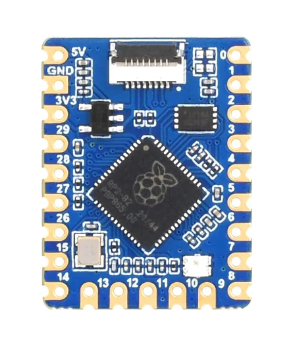

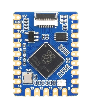

How did you manage to program it? It looks like those dudes had few extra ones after dinner and soldered 180° inverted flex port. This what it should look like
Just buy original directly from Waveshare, at least you'll get what you pay for.

Can you take a photo of the back as well? Original ones have waveshare logo in it with rev1.1
Another thing also is if you can check the 3 resistors in it make sure its 47ohm not 470 or 4700
