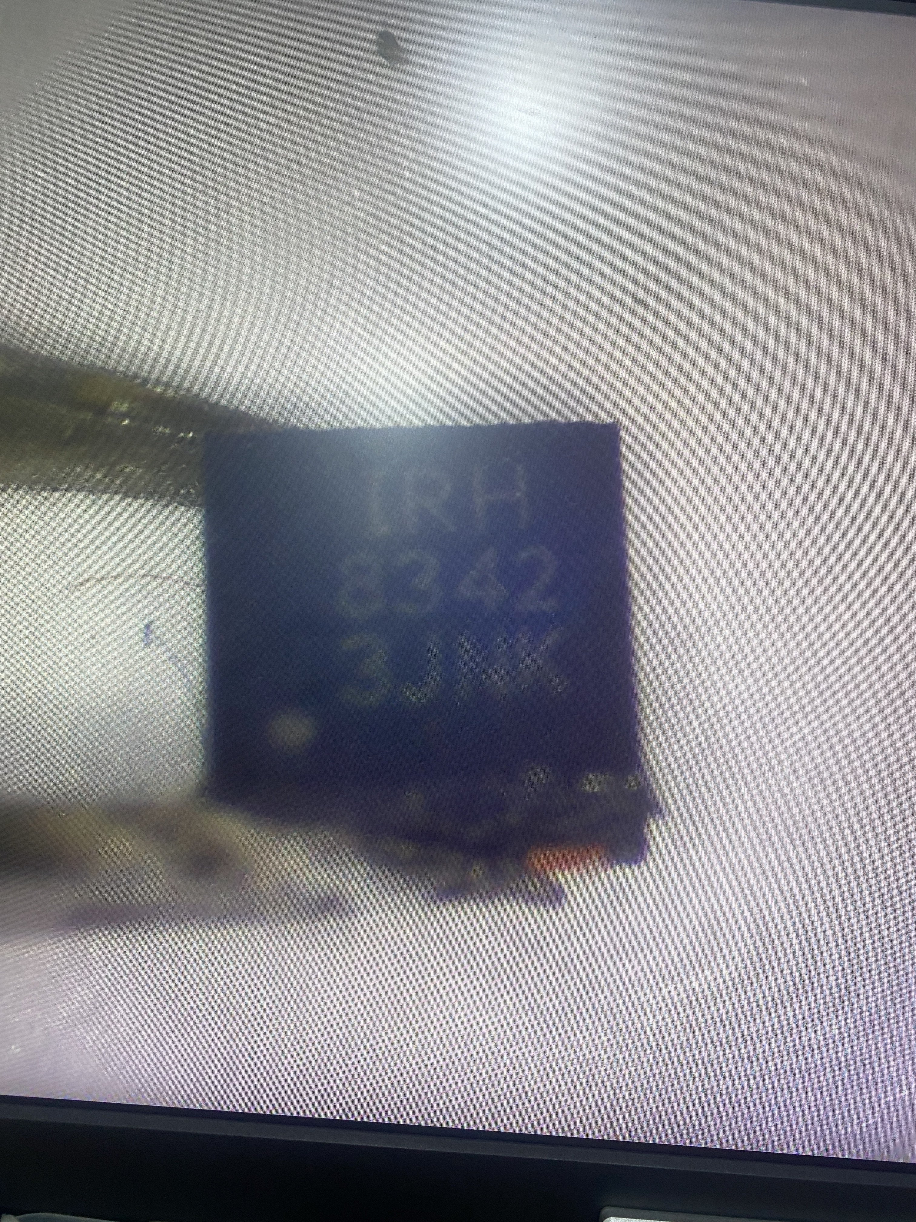

Its happen to me today 😭
Ordered 10pcs mosfet irh8342 from my local shop
And none of it working
I ussually use aon6414a and its working fine
I just concern about the size, thats why i try my luck use irh8342
I try single mosfet and double mosfet and its not working
When i try to switch to aon6414a its working fine
Im really sure this mosfet is defect or something
