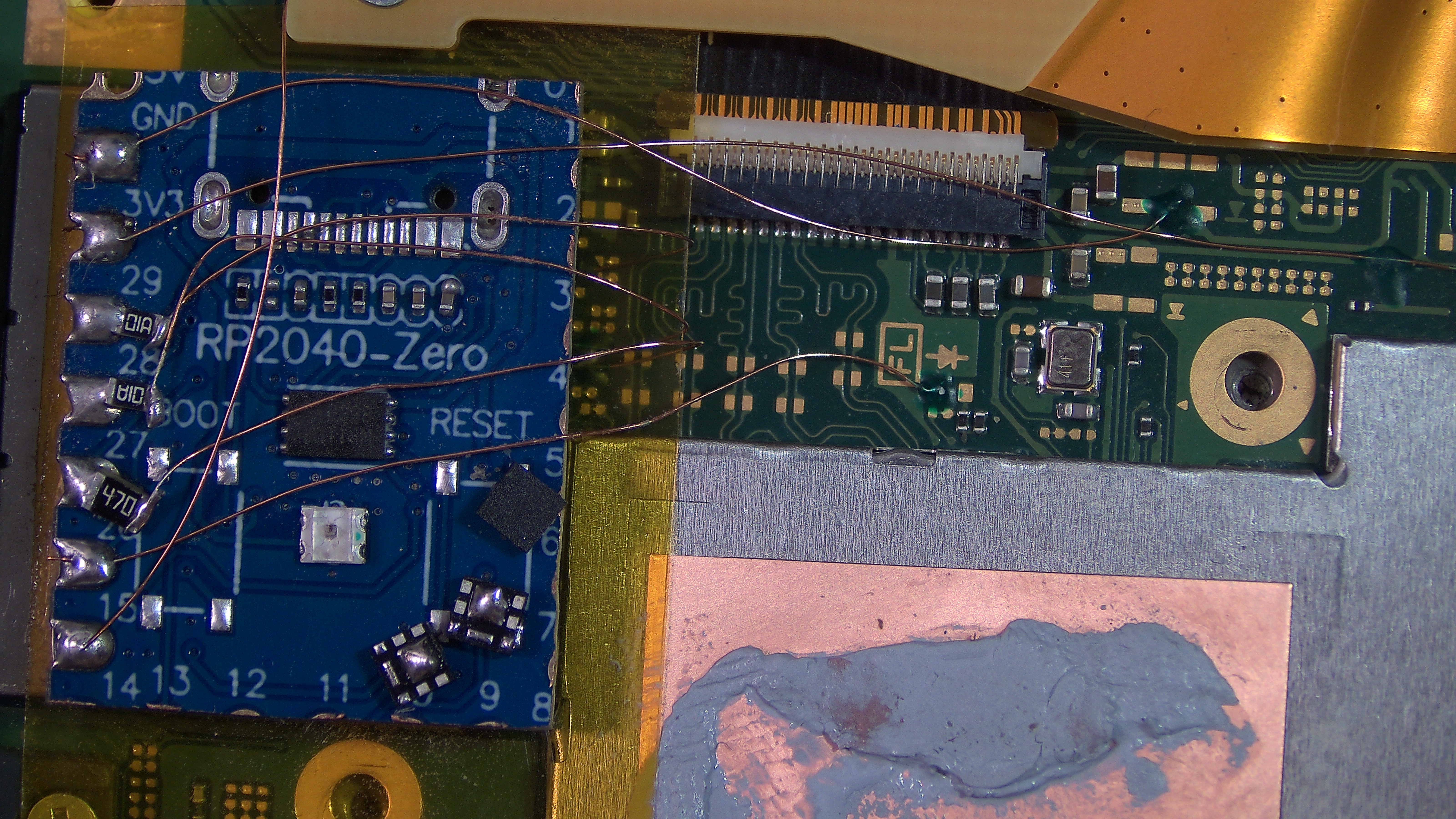

I'm having a strange issue- the glitch consistently works with the apu shield up, and consistently doesn't with the apu shield down. Any clue what could be happening? (I've attached some pictures of the install, those are the best I can get without desoldering connections.

It’s not obvious to you when you look at your own pictures?
Holy cow what a mess….. clean everything up and redo the paste. Look for some guides how much to apply and to where, and where not to have cooling paste.
Every time I've opened one up, it's looked like that so I just wanted to leave it like I found it. I can clean up the paste but I'm almost certain it's non-conductive and if that was the problem, I would think it wouldn't work at all.
Is it a guinea worm? is it a spider's nest? is it cordyceps? I'm traumatized
...to be a bit more constructive, you've stripped the insulation off of your wires in several places, and whenever you close the shield it will connect with the uninsulated wire parts and short your mosfet wires to ground.
