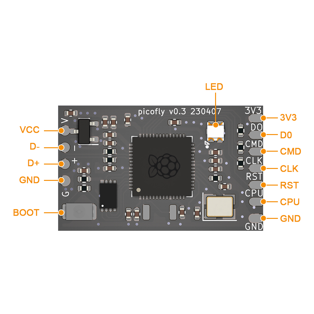

for the one millionth time in this thread, this is because you should be using 100 ohm instead of 47 ohm for dat0+cmd. So for the rp2040-tiny, you need to either replace the on-board 47 ohm resistors with 100 ohm variants, or add another 47 ohm resistor each on the dat0+cmd points

Does anyone know if there is another cmd pad on switch OLED??

As for your cmd alternative point. Unfortunately the only alternative you can access is under the emmc.

He means the resistance next to it and that is 47k
So here we go, the proof again:
Thanks for the help again, everything worked fine, found the 47k resistor on an old Chinese phone board.
First I've replaced it with 75k, since I couldn't find 47k, glitching with pico and hekate worked fine, but booting into ofw, I was having purple screen 🤷🏽‍♂️
